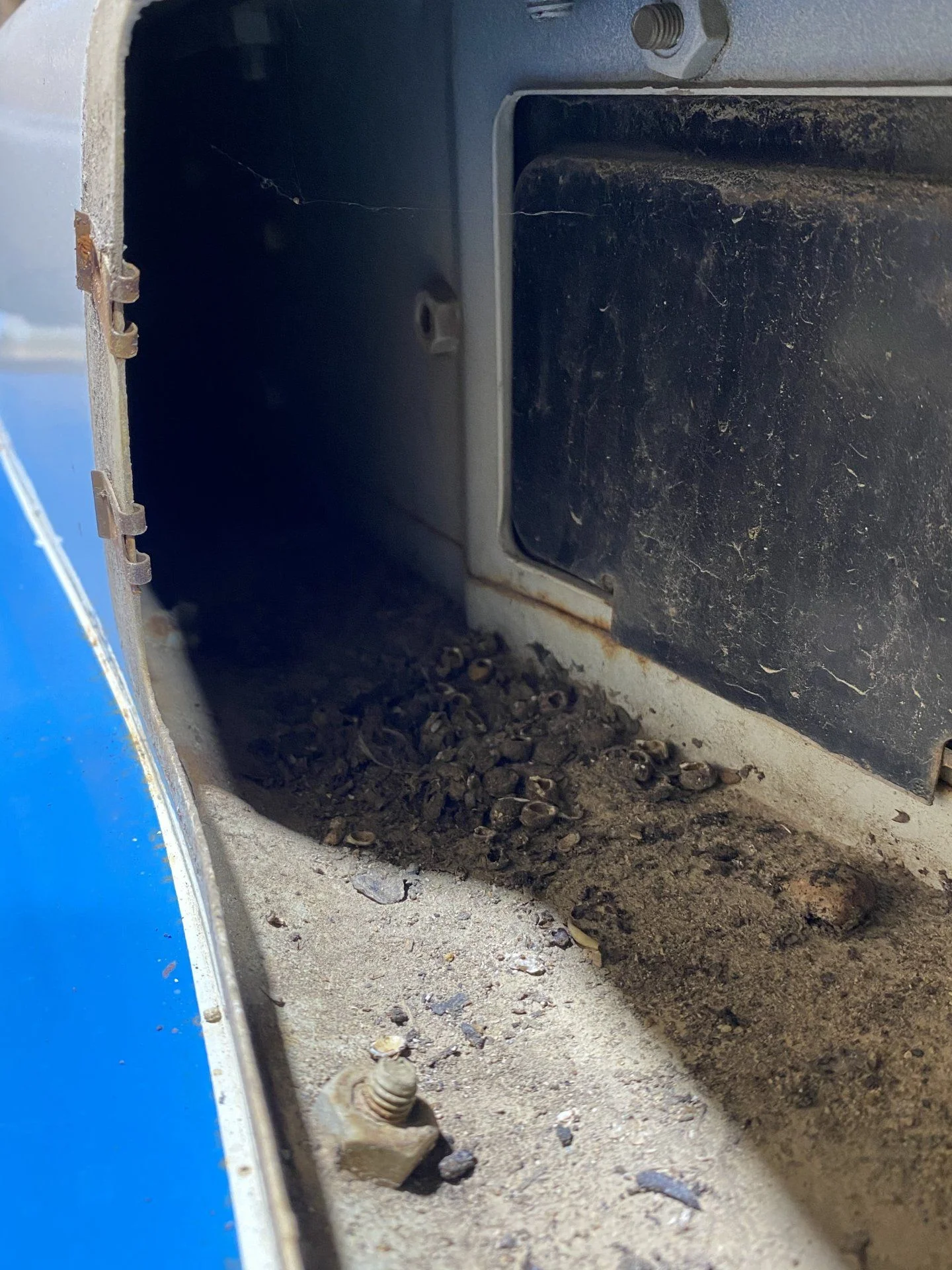

I had to clean all the rat s*** out of the vent areas and scrub them with Zepp. True farm life. No more bodies though.

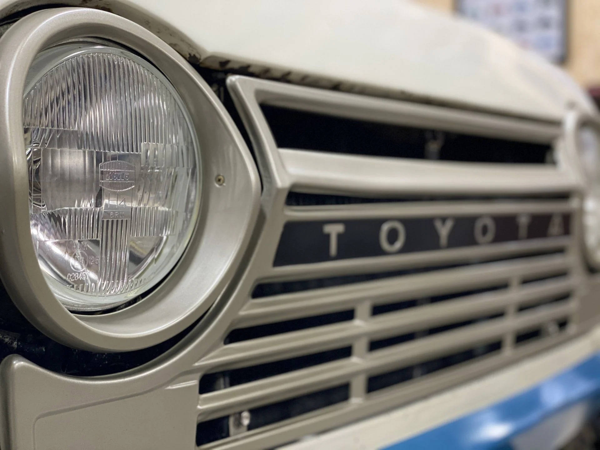

Lastly I stuck the Koito H4s home

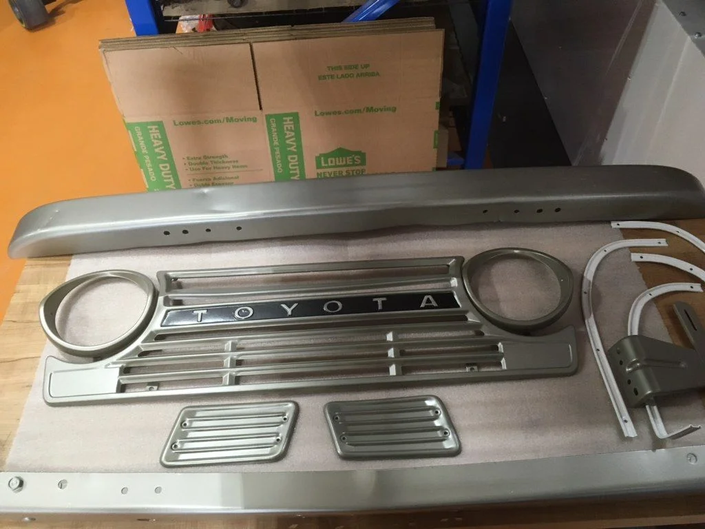

The two part powder on the grill is a really nice touch that powder keg did for us. Lots of work but its beautiful that way.

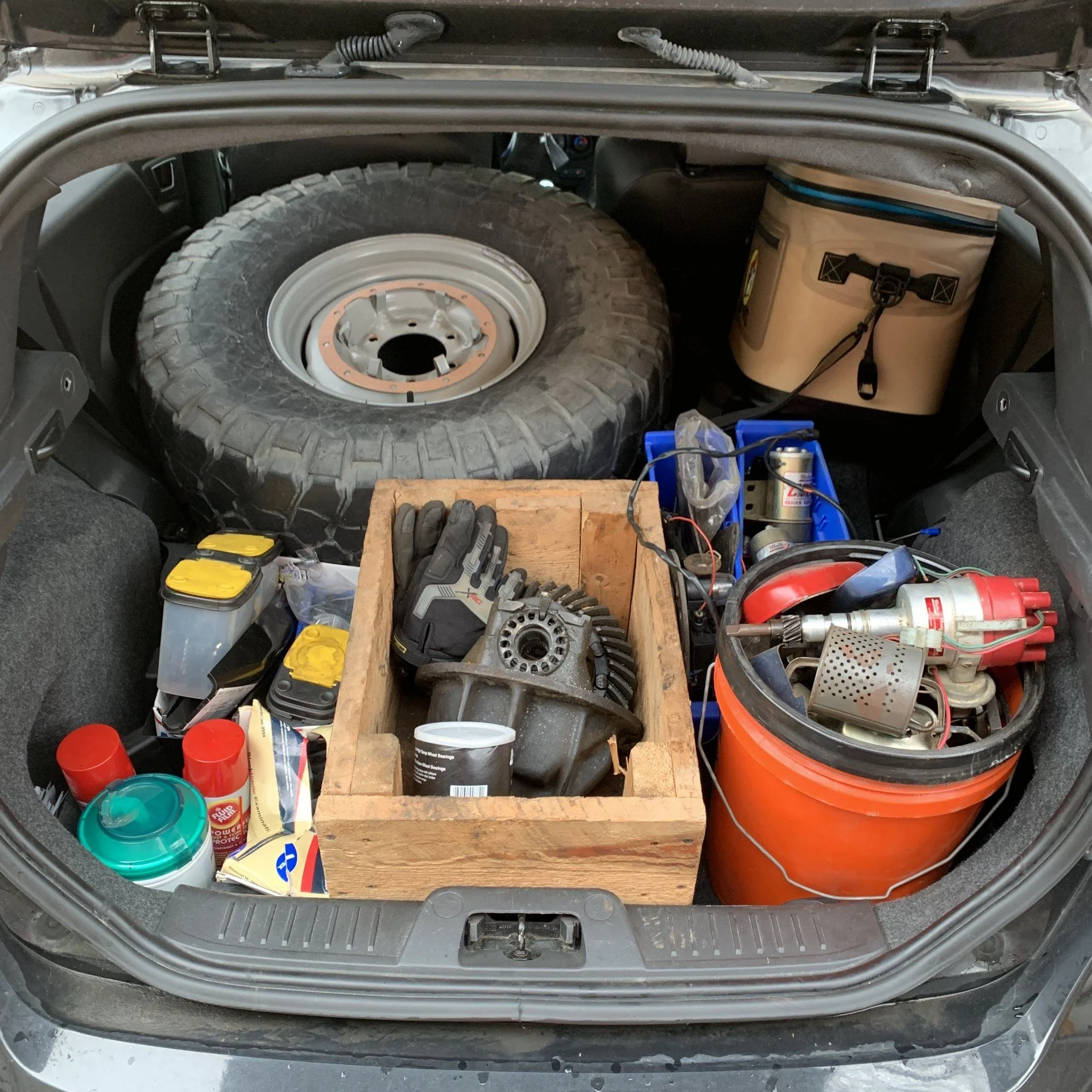

Car is loaded. I threw in a 5 gallon bucket I haven’t looked in for 10 years, but I did see important stuff in it like rear drum brake springs and guts from a manual steering box. Figure it will give my 17 yo son something to sort through.
on the plus side I’m bringing a box of Padron 1964 Anniversary cigars and a nice bottle of tequila

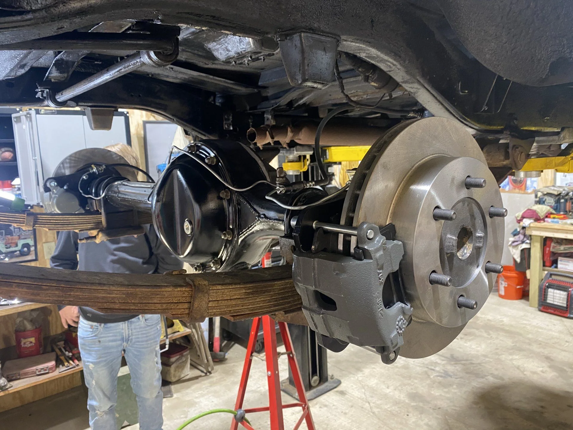

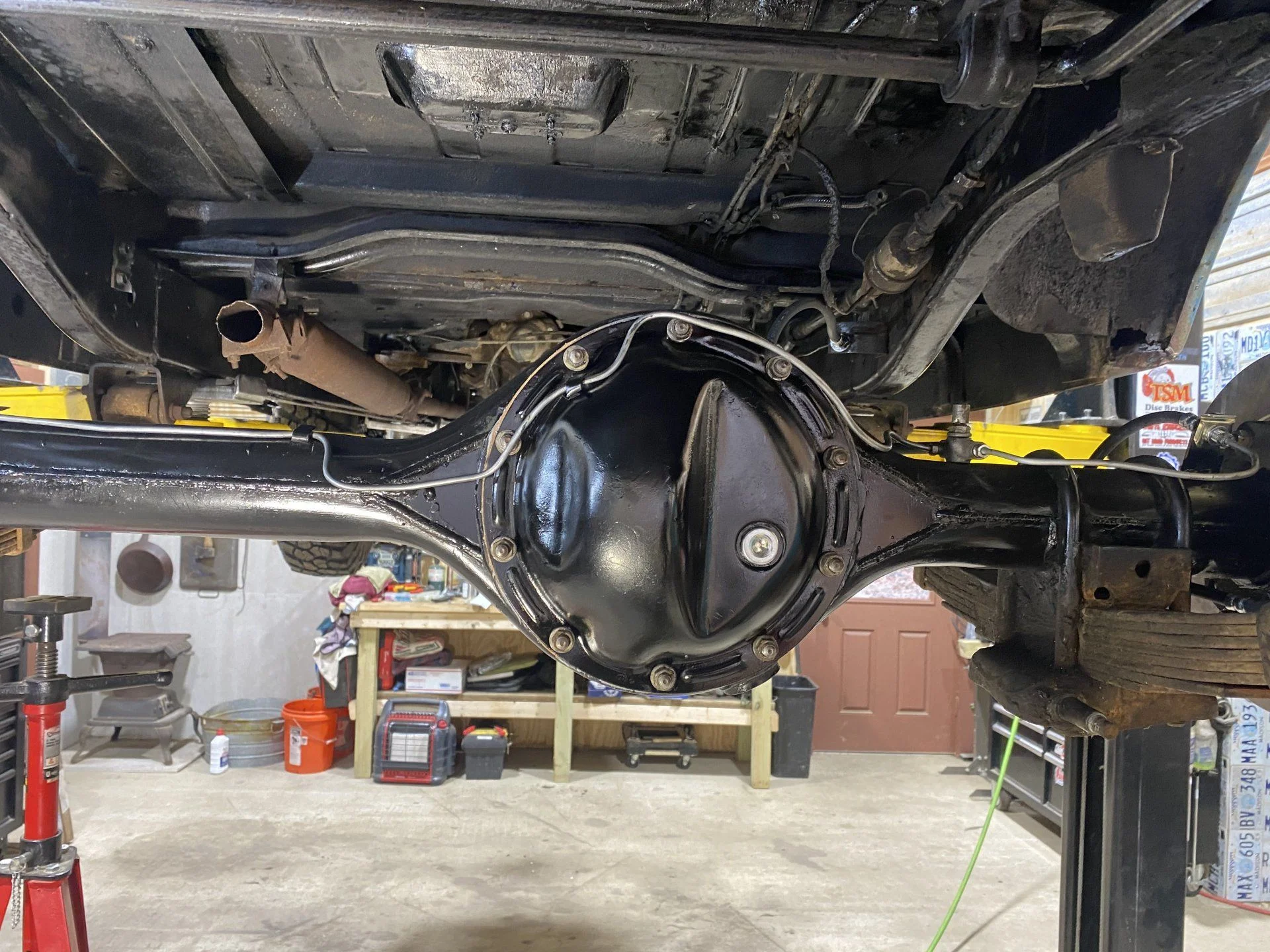

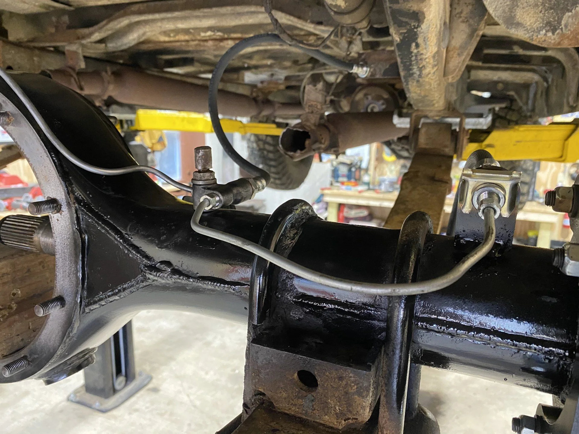

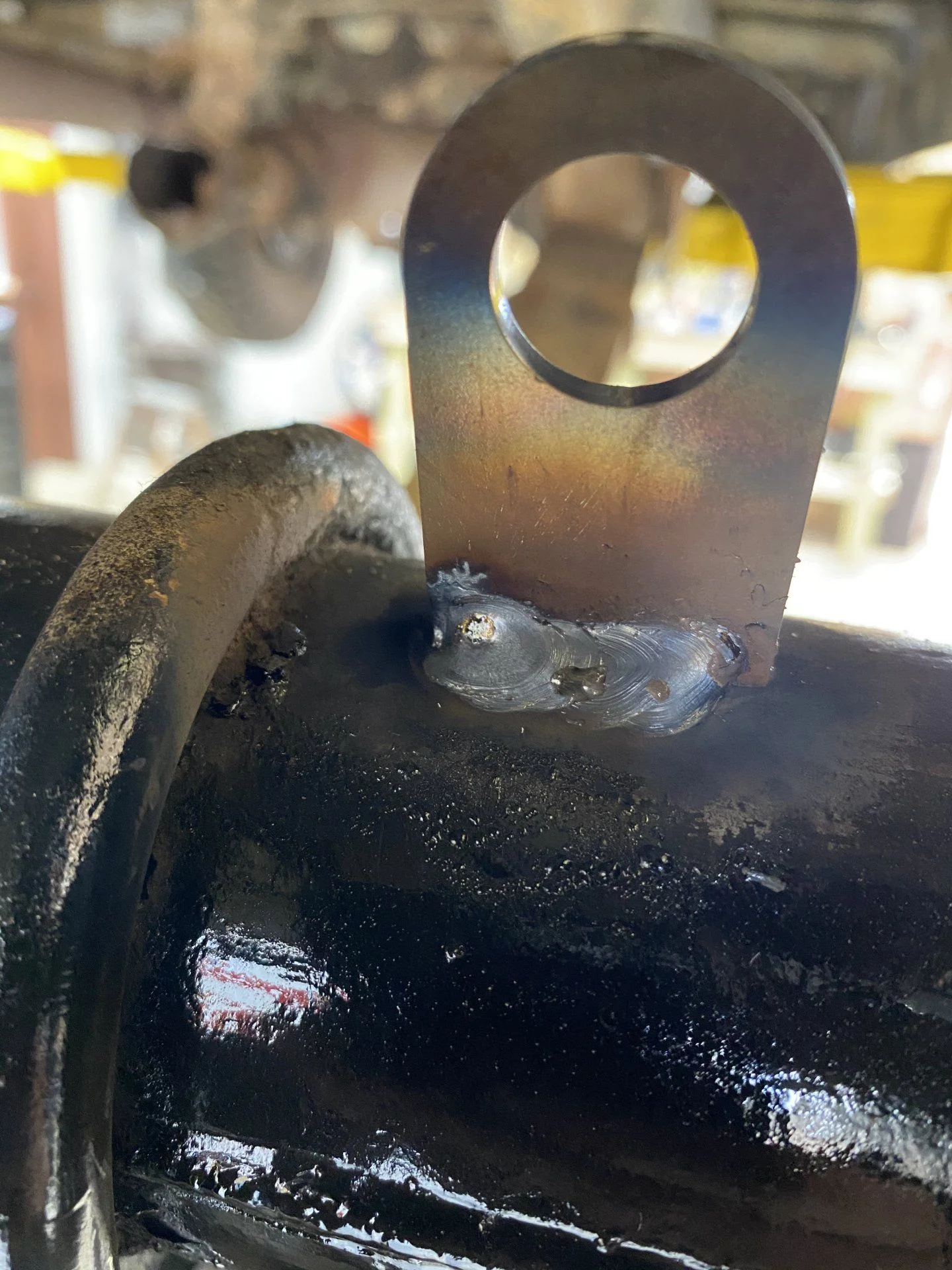

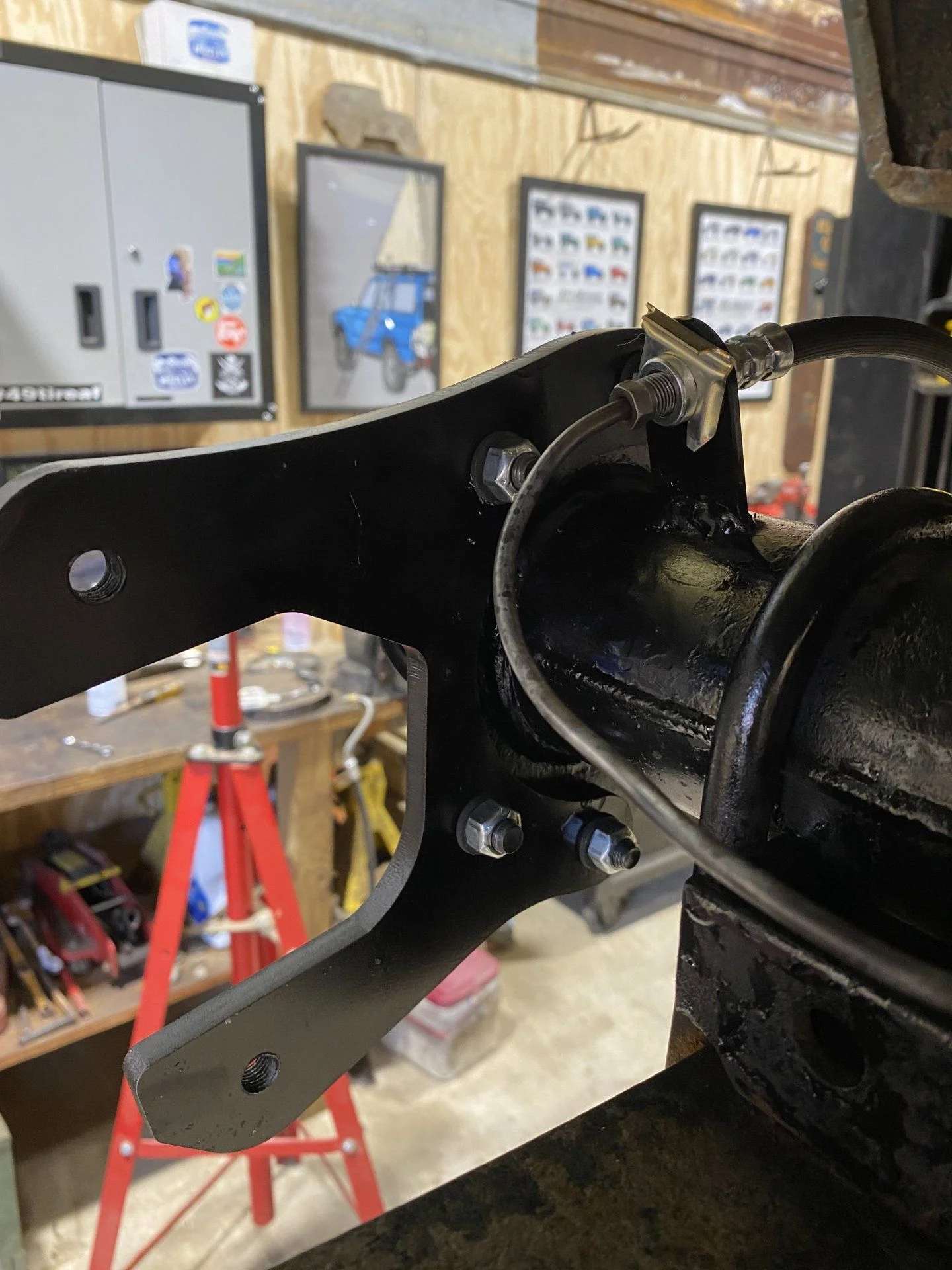

The Limo came with a rear disc brake kit. I’ve been using a super simple setup from TJM that does not require any fab and has all new brake lines. This kit has a couple of weld on tabs and I had to reuse and rebend the long line and make a short line. Time consuming but it will be nice and tidy once it’s all in place
Also went ahead and painted and cleaned the rest of the undercarriage. I may have mentioned it before but this truck has a thick undercoating that is pretty remarkably intact so I only have to clean it good and fill in a gap or 10 and paint over it

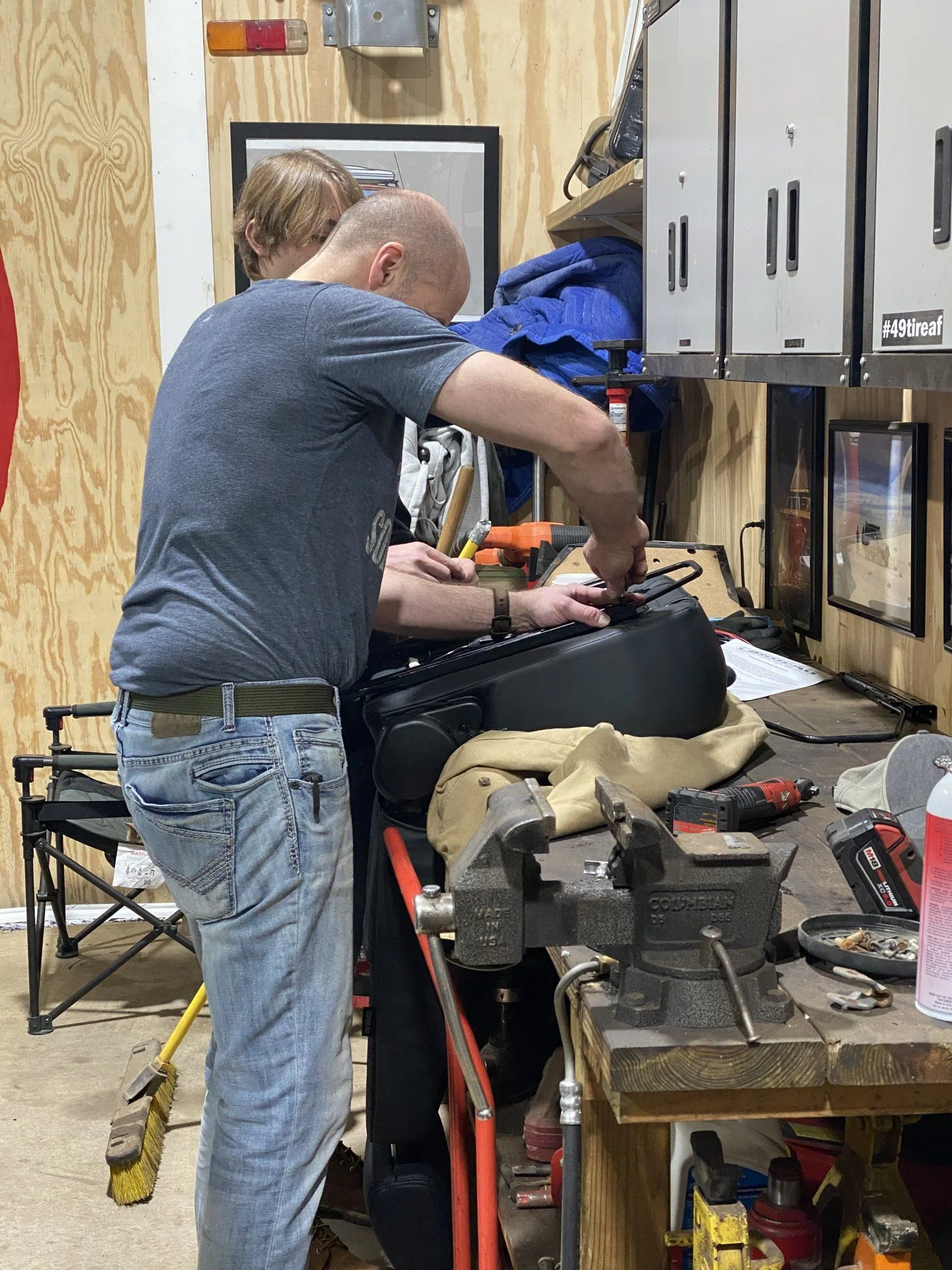

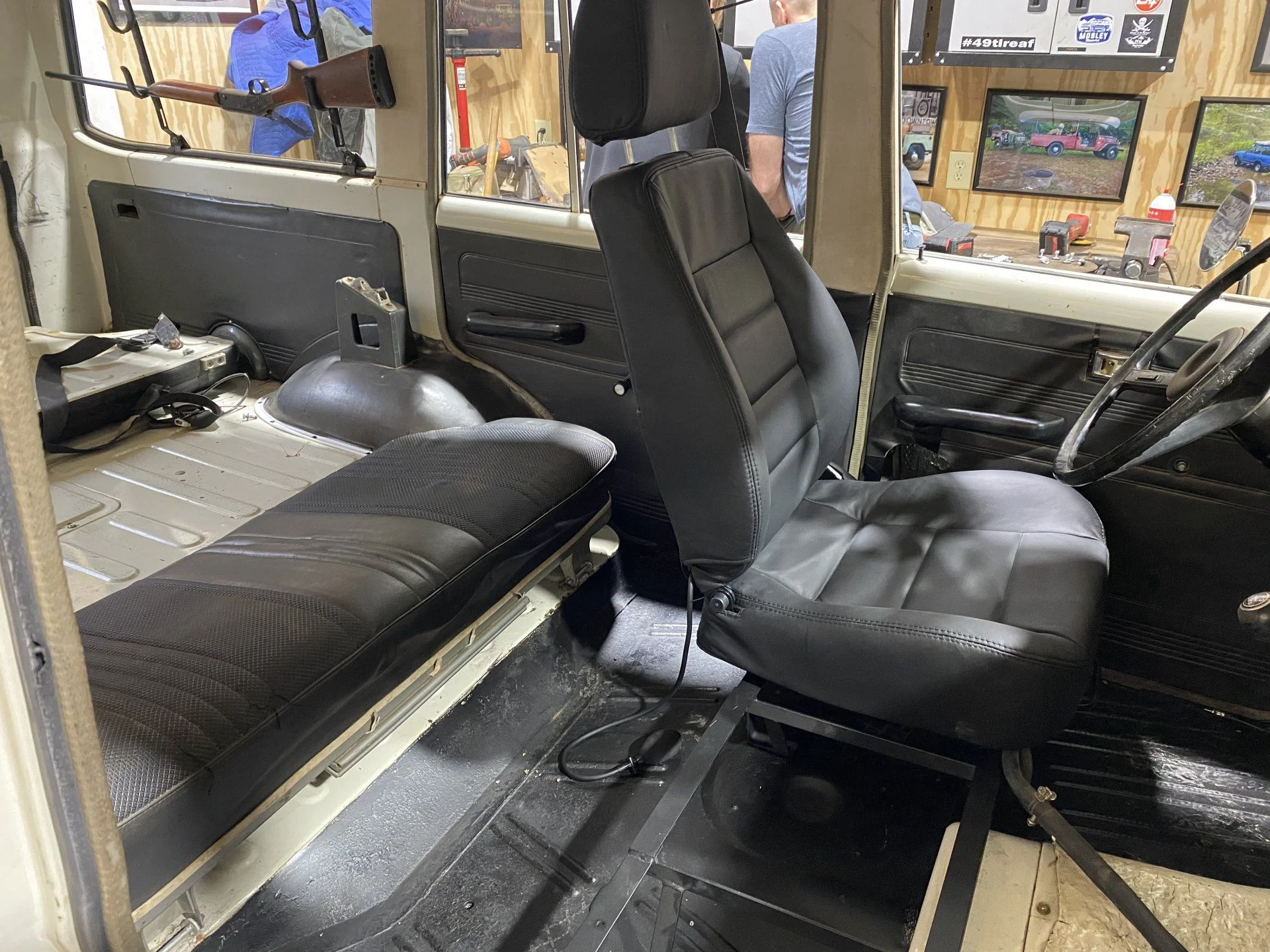

We left the shop after the seat test and hit the Blue Rooster in Flora for a Flamethrower burger

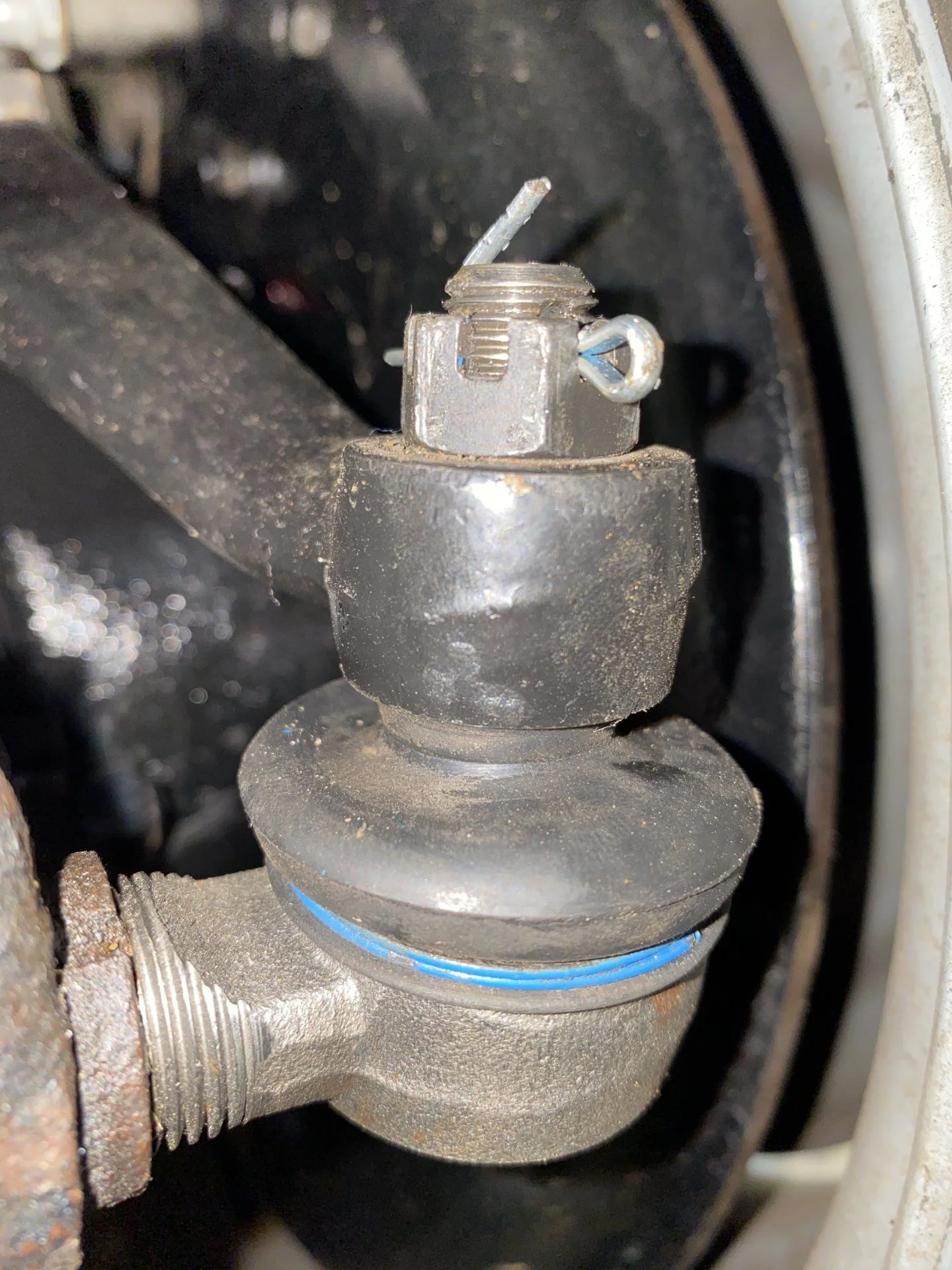

Once we got home we jumped back on the Limo before we got induced into a burger coma. The tie rod ends were toast and got replaced. Drag link and center arm are all still in place but will soon be replaced with some IPOR goodness

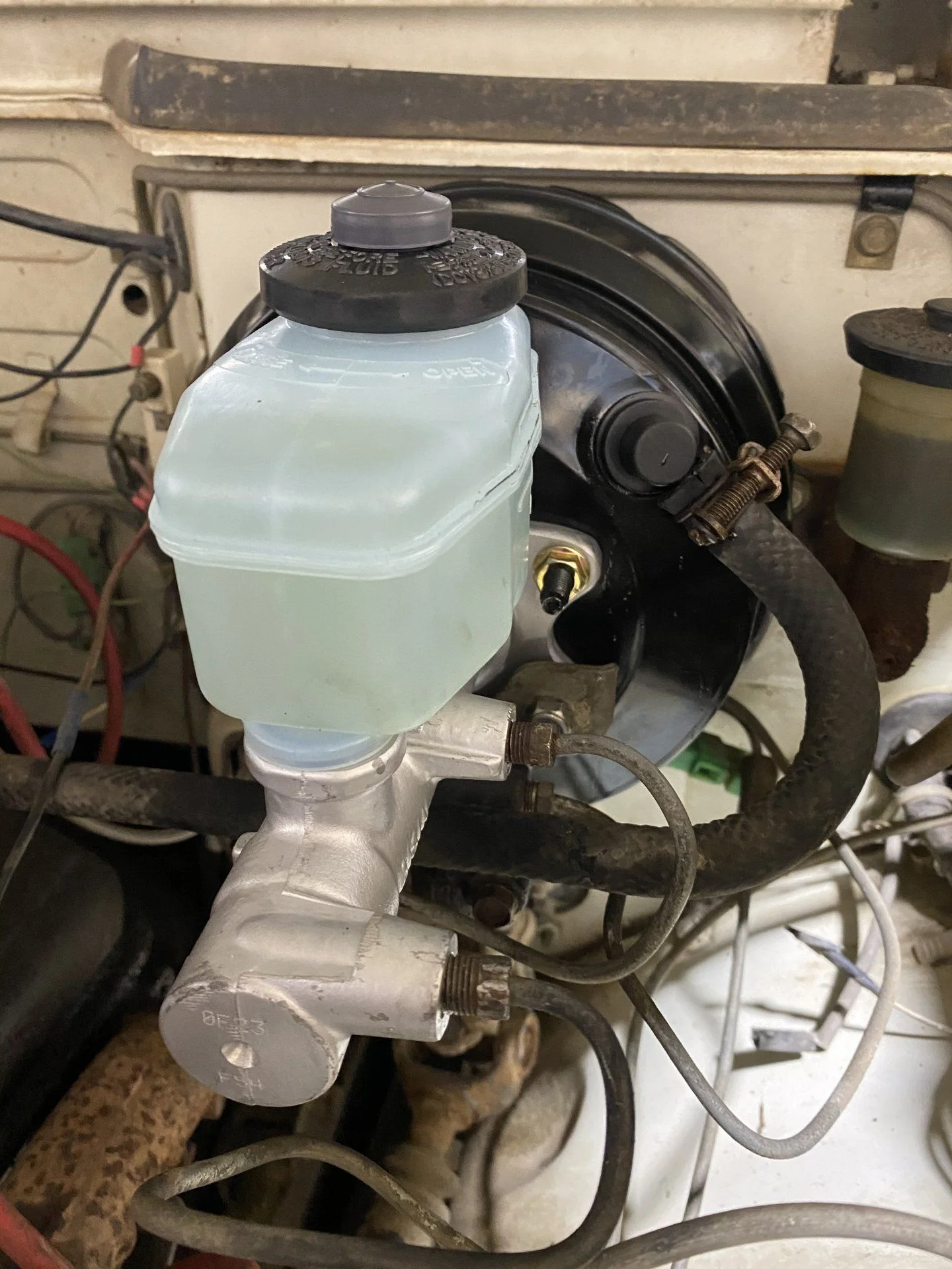

Next we bolted up the @Racer65 booster and non ABS 80 booster into the truck. Mikes son Sid was dandy to get under the dash and get all the hard to reach stuff out and replaced in a flash while Mike cut out the old trailer brake controller. I rebent the lines and hooked up the Motive bleeder and to my great surprise had zero leaks. Bleeding took one pass around and was complete in 5 minutes
