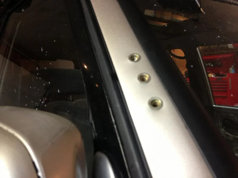

Installed nurserts in the A puller and used SS hardware and a dab of sealant.

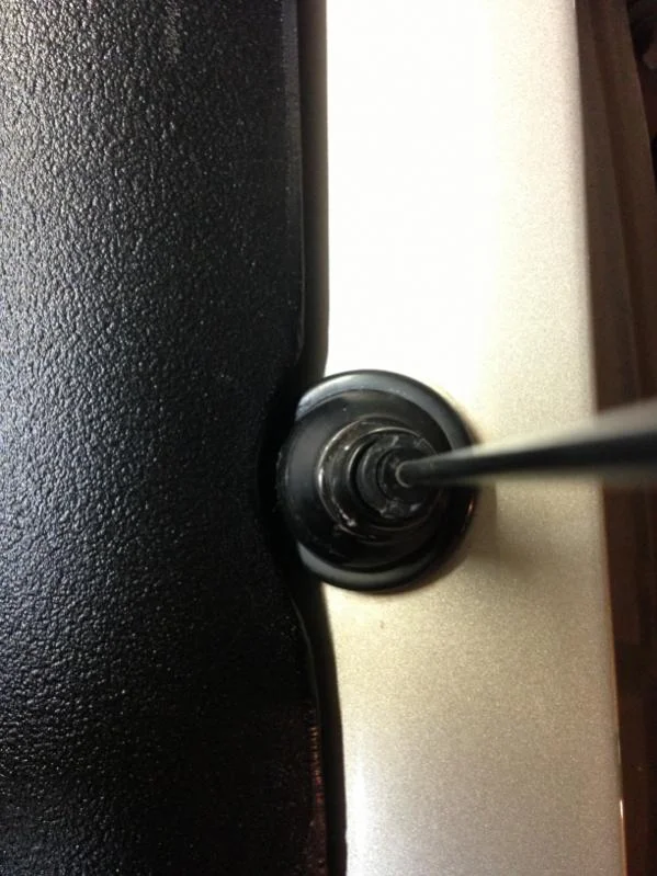

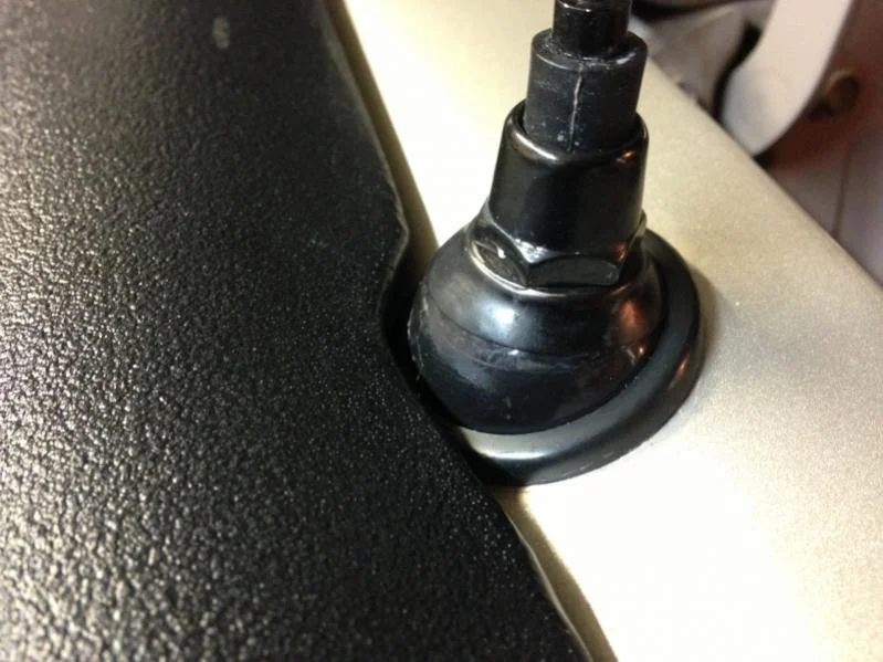

Heated the housing and used a glass to deform the housing and go around the antenna. Why glass? Abs doesn't stick to it and it leaves a smooth finish.
Is that a factory electric antenna on your 80? If not, where did it come from?
Came with it, standard non retractable aftermarket antenna.
Looks awesome Shane, I have a oem snorkel on stock ready to go on, wonder if that glass trick would work on the oem snorkel on a 96?
Yes using a large beer glass or drinking is best!
Its a large radius and won't stress the plastic. Mark the location after you've drilled and fitted the snorkel. Mark the center of the antenna on a piece of tape. SLOWLY hear the top radius and back of your snorkel and while your wife holds it up right (this is important) and slowly press the glass into the plastic about 2" from the rim and slowly push and slide down at the same time. This prevents a lip being made by the melting ABS and will look OE.

See my snorkel install. How does yours attach to your A pillar?
I think it calls for rivets to be used, not sure what I will use though? maybe something from the local hardware store, I know they have inserts and such that will accept a rounded ss bolt, which is what I will probably use.
Don't put a rivet into your truck!
You can buy a small tool that crushes the nut sets. I can supply you with the nurserts for the snorkel or anyplace you need a nut, like your bracket for electrical in the rear.
my snorkle came with vinyl/plastic inserts that expand. Seems plenty sturdy to me.
