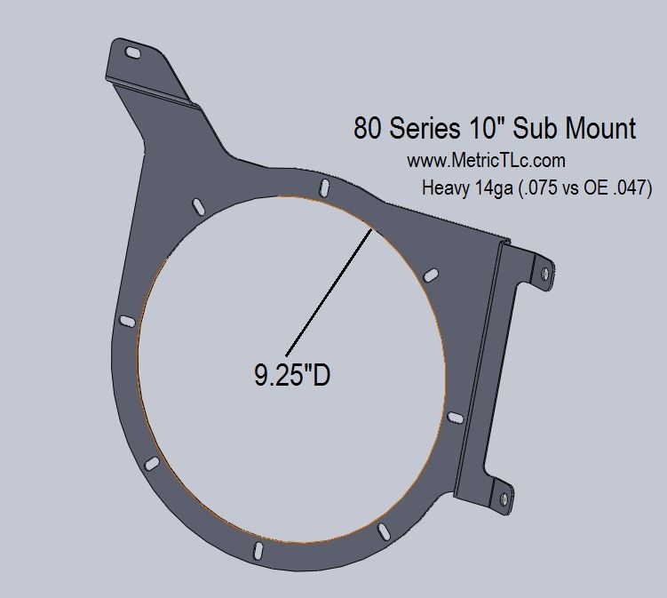

I'll need every year or versions of the old bracket, so if there is variances I can offer one that fits all 80's
The 80's need a 10" sub in a baaaaaad way. I picked up a mono amp and should be able to fit both on the same bracket. I'm not a fan of Aluminium so it will be stainless as Aluminium tends to fracture at forming points.
Please PM me if you have one I can have.
The quarter panel sub speaker/bracket is the same for all years 80.

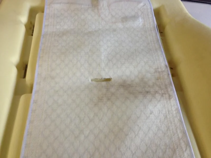

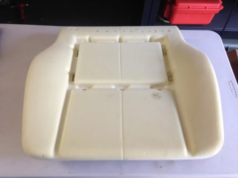

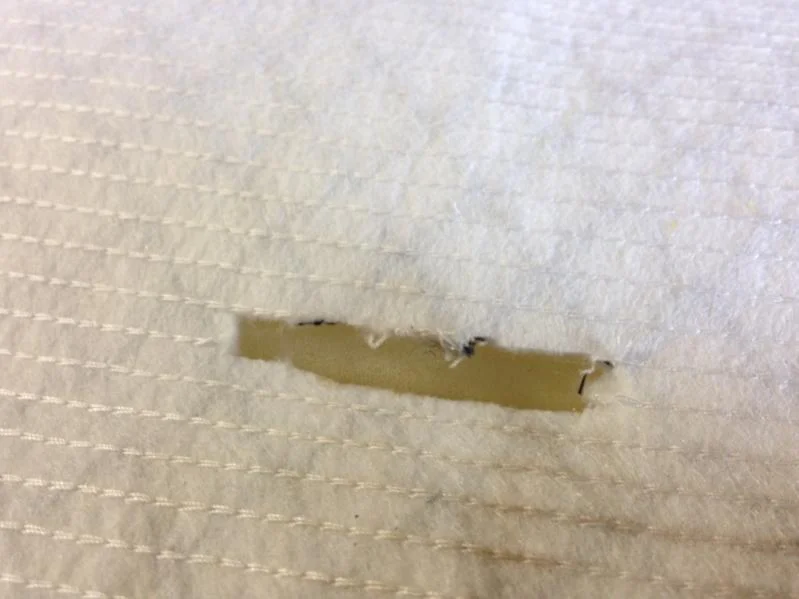

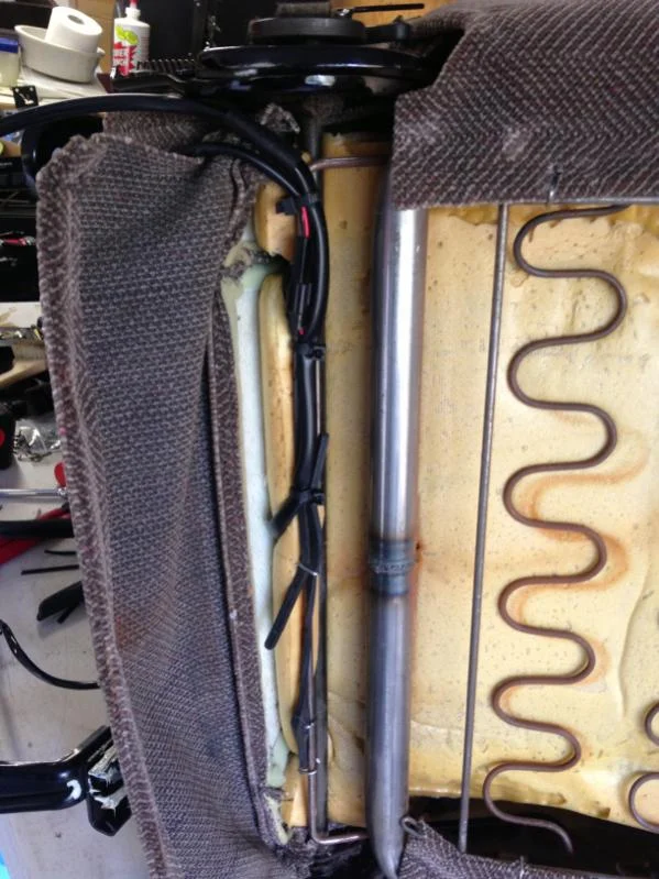

New seat cushion came Friday. Kinda cool that there's a hole in the rear center for the hardness to feed through.
I get asked all the time about patters and fit of out leather. They are all made from low mileage mint interiors to ensure perfection.
However they take some time to settle into place.
I just installed a new cushion with factory cloth covers you'd assume have stretched over time and fit loose. Nope, tight and so tight they look horrible. It will take some seat time to get them to settle in. NEVER add foam to your seats as it only adds stress to the seams and listings.

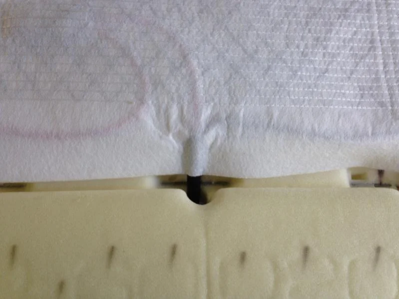

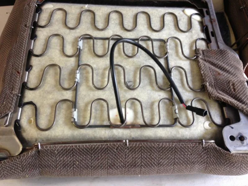

When attaching your heated seat harness, leave the upper seat back open so you can tie off the harness.
