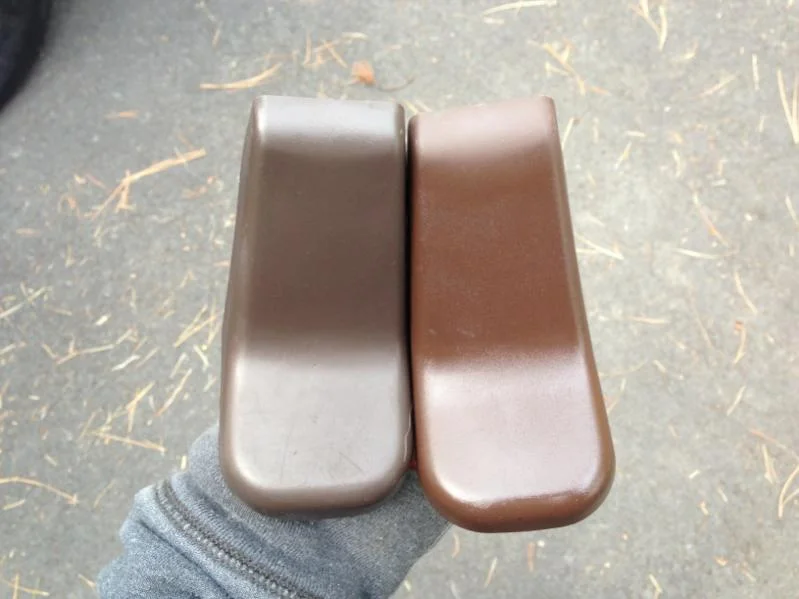

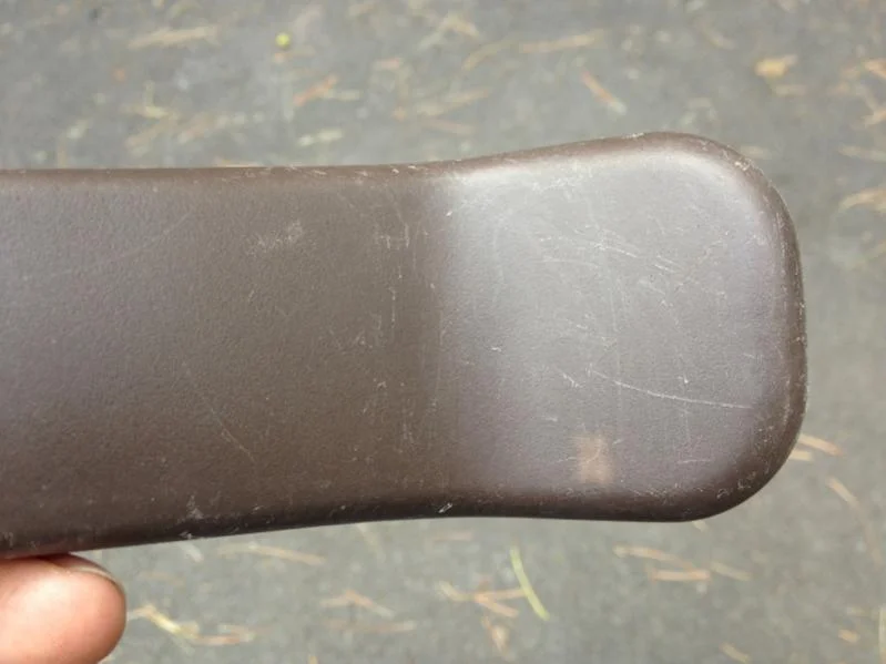

Before and after heat.

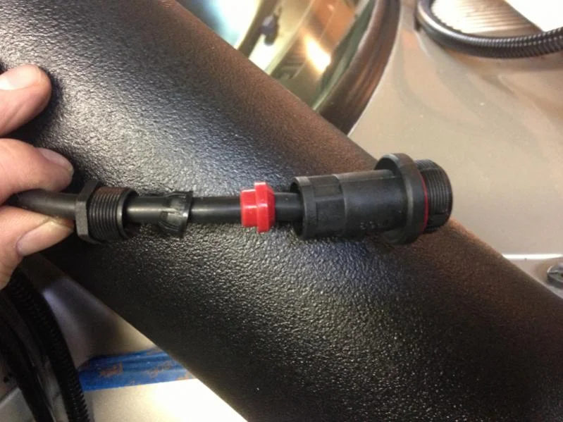

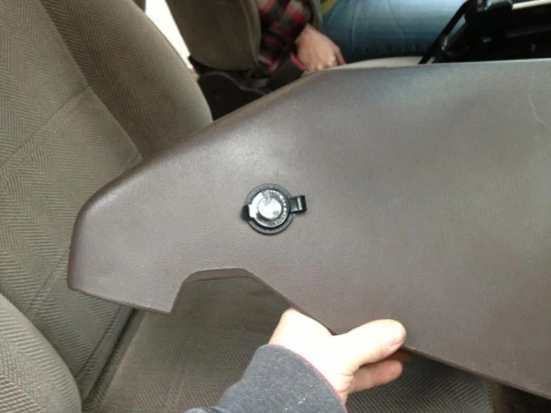

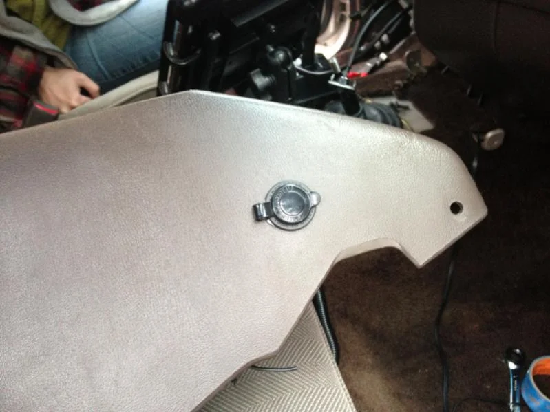

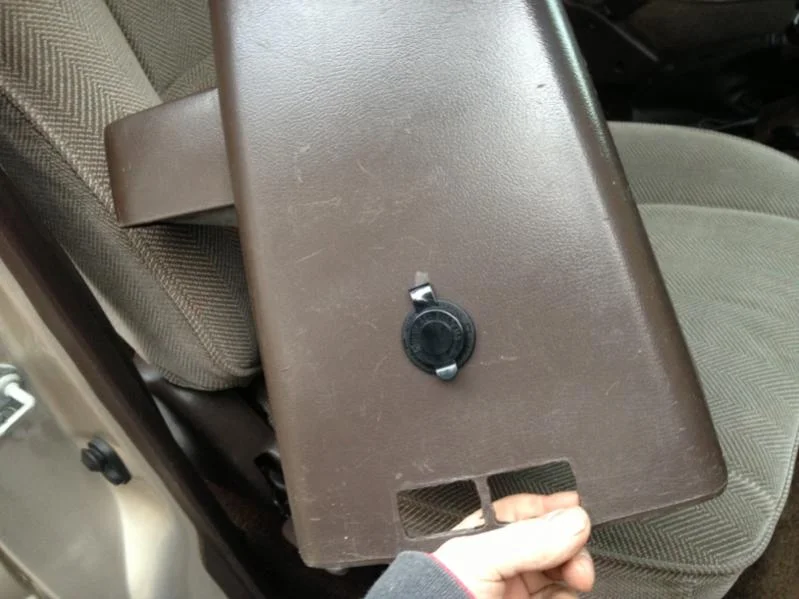

I didn't like the clutter of chargers, so I installed Blue Sea plugs in the side and rear, plus one on the inside.

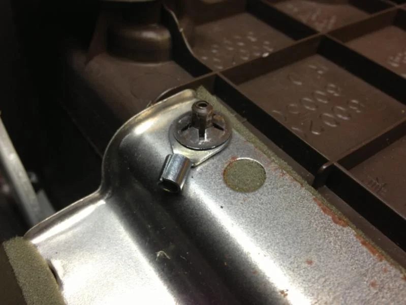

Also put Eire connectors on plastic studs with retainers to secure the wires.

That trick with the electrical terminal on the plastic stud is sweet.

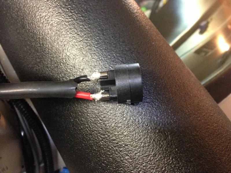

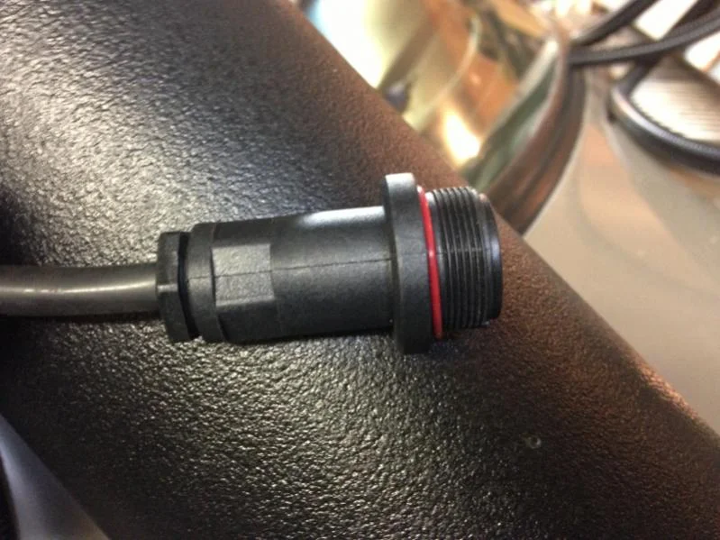

Had to shorten the wire from the e-Vision LED curved light bar. These connectors are kick ass.
Remove, solder, re install.

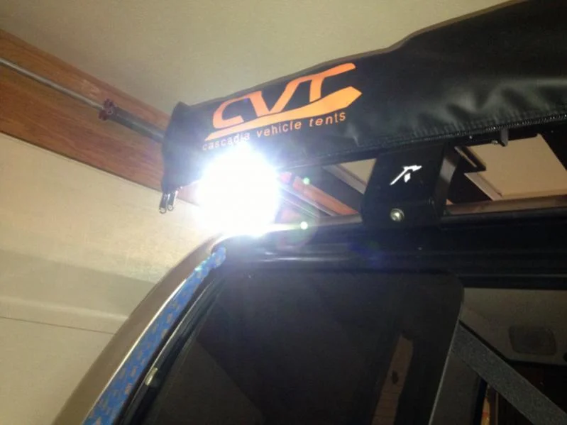

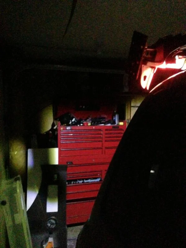

Camp lights. RF, RT, LR.
Thanks, I had a chance to play with one of my lights in the dark over the weekend. Its basically the perfect amount of light/beam for simple camp illumination. :cool: Just don't look directly into the bulb. Its damned bright.

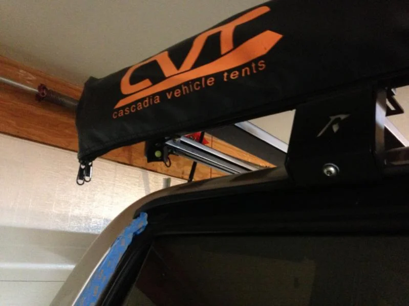

My rack build is scheduled to start end of April.

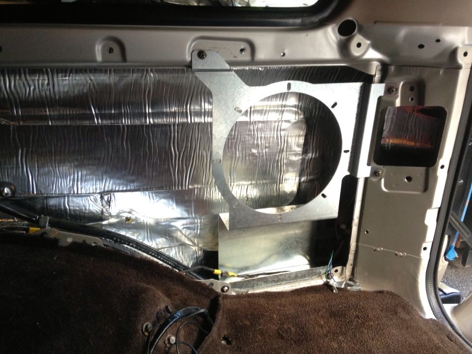

-10" Sub mount installed.
