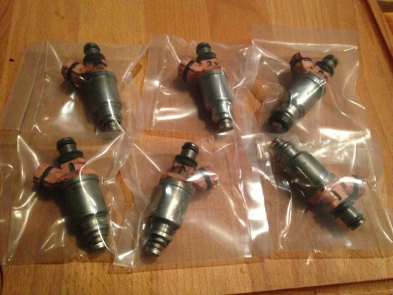

I felt like ass today and had a late start. Dropped the head off at Deschutes Machine shop. Great guy and a wealth of information as he told me I was missing all the buckets that sit on the valves, FAWK! Sent a text to my part guy, $333 for them!!! So I went to the shop that had taken it apart. Holy crap! The tech had them all, marked and in a box!!! I asked about the chain and sprocket as there was no marks. He told me that he had marked the chain and if I have any questions about setting it up that I could call. That was a huge load off my chest.
Dropped them back at machine shop and off to the post office to ship my injectors out for servicing.
