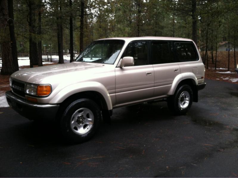

Super Clean. Check
Acid. Check
Bucket of water and Dawn. Check
Clay bar. Check
Prep is complete.
Very lucky that its 100% paint other than roof was painted due to rack removal. This makes for a long detail process, but a rewarding one.
WOW looks brand new!! Nice work.. Great attention to detail on the small things. I used to be a detail fanatic with show cars/BMW's . Wet sanding and buffing everything possible, clay bars, etc. I detailed my 80 all the time until it started to get trail damages and mud, then I just said F it, just going to relax.
