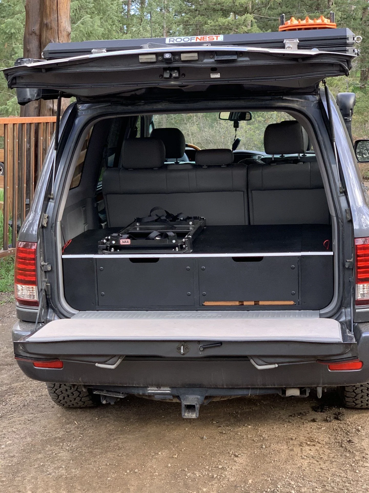

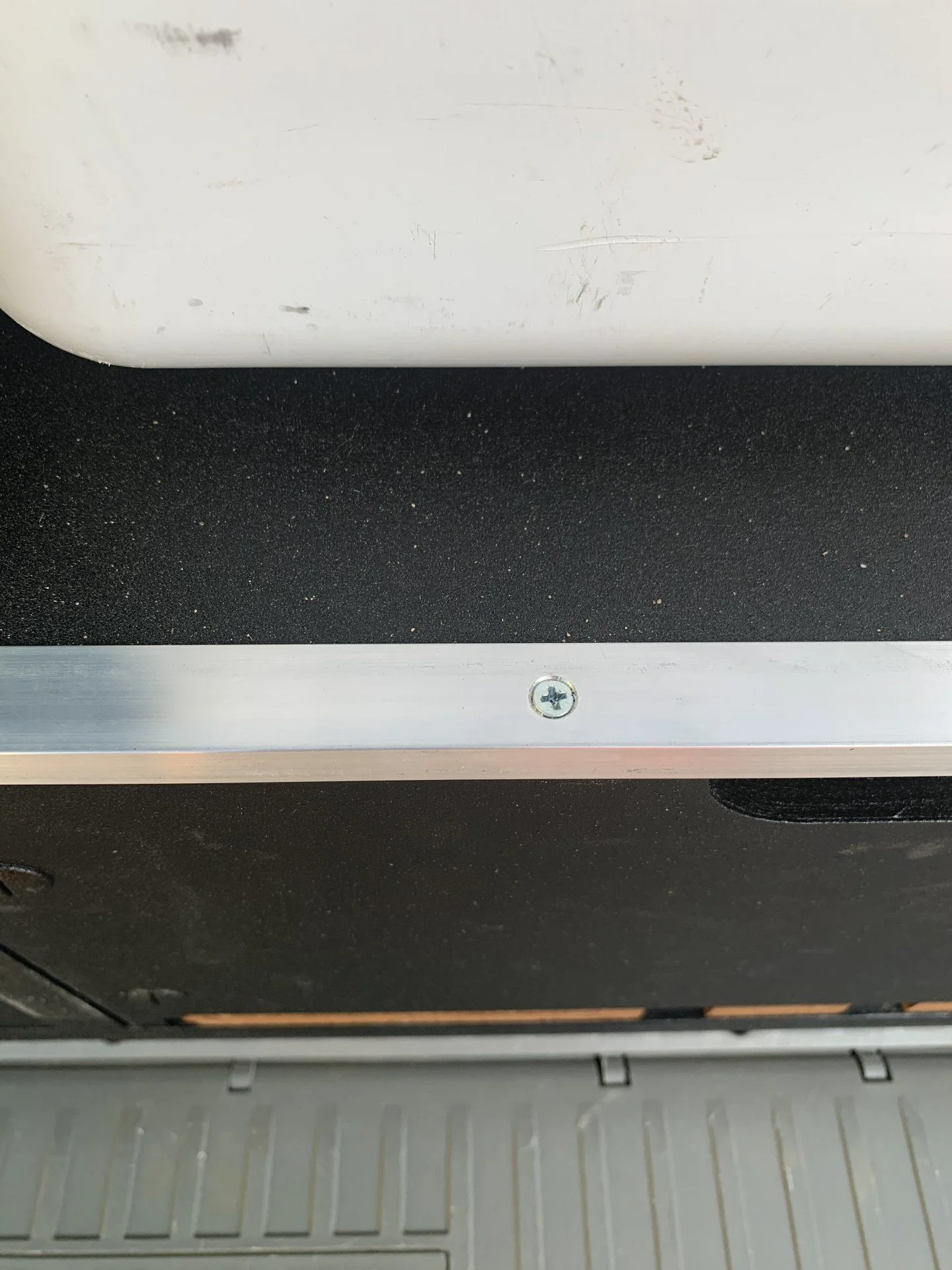

Great looking setup! Where did you source the aluminum edge protection? Looking to add some to my rig, maybe even sell to folks if I can buy in bulk or this was tough to get. Do things snag on top where they are screwed down? (debating screwing from the front or not...)
So it’s just aluminum from the Home Depot. I think 1/2” by 1”. There’s about a 32nd difference in the thickness of the birch. Not sure drilling on the front would be a good option. Since the Baltic birch is a laminate. It would likely spread. From the top I countersunk the holes. Then used a screw about the length of the ones for the wing hinges. I put aluminum on to prevent layers from getting caught and peeling. And I do have to say it is a great system. That being the drawers.
