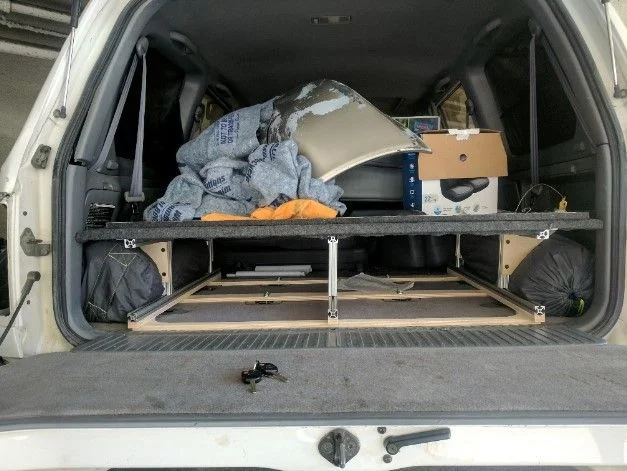

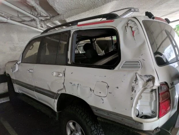

True story: a customer of KISS drawers rolled his rig, truck was totaled, but nothing flew out of the drawers. The drawers themselves were definitely tweaked but he took them out, put them in his replacement rig, and they were fine.
So the bottom line is it is up to every driver to responsibly secure the contents of their vehicle, be that a rubbermaid bin, a home depot toolbox, ammo cans, a drawer system, or a home-made-whachacallit. Whatever you do, strap it down & be safe.

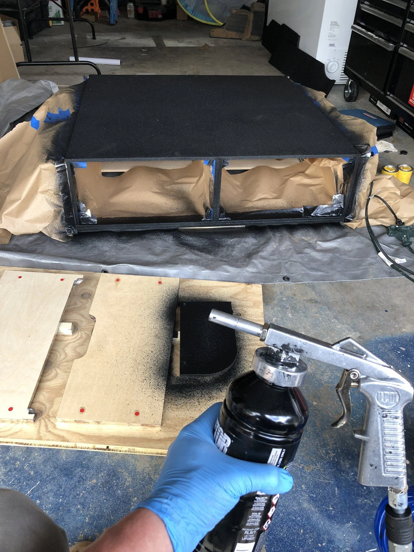

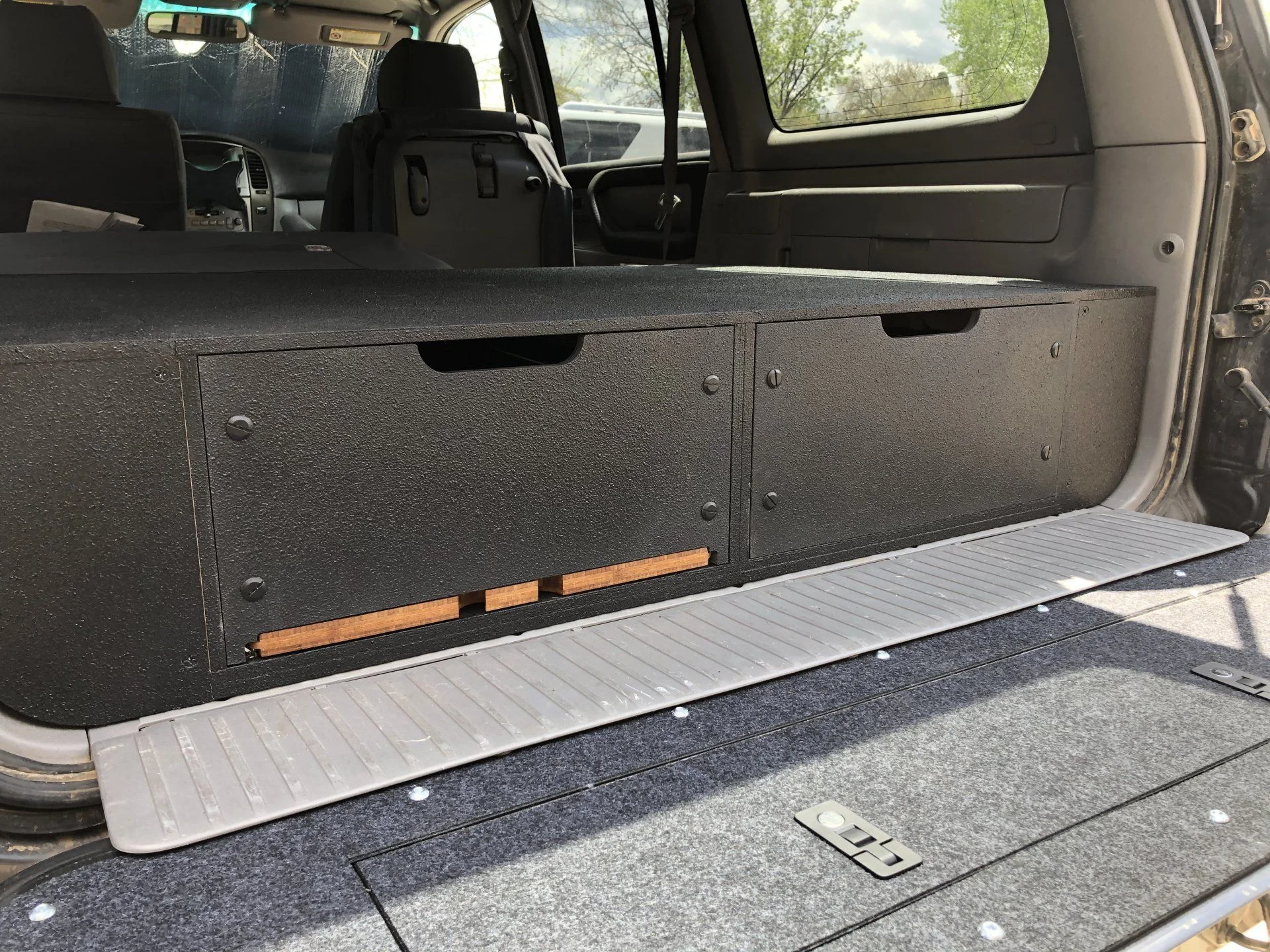

My install. I used Behr deck stain per the Home Depot expert reco, and it worked great. I covered with
Rubber-Cal Diamond Plate Metallic PVC Flooring from Amazon. Decided not to glue it down in case I wanted to take it all apart someday. I only screwed it down with the 3/4" aluminum angle bar on the front. Figured the aluminum was important to protect the front edge. Also put the rubber inside the drawers to protect the wood and dampen rattles. Everything works great!
In all, more than a 2 beer project, but not hard. Dave has done a great job with directions and the "drawer tool" is ingenious!

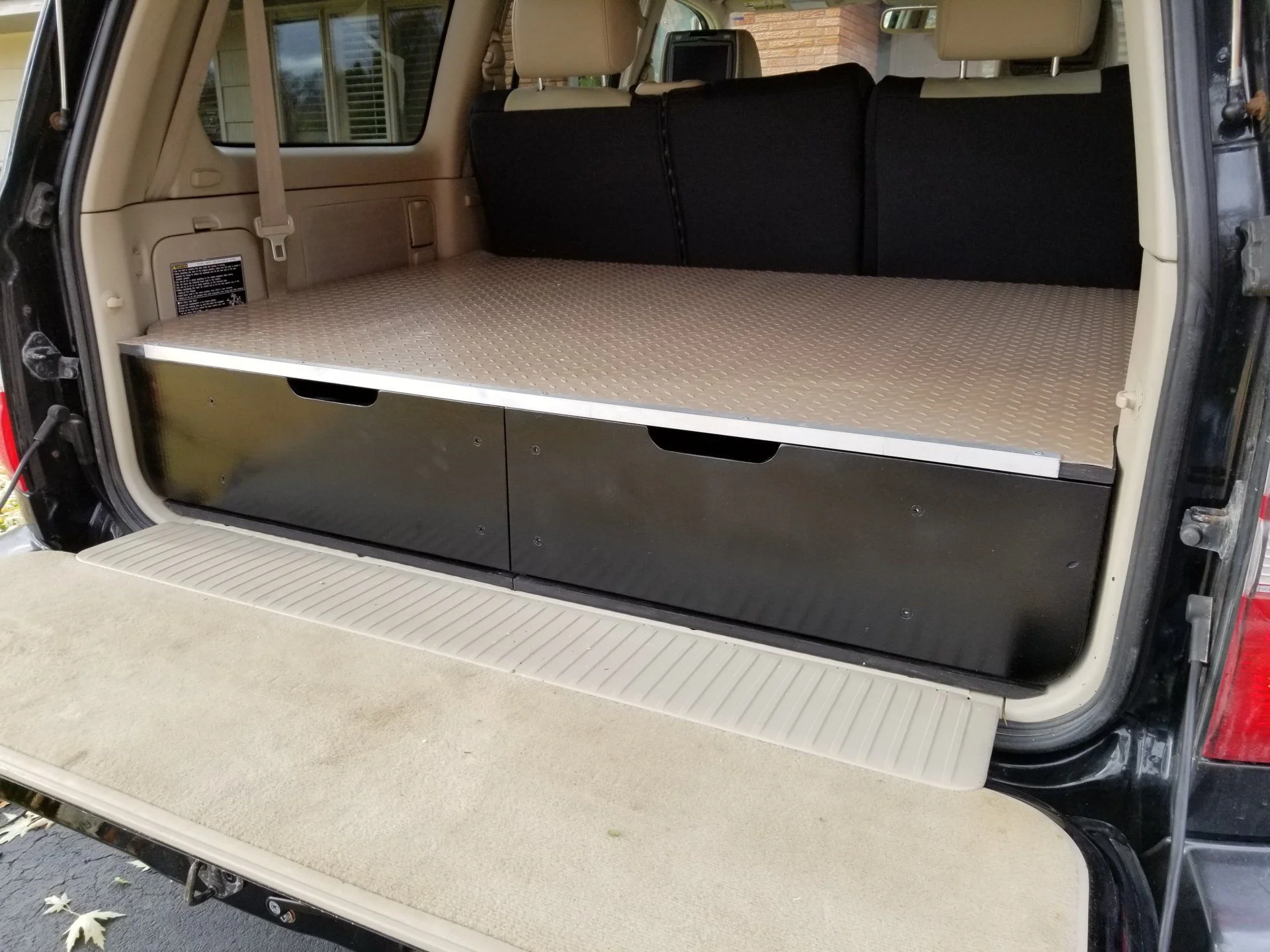

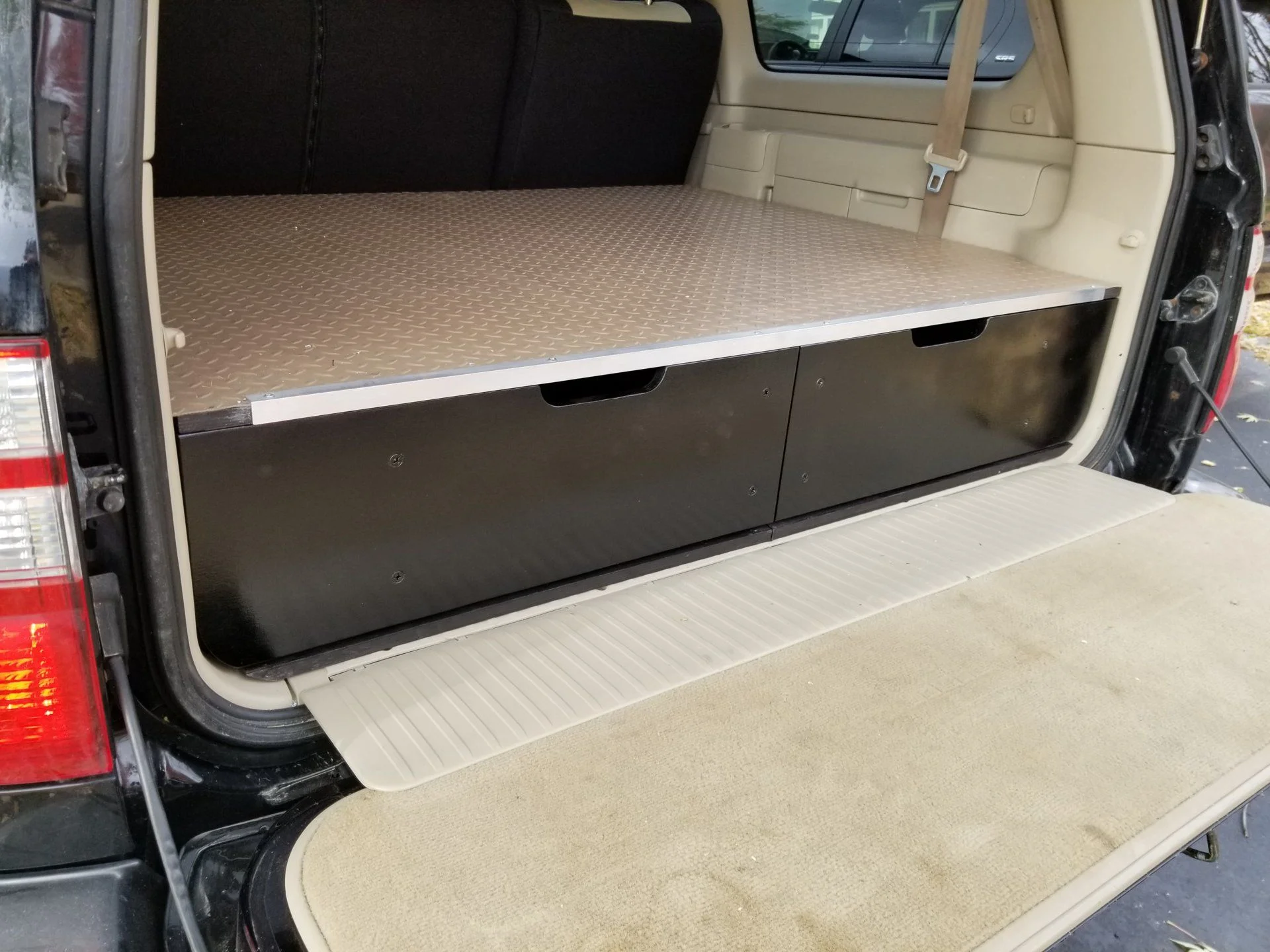

I installed the diamond flooring for my drawers. Amazon product ASIN B015T8O0YY
I spent the winter in Arizona and on a hot day in the sun, the flooring peeled and separated. Argh! I'm glad I didn't glue it down -- just screwed it -- so I can replace it with something else. BTW, I thought the diamond flooring would help prevent things from sliding. It didn't.
BTW, I LOVE the drawers!

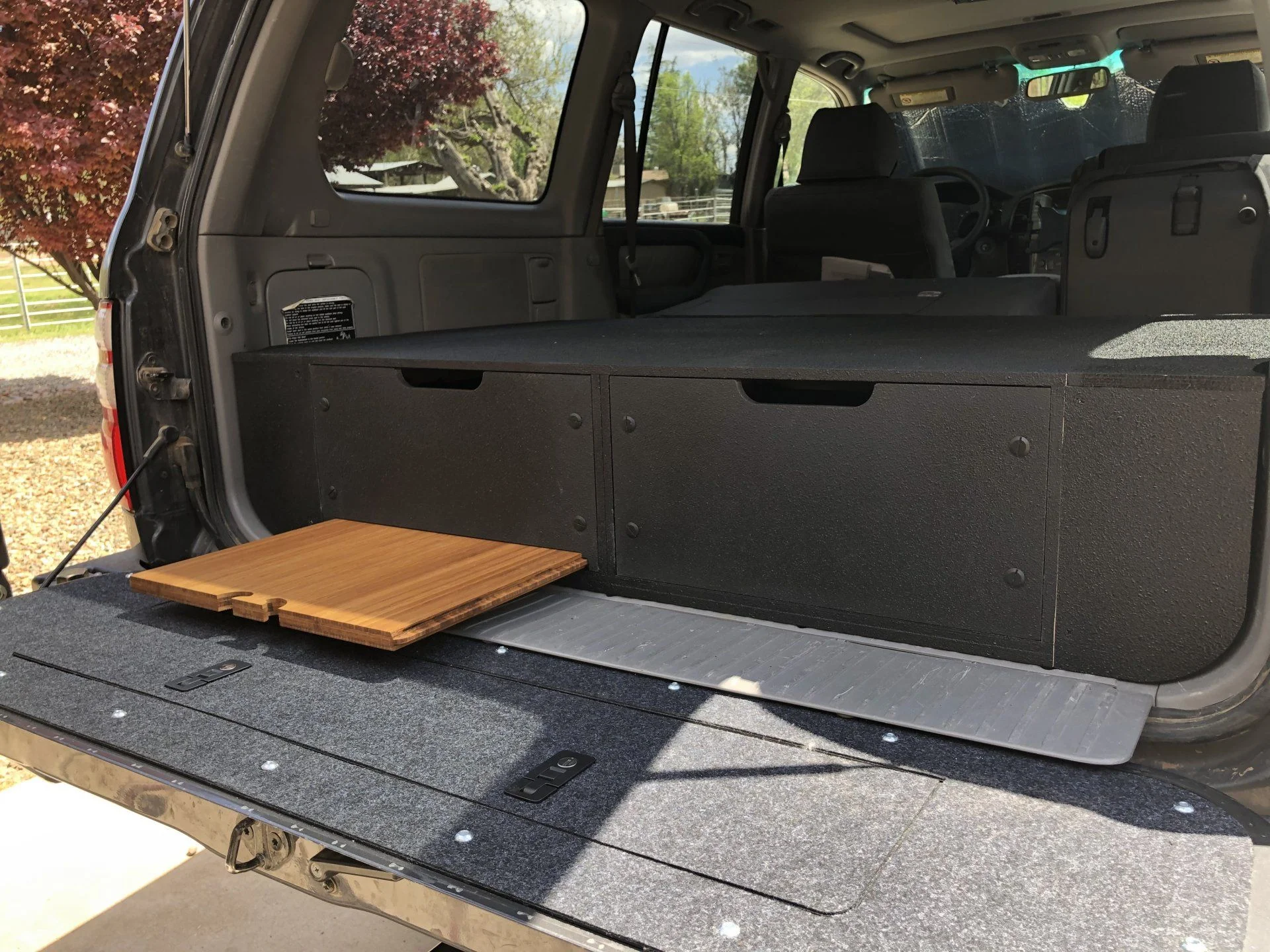

Here is my finished Reef Drawer setup with wings and the sandbar cutting board. Overall the drawers turned out great and I couldn't be happier. Everything went together very well and is extremely functional. Big thanks to @cruzerDave for putting out an exceptional product!!
Those look fantastic! I love what he's done on the redesign! I have the mk2's and I love mine, but these are so slick!
