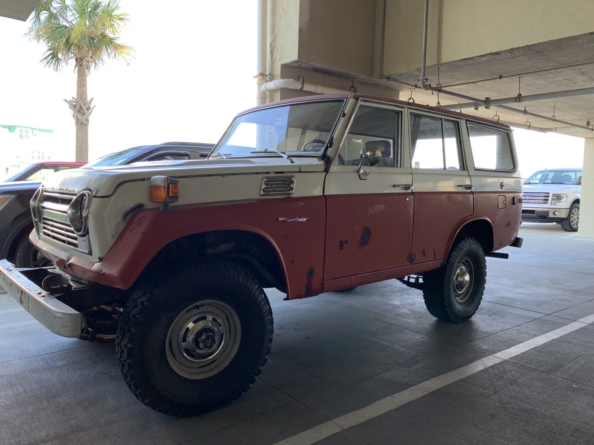

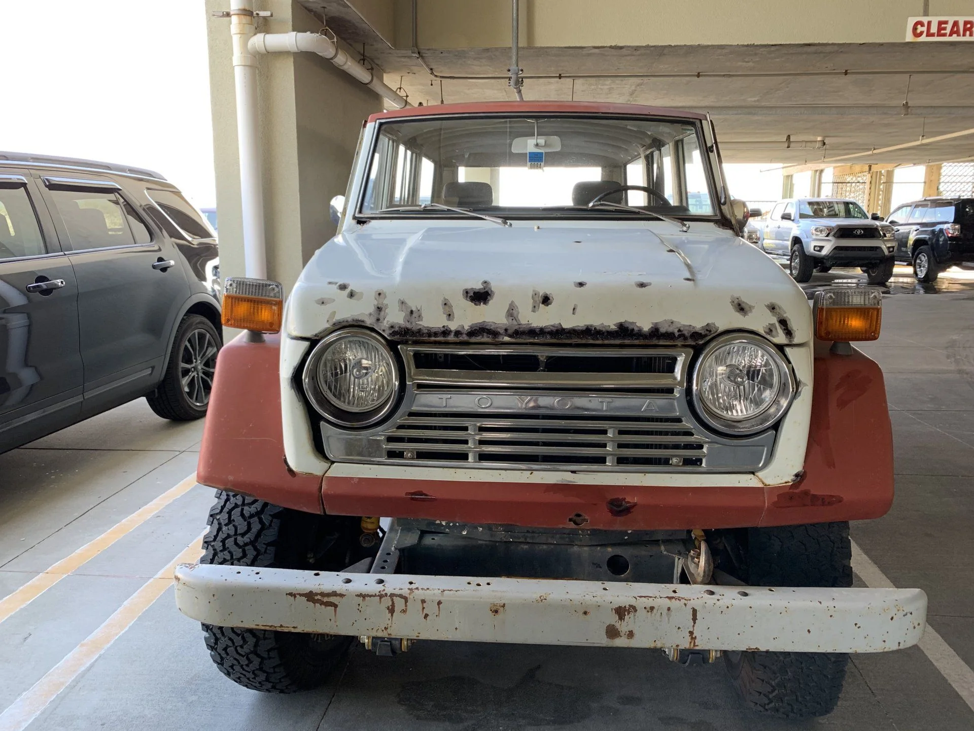

So I just bought a ‘77 FJ55 and I want to do what I can to stop further rust propagation until I have the time to do a full blown frame off. I'm leaning toward using Eastwood or Black Star or similar rust converter followed by some Cruiser Corps, rattle-can Freeborn Red and Cygnus White. Frame is in good shape so we’re only talking a few areas on the body.
I have read about 20 threads that mention rust converters but there was only a little experience with the Eastwood and almost nothing on the Black Star. Here is a pic so you can see what I’m working with.
Just looking for first hand experience with those products or similar in a similar application. Thanks
