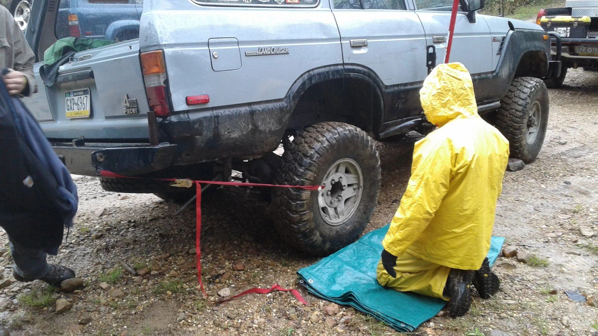

Not this time...
I'll add, great group of folks to get stuck with; supported me in getting off the trail and hung with me in the rainy parking lot. Tow truck was on its way before we even made it off the trial, no pressure, no ill will, tools and straps handed to me before I knew I needed them... A ride home! Good stuff fellas, THANK YOU!

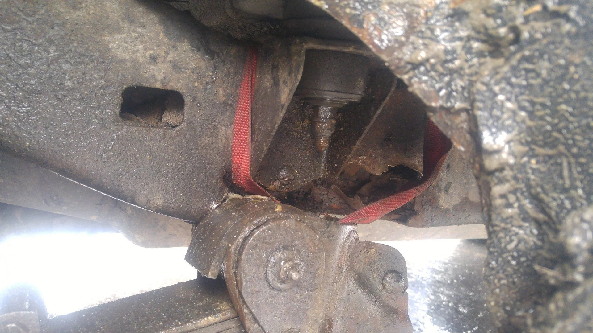

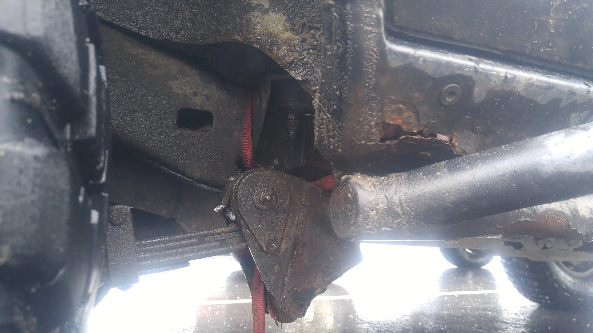

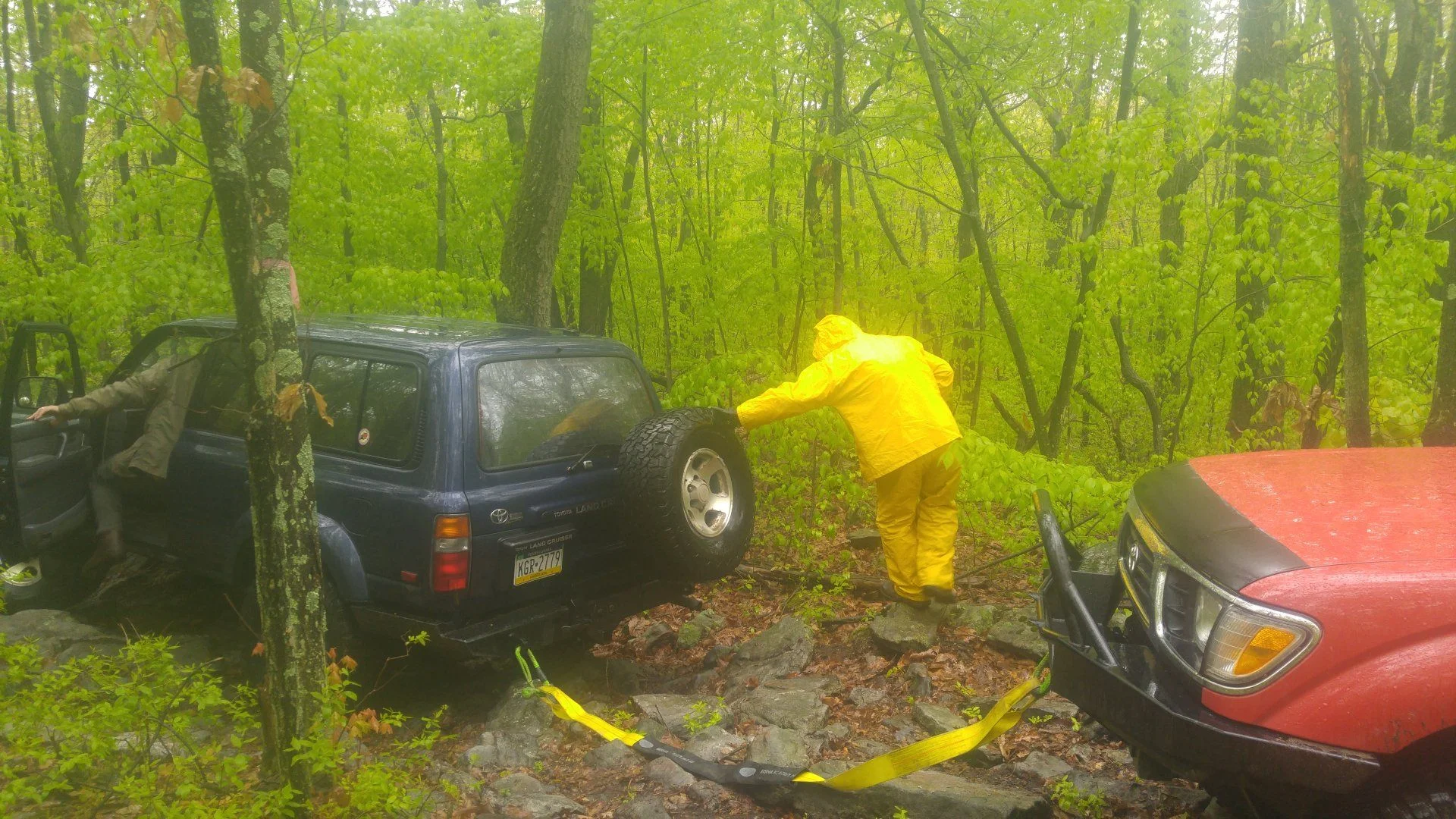

so i want to know what happened to pacer's 60series?
Well his frame tore apart where the front of the passenger side rear leaf spring attaches. As in most such breaks it was probably cracked in that area for some time and gave way yesterday while climbing over the rocks. Was an ugly break. Aaron figured with all the dirt and crud that was inside the frame rails that someday he'd have a problem. Well the problem materialized yesterday. Truck is sitting at Hopes Towing in Tamaqua and will be delivered to Philly tomorrow. He's unsure whether or not to fix it or replace the frame with a good one that he already has. Stay tuned I suppose.................
Given what that truck has been through over the (last 10?) years I'm impressed it went this long without some major failure. Not surprised, but impressed.
^^^ I was "bulldozing" all morning, tail gunning, not paying a terrible amount of attention to the terrain, kinda just spooling up the throttle and letting the brakes and locker do their thing.
And yes, as Gary said already, this frame has been in rough shape for years. This is a known week spot on the j60 frame. Definitely could see it coming and should be inspected carfully if considering taking on one of these trucks.
As Riverhead said also, I'm not easy on the old girl.
Passenger side, rear spring hanger, I could scab plate it and weld'er up....
I could frame swap....
Yank the drivetrain and scrap it...?
Not this time...
Damn Aaron, sorry to hear of the carnage. Plate it up, check out the other spring mounts, and keep giving it the business. A frame swap is a PITA, but you already knew that.
