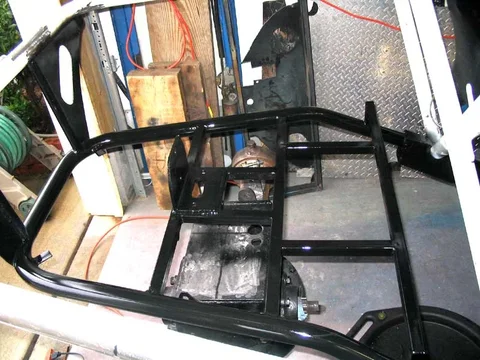

Cut a notch out of the frame for the rear crossmember (2" .250 box), and reinforced the inside area with these plates.
The fuel cell / rear winch / toolbox mounts are done. The tall bracket is for the winch, since it's sitting 90* of how it's designed. Fuel cell sits up front, with the toolbox at the back. The cooler will go to the left of the fuel cell, I'm going to recycle the mount from the last build for that.

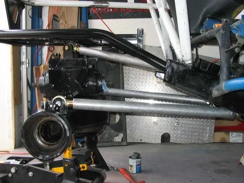

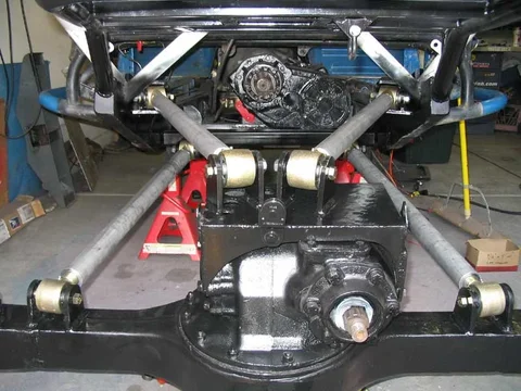

The 'Cruiser is now officially 4-linked, front and rear!
I think it's gonna perform great, I nailed the specs I was shooting for, (except the front roll center is lower than the rear and there isn't much triangulation in the front links), but something had to give:
FRONT:
Anti-squat - 25% (only changes 7% through 12" of vertical travel)
Roll center - 27"
Roll axis -2°
REAR:
Anti-squat - 61% (only changes 5% through 12" of vertical travel)
Roll center - 33"
Roll axis -3°
When I say "fully compressed", I mean it.. The uppers are close to everything up there!
Here's the outside of the rear crossmember... There's also a piece of 1/4" plate underneath it. That bitch isn't going anywhere. :eek:
Some better views of the rear link brackets.. The 3-leg brackets from RuffStuff are HUGE!!

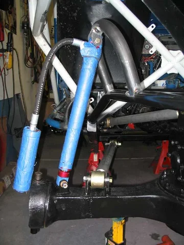

Also got started on the rear shock tower..

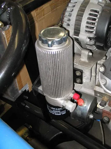

Steering reservoir mounted... Thanks GM for giving me 2 conveniently placed threaded holes right above the PS pump! (And yeah baby, I ditched that POS Fram filter for a gen-u-ine Toyota one.. It actually says "Torque Converter oil filter" on it.. My forklift repair buddy gave it to me.. ) :grinpimp:

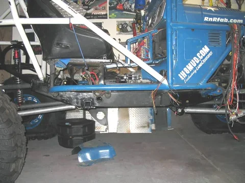

I was getting a little burned out and needed some motivation... So, I somehow managed to squeeze the tires on (the left side was ridiculous, lots of marks on the wall now, and it will take 4 wheel steer to get out of the garage!)..
So obviously, the rear shock hoops are done, the rear axle is assembled, you can see the pinion brake installed..
Currently sitting with 6" of uptravel, 22" at the frame, with the tires at 15.5" radius... meaning, once aired up, fueled and full of fluids, me, Nicole, etc.. Should be 25-26" belly with 5-6" uptravel. Looks like the springs I ordered were too stiff (preload adjusters are all the way up), but they'll probably settle in some. We'll see once it's fully put back together.
All in all, the bitch looks bad..
