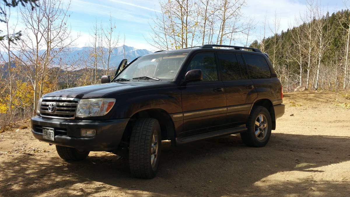

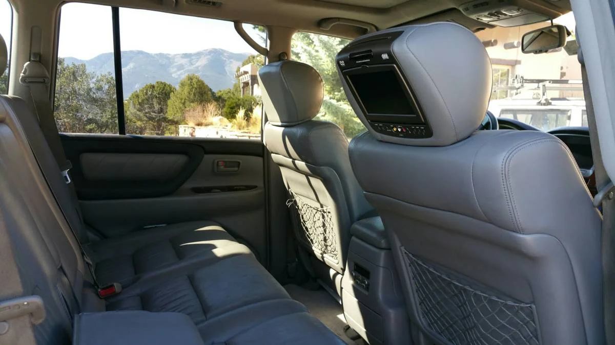

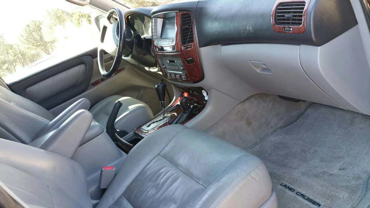

I went and bought my 5th 100 series, fourth in 11 months.
Today while waiting on PO to bring (260 miles round trip) to me, for inspection & close, I was extremely excited. I was like a child on Christmas eve waiting to peak under the Christmas tree.
I've been working hard on acquiring this one for 2 months. This was/is a very complicated deal that title will take months to clear up, so I'm at risk. Most would have walked away and many did. Everyone said don't buy it, it's to risky, just walk away. But I'm a risk taker by trade, and have done my home work.
What is really cool, is I set a goal 12 months ago to buy high mileage 100 series to learn from and restore. With the ultimate goal to work my way up (trading) to a newer model with profits form sales once restored. This one fills the goal and them some. It's sooner and with a newer model the I'd hope to get too at this point in time. I love it when a plan comes together exceeding expectations.
It has 173K on odometer, just broken in.... LOL (last three had 215k, 267K & 299K on clock). No Rust. C/TR Black Garnet Pearl (3Q2) / Gary leather. Has DVD screens in both (I'm told) seat headrest. AHC. With decent maintenance records. Leather needs closer inspect but looked excellent as did carpet.
Mechanically it's appears an 8, after 60 minute visual inspect and drive, that I'll work to bring back to a 10. If weather holds I should have properly inspected in a week or so. It has some issues I found today, but nothing known at this point concerning to me, just parts and time for normal stuff.
I'll rebuild the front end (wheel bearing, drive shafts & boots) as needed and baseline all fluids. Steering feels good. Snow tires will need to go before I can properly listen to rolling drive train, but nothing jump out at me.
Cosmetically it's a 7 1/2 that I'll bring back to 9 ++ by detail interior and perfect the paint and minor body dings. I'll work to bring back to showroom fresh as best I can within reason this spring.
I'll post some better pictures when I clean it up and take some. For now here some photos PO provided me during due diligent period.

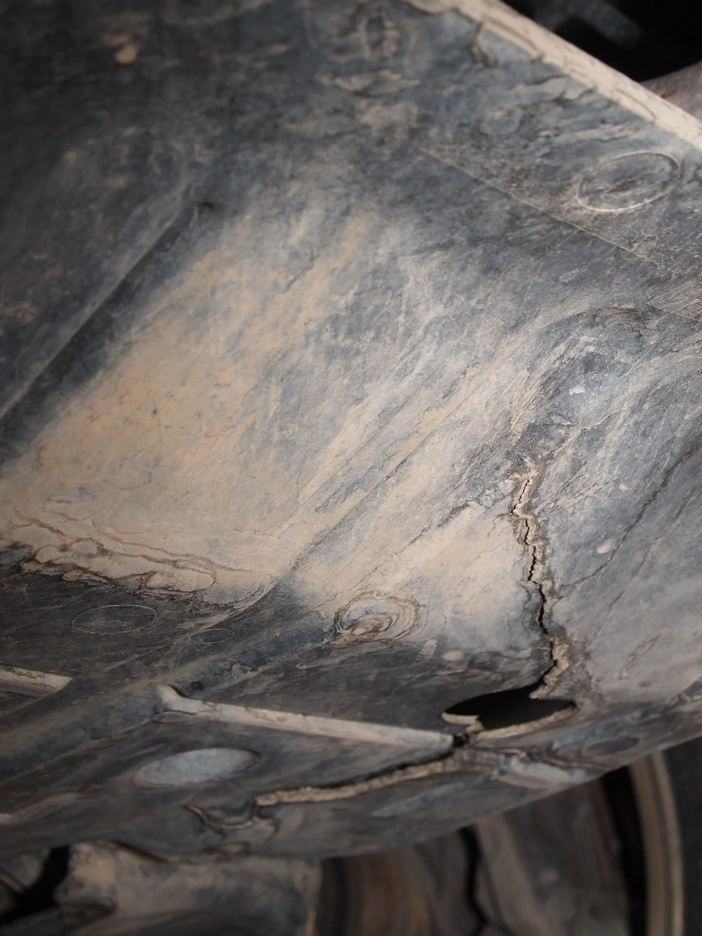

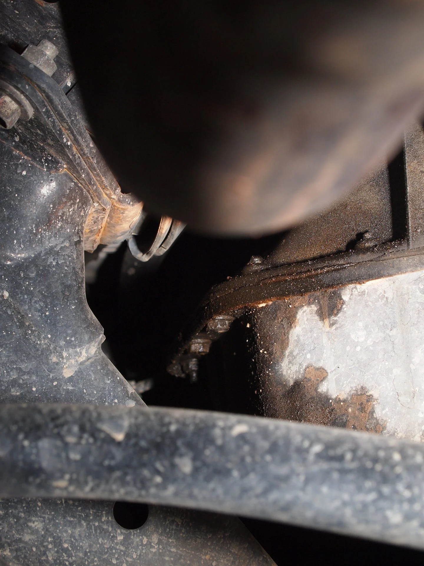

Well I was in hurry, but so far:
Both 1/4 panel and roof above windshield have minor dings & scratches.
Rear bumper need replacing.
Paint to dirty to get clear picture of condition. Should buff out nicely.
Chrome around shift on console bubbling. Indicates spillage.
At least on one interior door panel minor damage.
Speaker covers fraying.
Leather and carpet need good cleaning and condition.
Floor mat stays missing.
Back up camera giving unusable view.

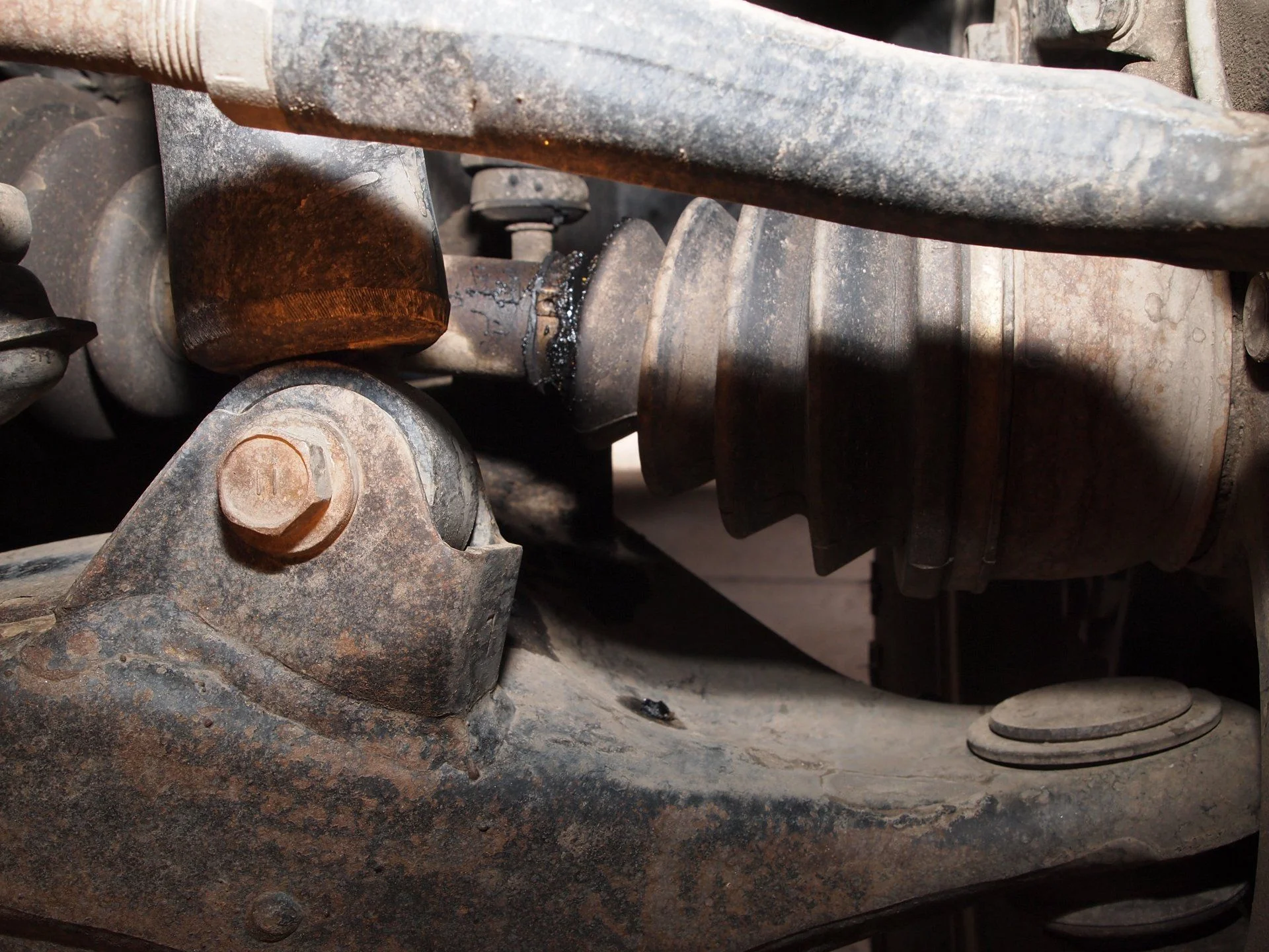

Both outboard CV boots seeping at small inboard clamp. Not much grease slung and color is black. Tighten bands or rebooting ??
Indication from pre inspection DD wheel bearing service need (there always set up wrong) Boots may be clue of bearing chatter.
Oil seen on lower oil pan DS gasket area. May be pan, from spillage during filling, head covers gaskets, oil pump or filter
Oil seen on transmission on pan gasket DS. May be from same sources ^^
Both oil drain & oil filter cover plates missing.
#2 under shield cracked.
All six lube points a little on dry side, with very little grease build up from slung off grease on frame and such.
Slight idle oscillation. Minor tune most likely.
Alignment felt just a little funny and tires have inner wear.
A very lite & interment scarping sound while rolling.
Snow tires need to go so I can feel and hear. So no clue yet on the above other the snow tires may make feel off.
TPMS light on, PO stated RH rear wheel TPMS sensor out.
Cabin fan came on what seem early during warm up. Will need to watch more closely and check coolant level.
So far I'd say the best condition out of the four in last 11 months.

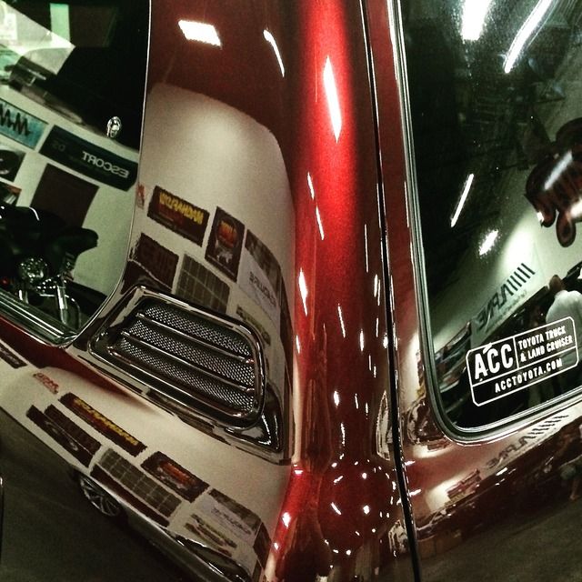

Let throw a little Garnet inspiration your way...
You are my inspiration. I told my girl friend; I didn't even like the color until I saw yours and @landylover21 's last year. With you and @landylover21 guidance, I produced a beautiful finish on the WhiteLady (01LX) that went to a needy family. It was my first detail & perfection job.

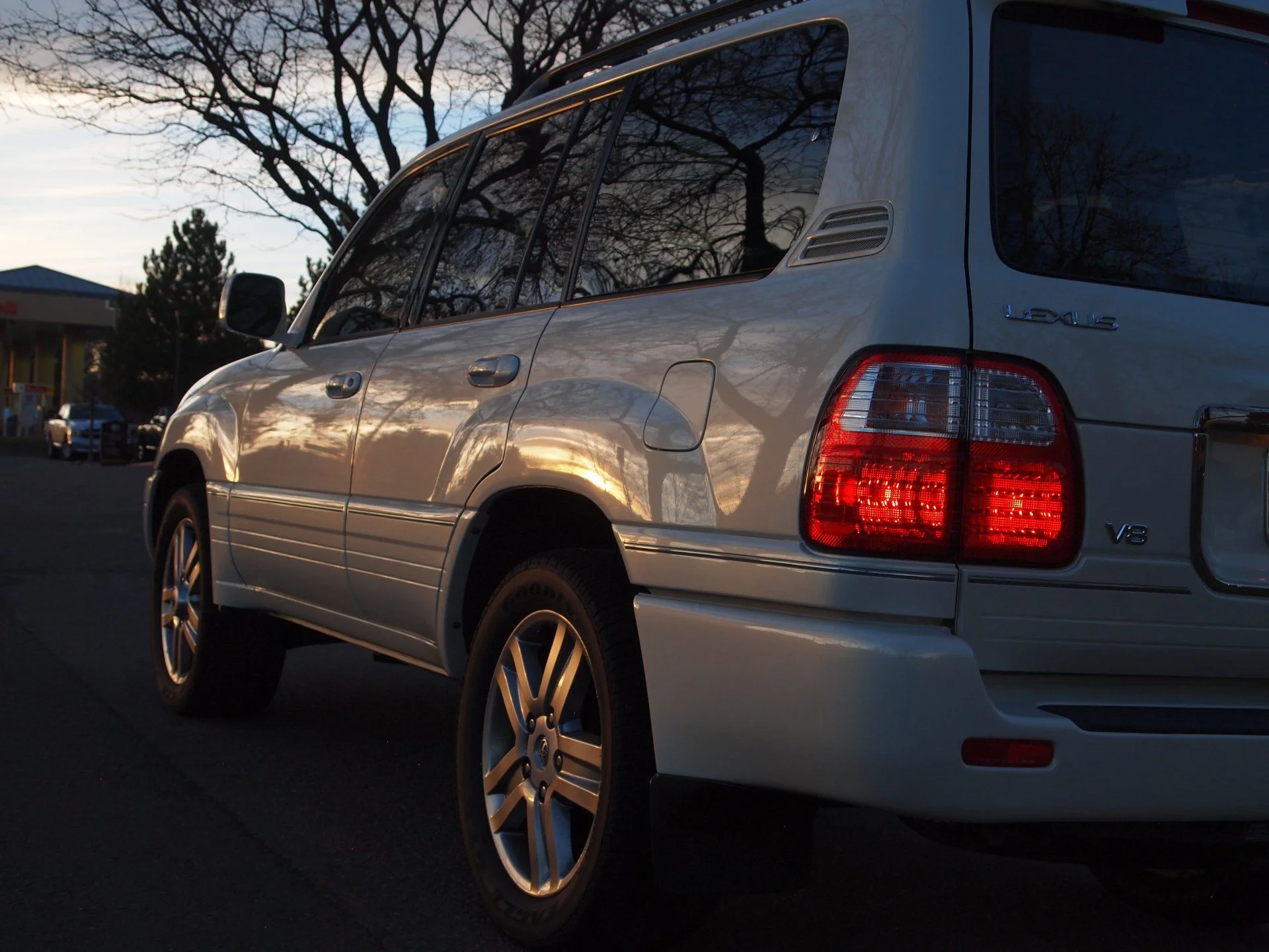

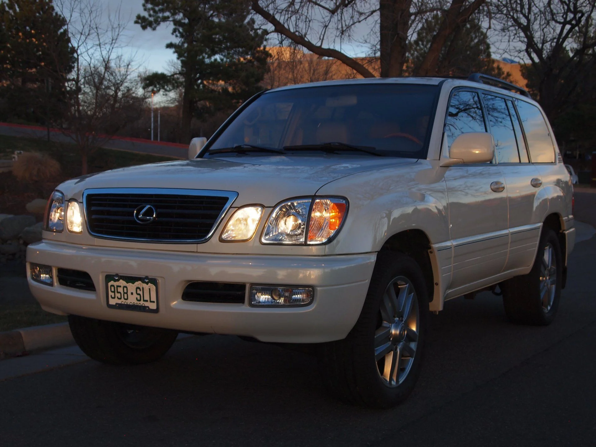

Seem to be a few of us around restore and collecting. I'll tell you, I really struggled with listing the Golden pearl white 01LX w/215K. Had it not sold in 5 minutes of listing the ad, at twice KBB, I'd still have it. It was mechanically a and cosmetically a 9 1/2 out of 10.
