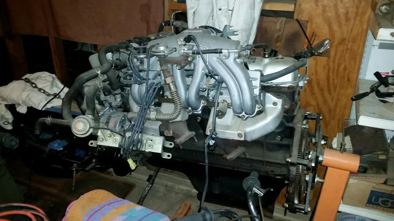

Thanks to a good deal from Tim (TemeculaTim) and some quality storage options from Pat (landcruisnman), I now have a new project to think about....
That looks either rebuilt or SUPER low miles. Will be an excellent upgrade.
Spent the last 45+ min going over your thread. Truck looks fantastic, I applaud you for keeping it relatively stock-ish looking. What are the plans for the motor? Any mods to it before putting it in?
The rig is running right now and I can putt it around town but no freeway driving I'm afraid. High rpm's is when it gets really noisy.

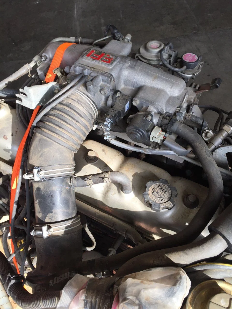

I was always planning on some kind of motor upgrade because of the lack of power. I don't need much but after driving it to Mammoth I realized any grades were trouble. The 3 speed didn't help. Now my timeline has been advanced a bit.
The motor comes from a reliable source and is in great shape. I may have the head redone and some seals too but as it sits it's very clean. So no determination on that yet.
In a perfect world I would add the 3FE to the 3 speed column shift and add a 60 series power steering setup. Drive it like that for awhile. Then after confirming column linkage fit I would start on a 4 speed column shift setup I've been considering. If that becomes a no go at any point I would just use a speed floor shift.
Either way it's going to retain the stock-ish look. I enjoy the "fresh off the farm" look and don't want to lose that even if it's got something newer and Toyota under the hood.
Don't hold your breath on this project though... the motor was palleted, wrapped, and forklifted to a safe overhead storage location.
For now...
No reason you can't put the 3FE in front of the 3-speed. It will bolt up.
