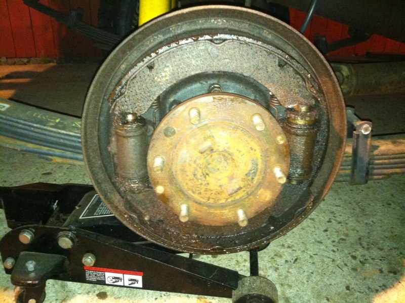

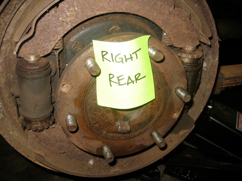

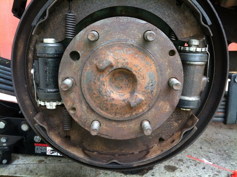

The right rear wheel cylinder(s) have been leaking for awhile and have gotten much worse over the last few weeks. I haven't driven her much more than to Home Depot to pick up some wood for a deck, and the occasional trip to work when I don't mind going slow. Tonight I decided to pop the rear wheel and see what's up...
:confused::confused::confused::confused:
hmmm... where the hell's the rubber!!??
Drivers side looks fantastic and completely rebuilt. WTF!!?? So I re-read through this thread and I remember this side was the one with the broken bleed nipple and I was GOING to get to it once it started leaking??
Really?? From post #29... (NO RUBBER THEN!!!!). :doh:
Ha Ha!!! What a dumb ass. Well at least it took this long to start leaking noticeably!
Uhhhhh....I was just trying to free it up...
:grinpimp:

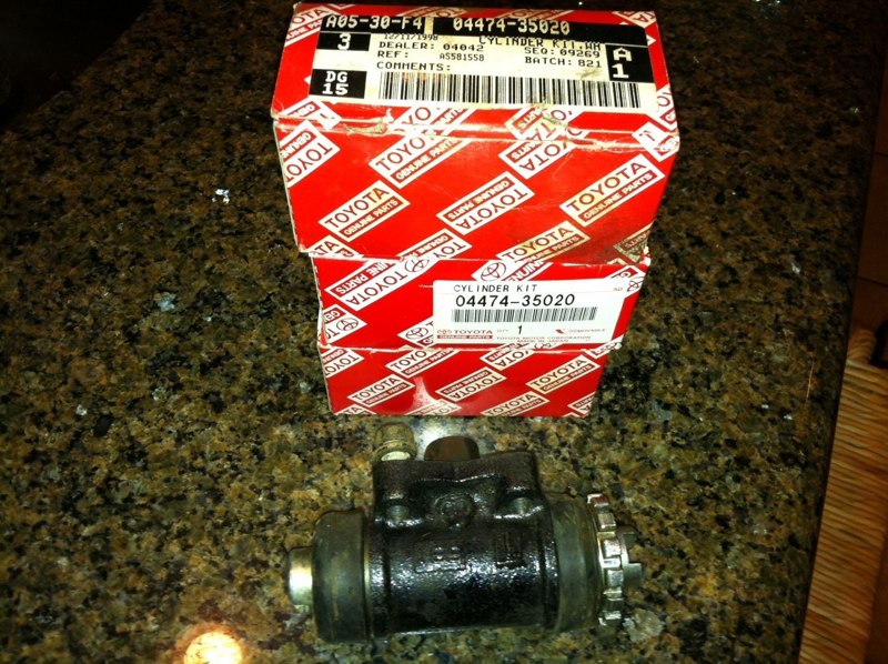

I'm going to dig through my brake parts box and find a rebuild kit. I think the 69 kits work?
EDIT: Forgot to look in my 45 box first. I have these...
I know the cylinder is a rear, I'm going to have to match the parts in the morning to be sure the kits are for the rears.

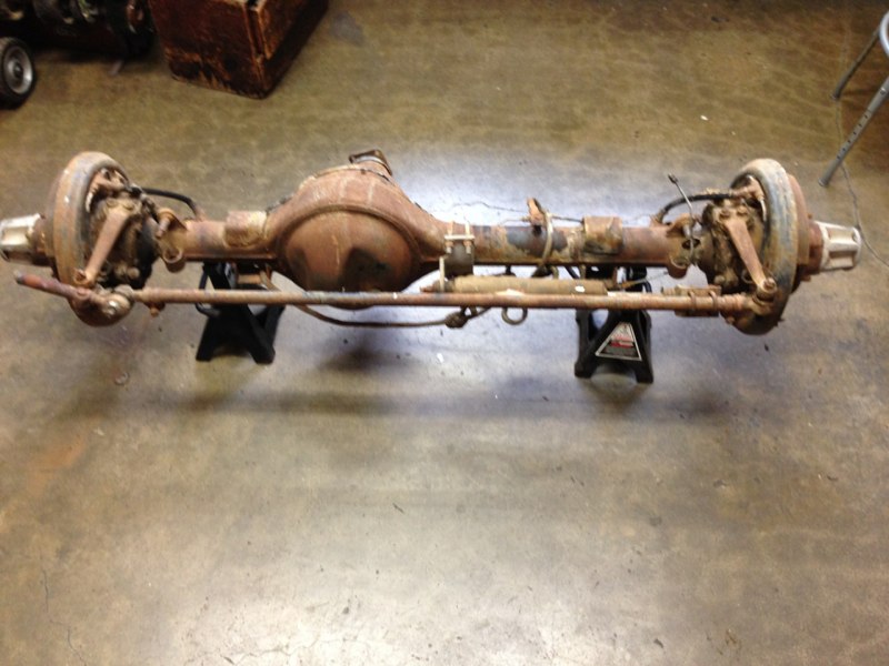

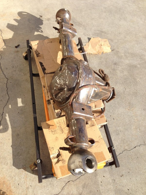

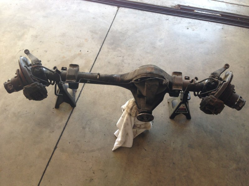

Donor early axle (Thanks Rob and Brett)...
Broken down and wire wheeled...

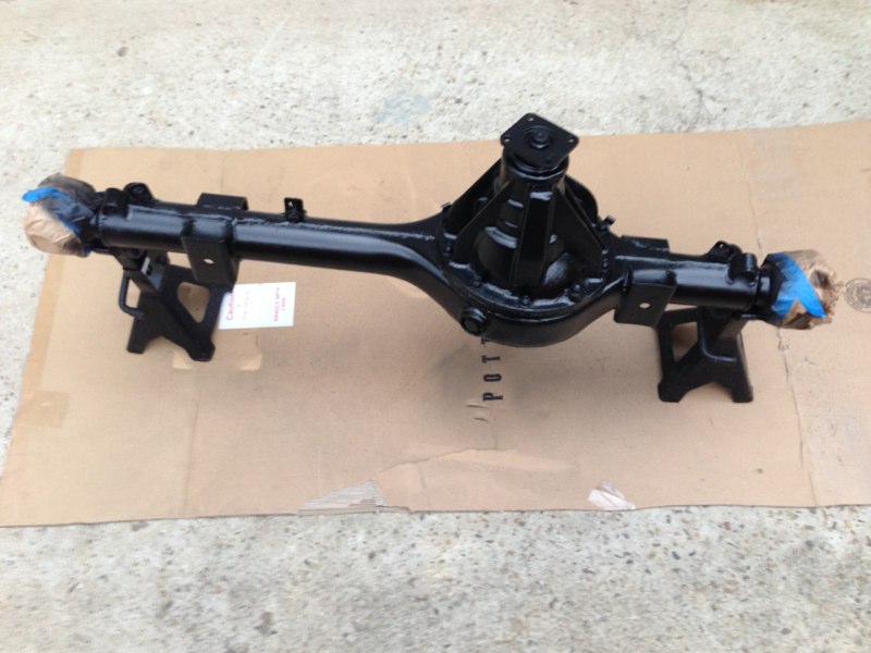

Painted and ready for rebuild...

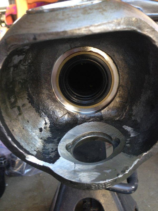

Donor 60 series axle...
So are you using 60 hubs with the 40 axle?

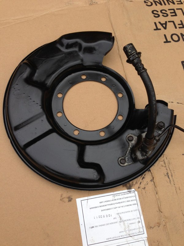

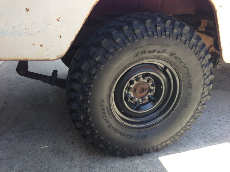

New OEM wheels (welded) to clear calipers...

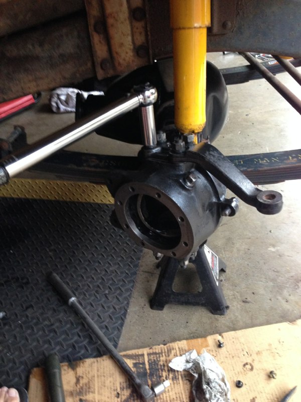

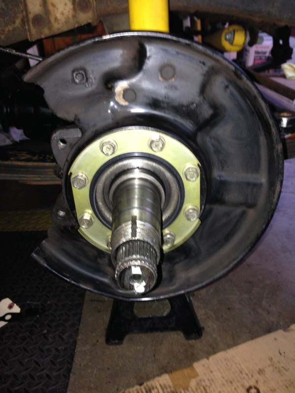

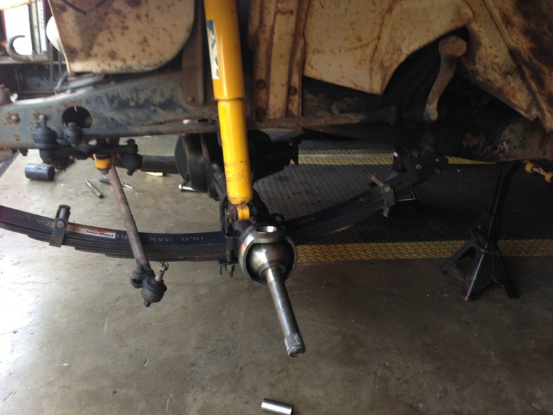

Axle housing ground to fit 60 series birfs...

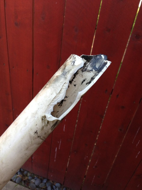

I got my ass handed to me trying to separate the axle shafts. I've used the PVC method many times but went through about 12' of 1.5" pipe before I went over to Noah's and used his metal pipe. Reattaching is a two person job as well to get the c-clips on so he helped with that also. :clap:
I had no major issues with reinstalling the lug bolts using the BFH method...

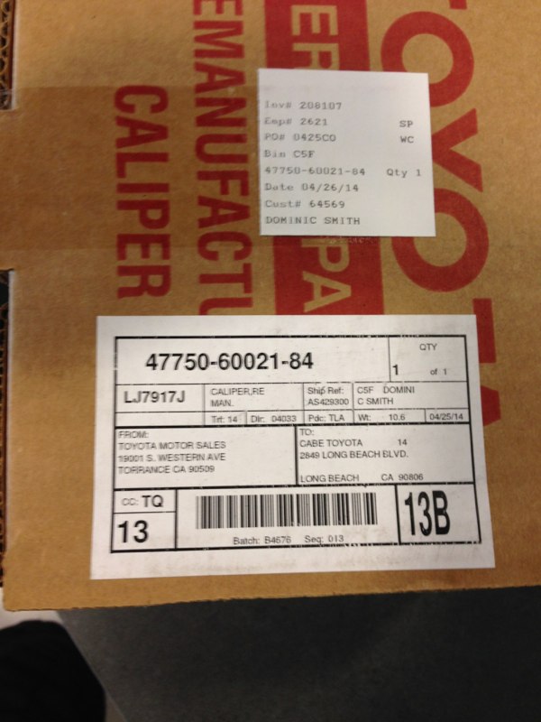

Reman 60 series calipers....
