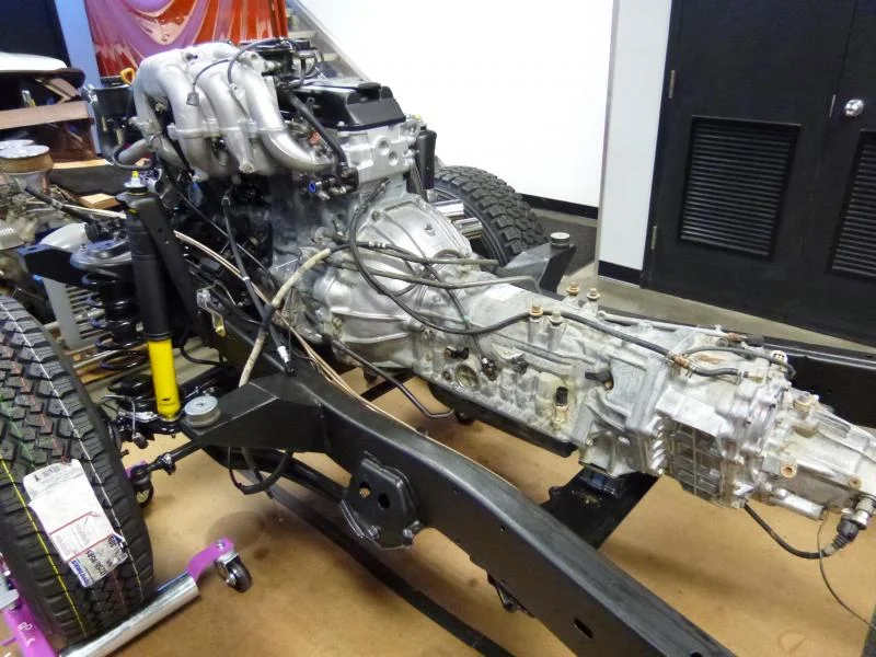

Motor and trans came together....motor/trans went into frame. Cab should get popped on tomorrow...hopefully. Please shield your eyes from the crapbox J**p in the background. A true tragedy that the Land Cruiser has to park next to it....

Cab went on early today....going to pick at the motor wiring harness, fuel line connections, master cylinder/brake lines...maybe start thinking about the exhaust routing once the fenders are on....

Finished running the harness for the motor this week. Had the rear driveshaft extended.....balanced the front, replaced a couple of u-joints. Should be good to go.
Got to work on the exhaust system....finished the downpipes, the rest will be pretty easy. Merging the 2 dowpipes into a 3" collector then into a 3" 200 cell cat....over the frame and into the straight thru stainless Magnaflow(went with the longest one they had...36")....I don't want the truck to be loud so I may add a resonator in there somewhere. Didn't want a chambered exhaust either....this seemed like a good starting point. I'm going to make the system modular with v-band clamps. Easy to remove or get out of the way should I need to....makes it nice to install too. I'll ceramic coat the headers and probably do the downpipes in thermal black to hide them in the wheel well a little bit. I tried to tuck them up in there the best I could(they look way more tucked in person).....it's kind of a mystery as to how this truck will settle out with it's springs(using the stock FZJ80's for now). Maybe a set of no lift OMEs which should be good for another 3/4" over the tired FZJ80s. I'll figure that out later I think. I have to be really careful....the truck is approaching the height of my garage opening at my house. Can't leave this thing outside...
So next week we'll finish the exhaust and weld up all the pieces....maybe get to work on the fuel tank cradle.....then we start to move inside I hope. Had to order a few heater related pieces this week(valve). I'd like to get the front end together next week to start sorting out condenser placement, trans cooler, final radiator placement, fan stuff, blah, blah, blah. Just when I think I'm making progress I start thinking about the seemingly never ending remaining stuff.....kind of fun.
