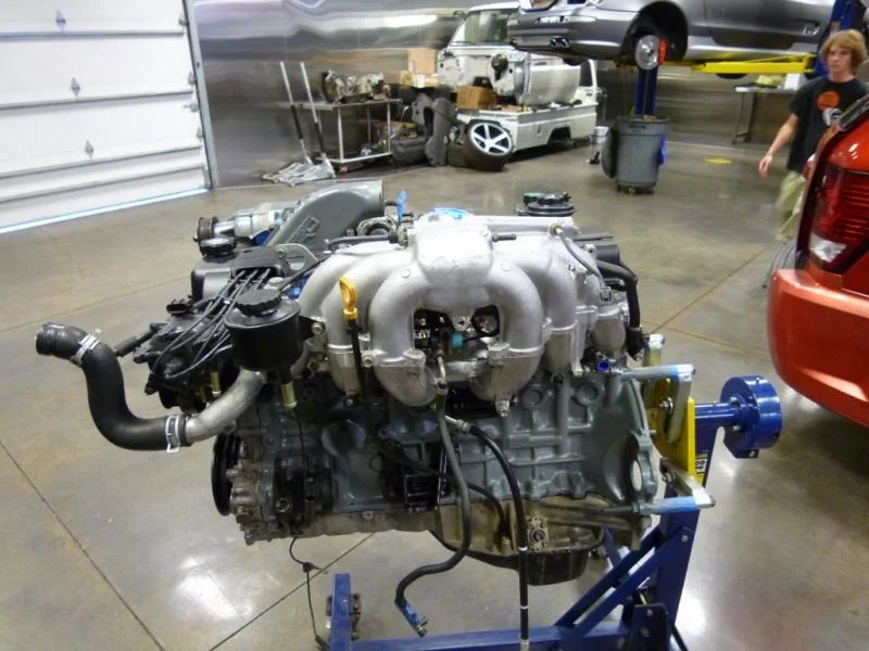

Motor is nearly done.....couple missing gaskets and small parts. Not a big deal. Goal is to get the motor trans in the frame next week so the cab can be mounted and we can begin plumbing brakes from MC to chassis ports, building the exhaust, figuring out the shift lever situation and probably 2000 other things. Fun.
Mocked up the supercharger today as well since it was quiet....I bought a used kit and it didn't come with all the parts. Probably a mistake....should have bought new I suppose but it was kind of an impulse buy. I'm sure I'll still be ahead of the game by the time I get all the parts(needed the crank pulley and the tensioner from TRD...very expensive). One of the missing parts was a heater bypass from the thermostat housing....we're going to install an AN adapter and route a line up and over the supercharger.....TRD doesn't list that part separately. I'm going to paint the blower parts next week I think too...they're a little beat up and tired. I'm in a textured black mode these days so I think I'll do it in that.
No surprises on the motor....it was exceptionally clean and free of any issues. Probably didn't need anything more than a head gasket but while it was out and we had the time we did a complete re-build. Used all OEM parts....hope it lasts for another 173K without issue. I think my motor had been well taken care of....appeared to have all OEM parts on it(even the filter).
