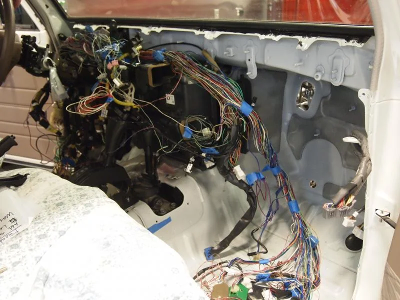

Up to our eyeballs in wiring on the project now....maybe, just maybe there is light at the end of this tunnel. Looks like the gauge cluster is pretty much squared away...we were able to set the 24V 79 series gauges to the 12v 80s series sending units...all gauges function as they should. Speedo was a swap out(kind of), tach was a combo of the 79 and the 80....we will probably have to calibrate that once we're up and running. We messed around with some of the lighting too....got it very nice and uniform across the gauges.
I ended up buying a cowl wiring harness from a diesel mine truck that we'll part a few things out of that we desperately need(mainly connectors)....because the 80 series instrument cluster has a lot going on with it, my tech is going to feed the 79 series cluster with the 80 series inputs. We're working on breaking down the 80 series cluster so we can make a nice piggyback type harness between the 2. Should work out pretty well. Hopefully.

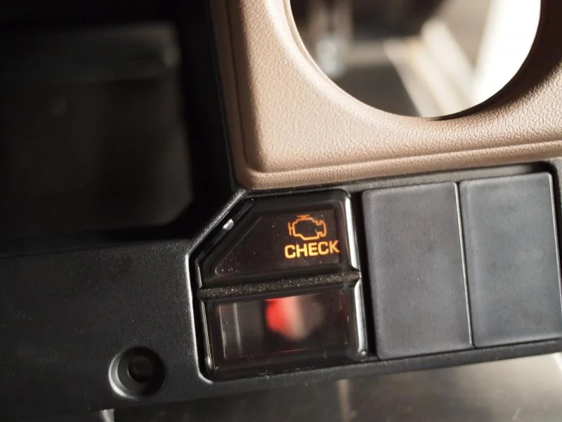

Going to add some of the dash indicator lights to various parts of the 79's instrument bezel where there aren't switches...started with the CEL light....others to follow. I'm sectioning out pieces of the 80 series warning lights. The 79 series gauge has 5 or 6 openings for warning lights.....not going to cover all the ones I need on the 80 series. I might end up having to make a few custom ones up to fit(80 series icons are bit big for the 79 series openings).
Harnesses are pretty much run in the front of the truck, need to work on the cab and then run things out back......very tedious work to get everything just right. I also decided to use all OEM Toyota plugs so that makes things a little more challenging....

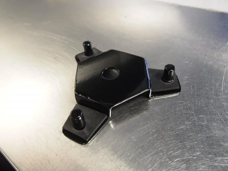

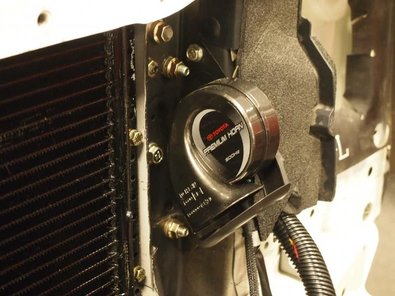

Finished up the spare tire holder....cool shot of the horn. Need to get a video of the truck running.....

That horn is the nuts, I want one! :)

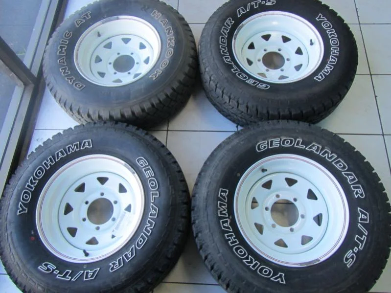

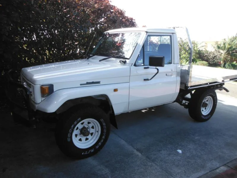

Forgot you were using those wheels on the truck, sorry. I don't want to offend you but have you considered a better looking steel wheel?
Ha.....I love my wheels. I've had silver steel Tacoma wheels on it, aluminum 4Runner wheels on it but once I bolted one of these on to test it, I was in love. They're EXACTLY what I consider perfect for that truck....my opinion of course. Maybe one day the 4Runner wheels will go on it...they look kind of good on it but for now, steel wheels.
I was thinking the classic Sunraysia steel wheel like these....
