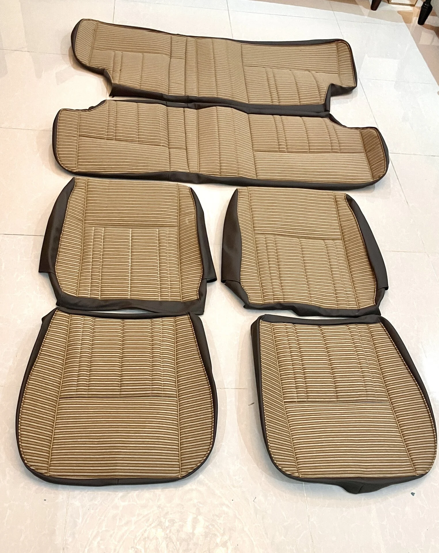

Any details on those seat covers? (maybe i missed it from before)
We’re working on the templates this week. I’ll get you a price tomorrow!

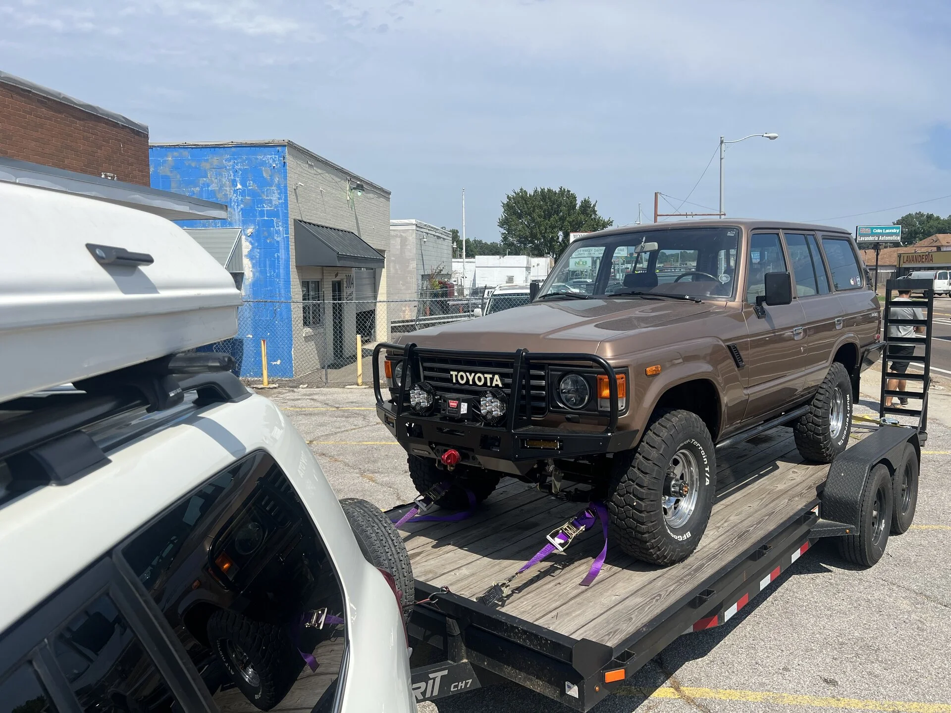

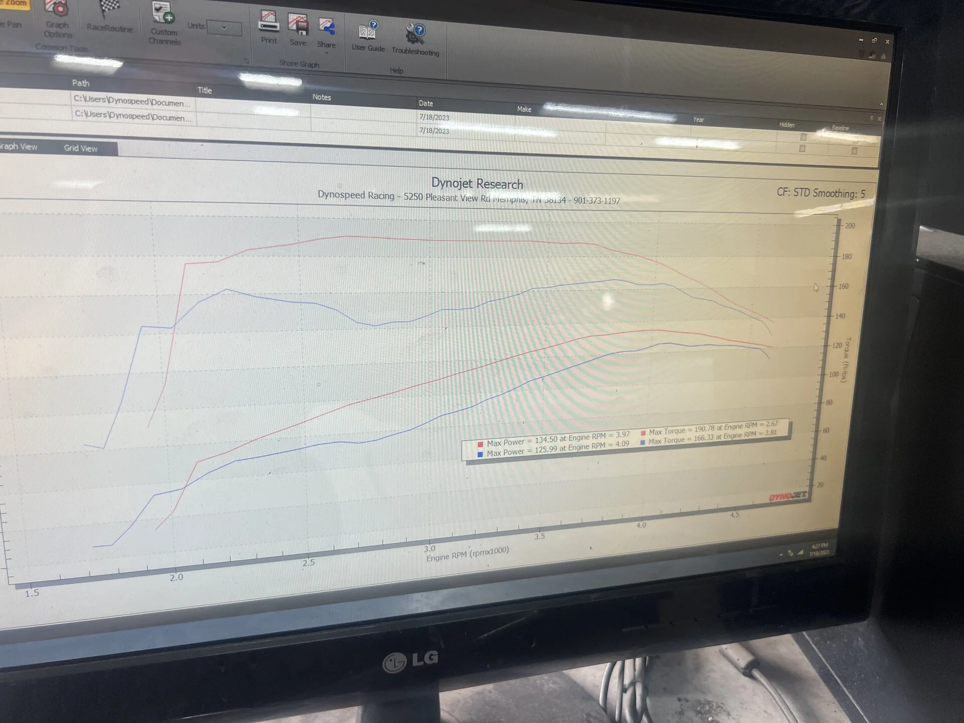

To get the most out of this Cop motor and Hyperspark @FJ60Cam booked a spot with the local dyno next week. I’m headed out of town tomorrow so I had to make the drop at HQ today. It’s also nice on a project of this scope to have a team you trust do a QC check before it goes home. Win win.
Nice! will you post the dyno results?
Man. This thing is really bad ass. By far the most powerful 2F 60 I’ve driven. This Hyperspark one dyno tuned is really unreal.

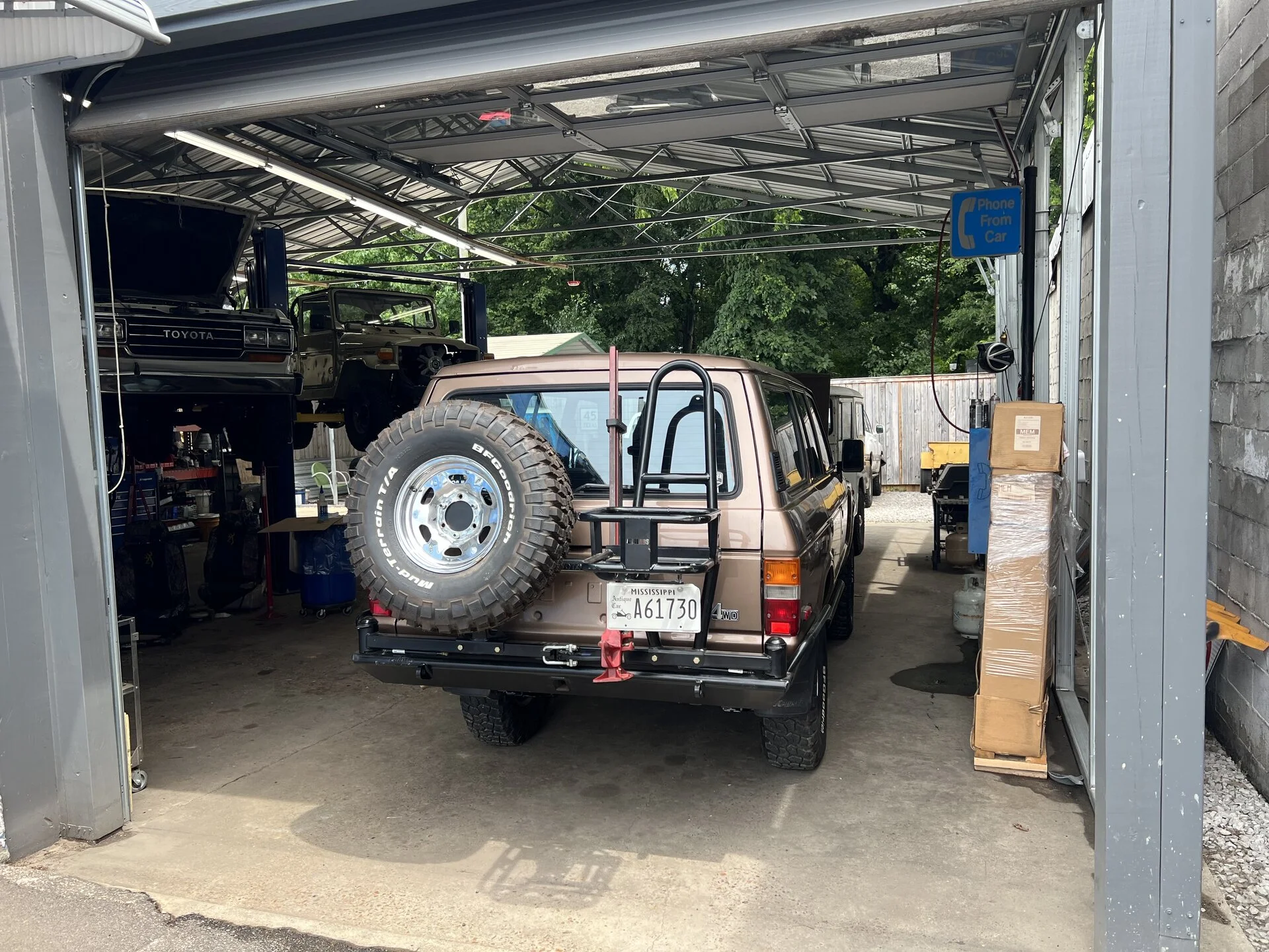

Appointment with the stereo shop on Monday and when they are done this one will be ready to go home.
Cam is still waiting on all the dope from the dyno tuner to post up the data. They have been down from internet all week.

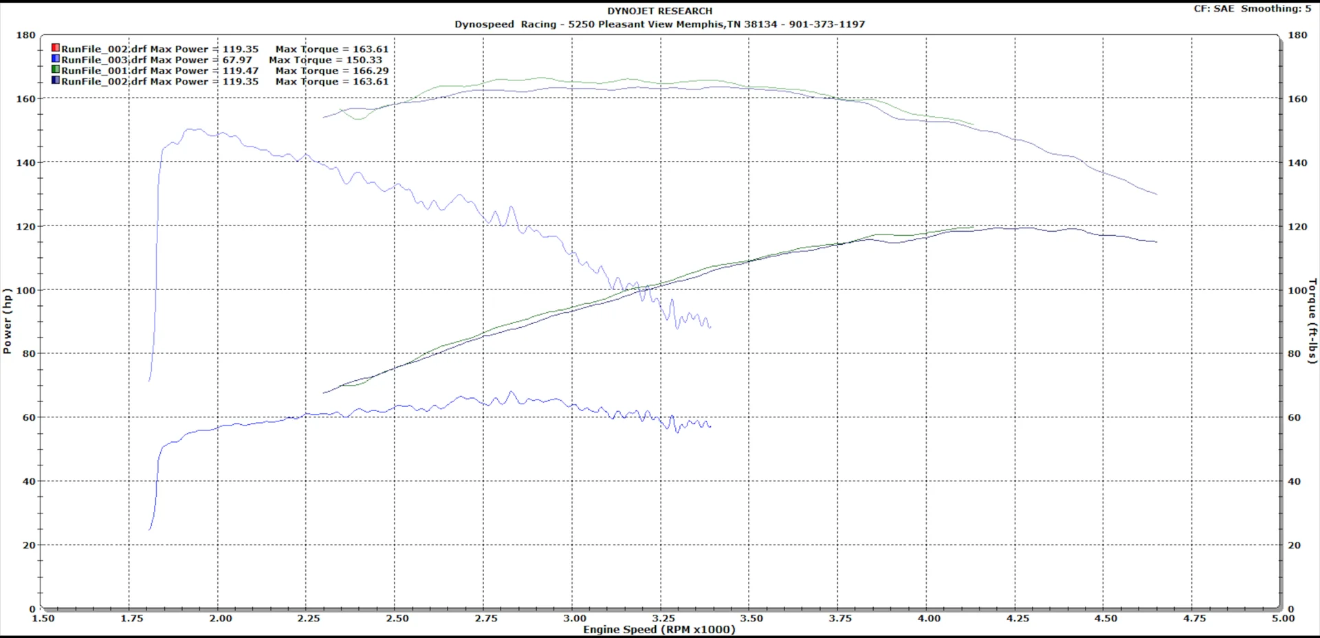

Sooooo…….this old dyno sheet from 2019 was when we tested a stock 60 versus my cop motor fj55.
The 60 put down 68 Hp at the rear wheels.
The Cop Motor did 120…..
This one did quite a bit better.
Here’s a “screenshot” of JTU’s dyno. The bottom run is how it rolled in (with a tune we loaded from a different motor) and the top is the final tune.
Final numbers: 190 ft-lbs @ 2670 rpm and 135hp to the tires. That’s pretty close to the published crank numbers (200/135).
There’s 175+ ft-lbs on tap from 2K all the way to redline.
Took the 60 on my longest to date drive down to Florence at Audio Solutions. It’s getting a Retro Audio head unit. Some 6.5 rear speakers in the panels. An amp. A removable subwoofer setup.
