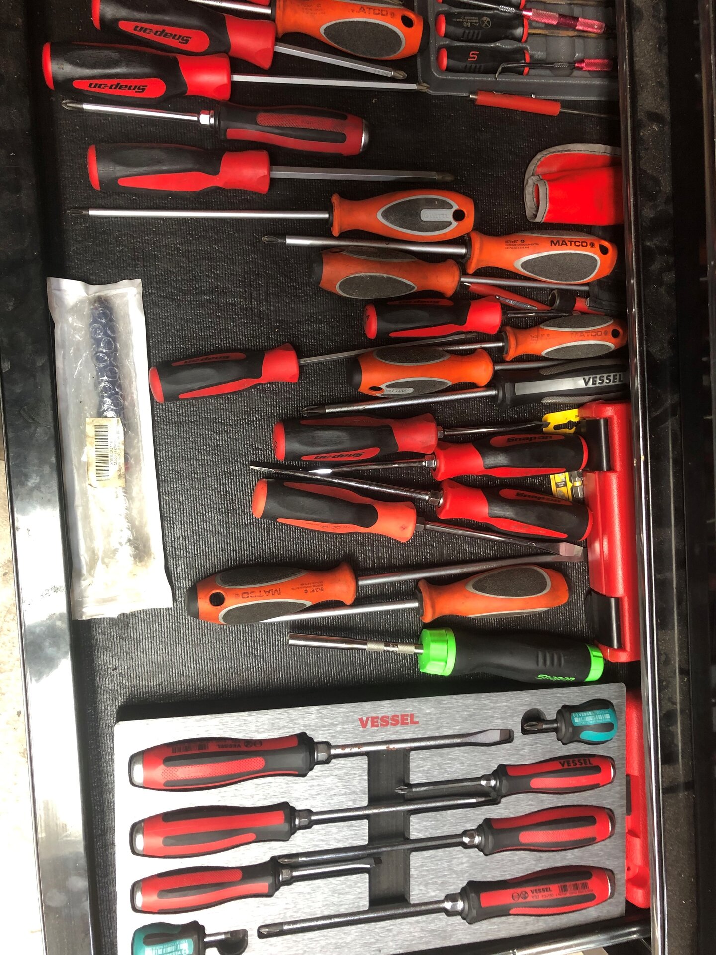

FJ40 factory cross-head screws are Japanese Industrial Standard (JIS) not Phillips. Get yourself some JIS screwdrivers and a JIS impact driver. Vessel is a good brand, but there are others as well.
I never knew that they weren't standard Phillips head screws. When I rebuilt my '70 from the frame up in '88 I thought they looked very standard. I will say, the impact driver became my best friend. The hinges around the vehicle were the worst...

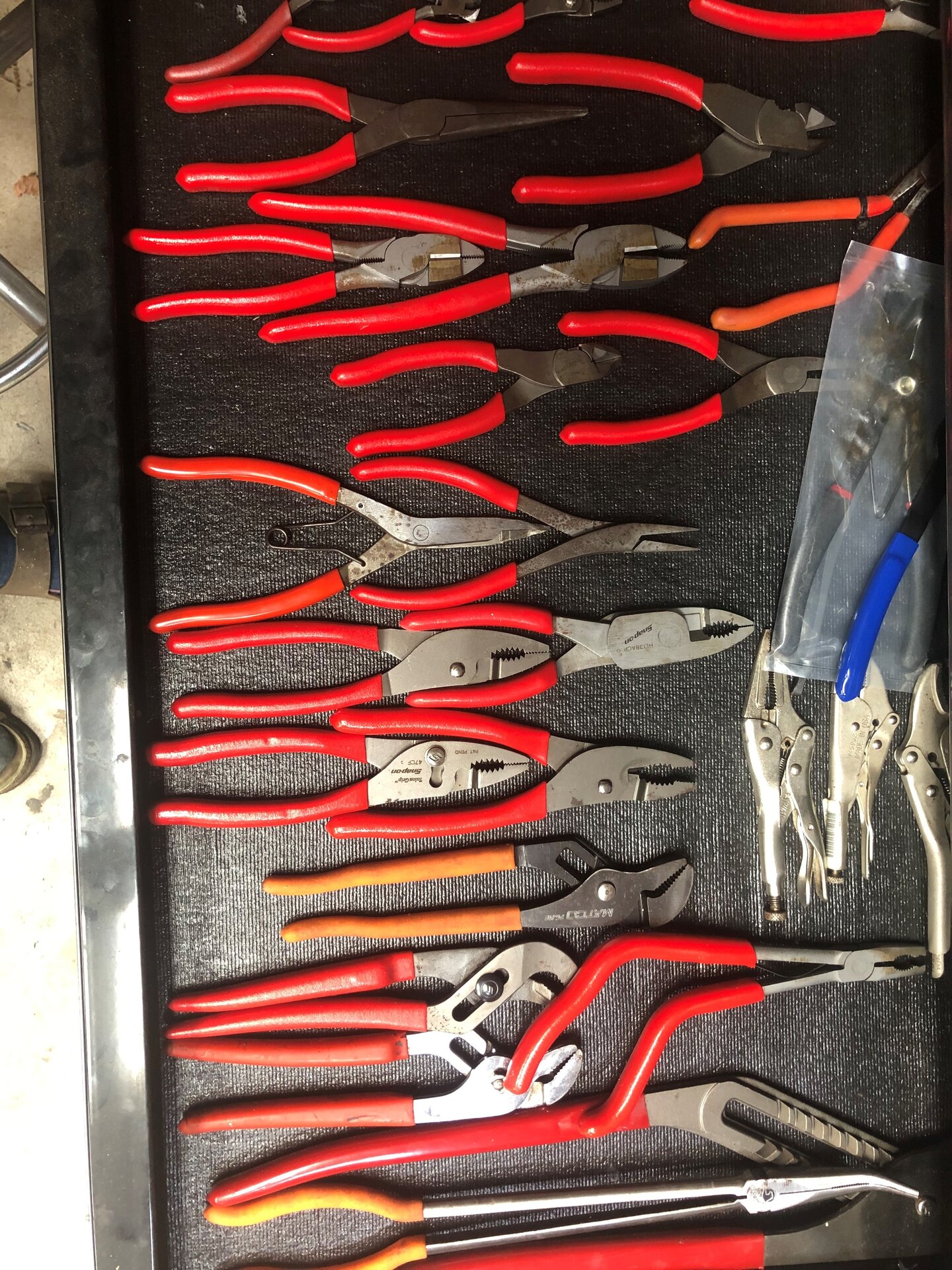

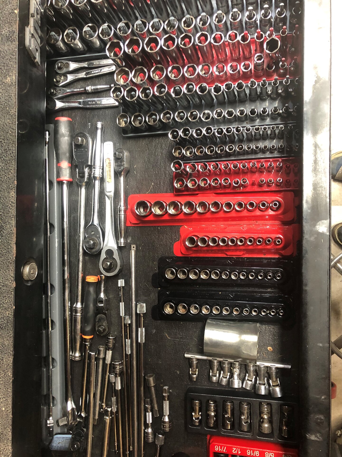

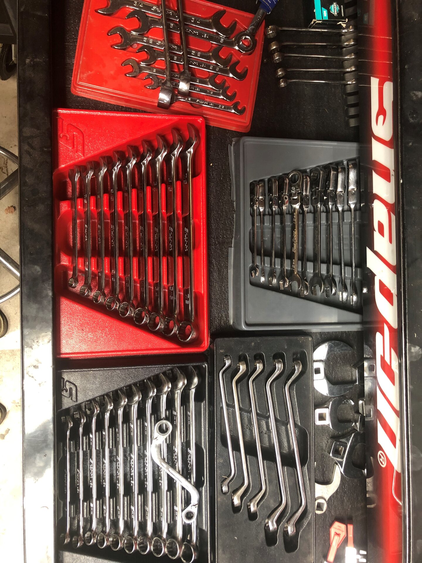

Metric tools keep getting mentioned, and yes, of course you’ll need those. However, we shouldn’t discount SAE tools as well.
PO hacks, field fixes, gm conversions etc… you will be needing sae at times.
Socket sets are a whole other story: regular and deep, 1/4, 3/8, 1/2 drives all come into play. Universal joints for all. Extensions for all.
Then box wrenches, ratcheting wrenches, crescent and pipe, oil filter wrenches…

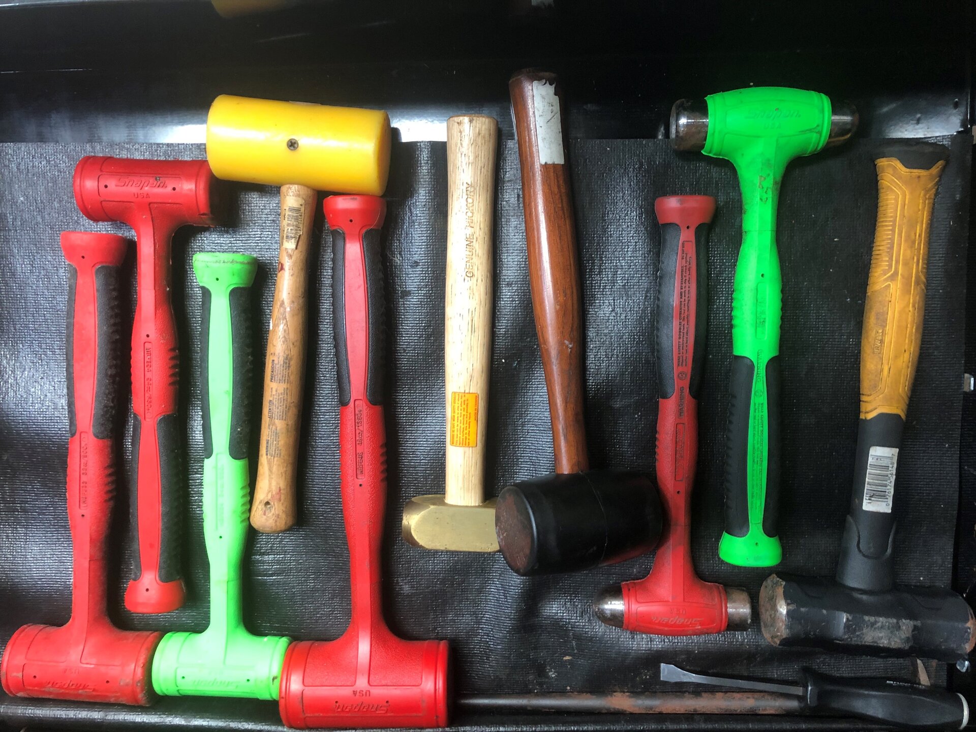

Tape measures, feeler gauges, dental picks, files, hammers of all sort, spring punches, drifts…
You could hijack a snap on tool truck and still be missing something.
