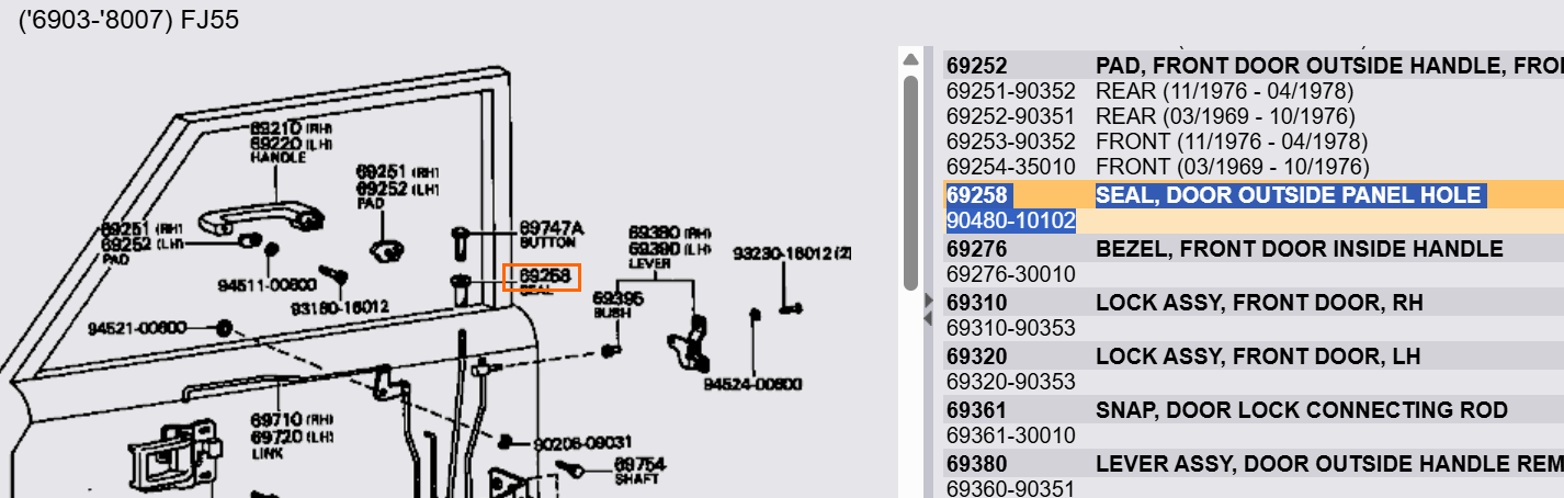

2. Door lock knob bushings. The little insert that goes in the hole so the door lock knob doesnt just bang around. Any source on those?
Yes you should put plastic using butyl tape around the edge. OEM liner is NLA. I understand that shower curtain liner material works well.
lock knob bushings still available from Toyota:

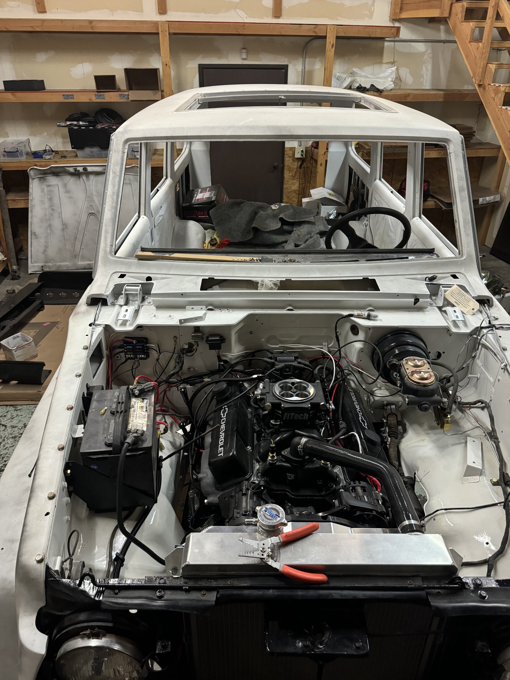

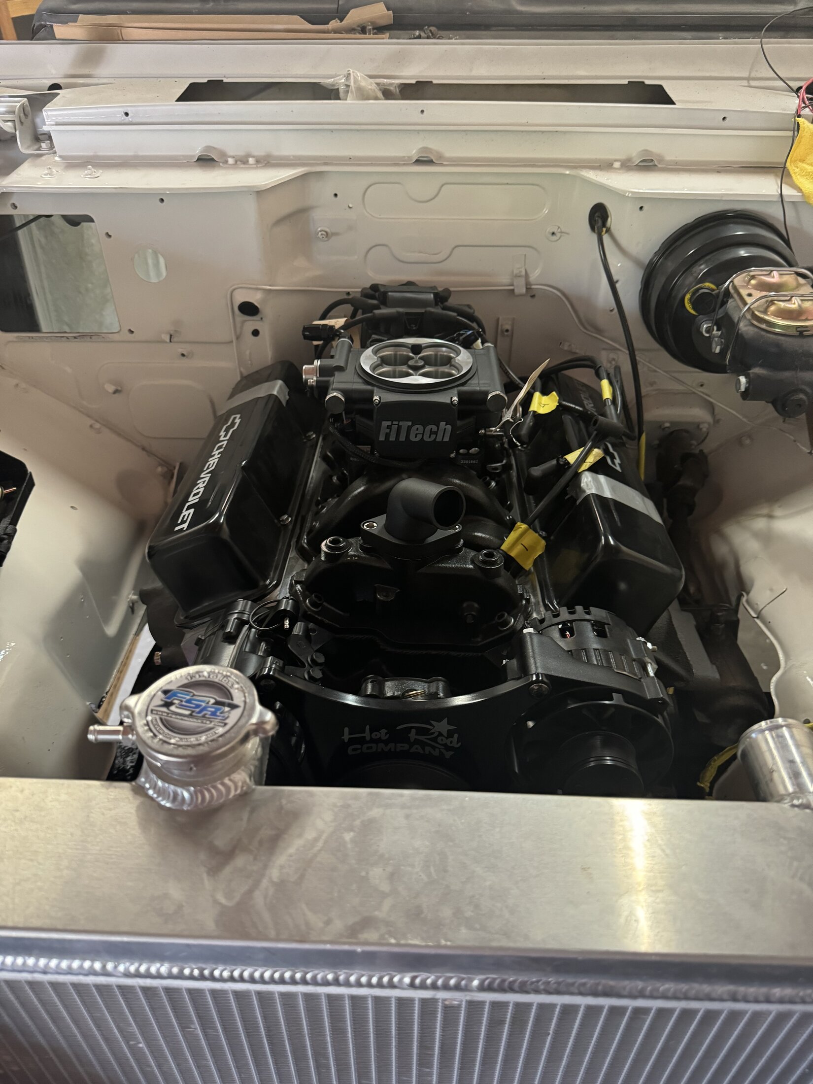

Someone started restoring it and got the two front fenders fixed up, then gave up. Then a guy in our area here in Northern California bought it and reassembled it to flip it. I picked it up, with wild dreams and aspirations.! Quickly realized it was underpowered and impractical. I almost gave up at that point but with the encouragement of two mud brothers I went all in. Anyways, it’s coming all together and will hopefully be starting it up here soon, then it’s off to exhaust and then to the upholstery guy for headliner and carpet. Here are a few more pictures.
It doesn't look underpowered any more!
Spot on for both questions.
