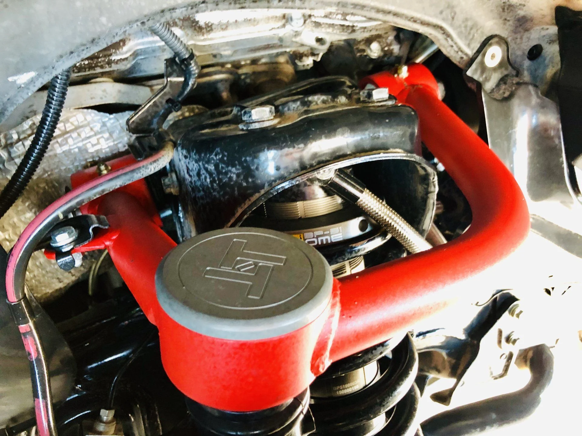

The truck is ready for vacation. Here are some gratuitous photos of the stout TT UCAs and the truck sans roof stuff.
