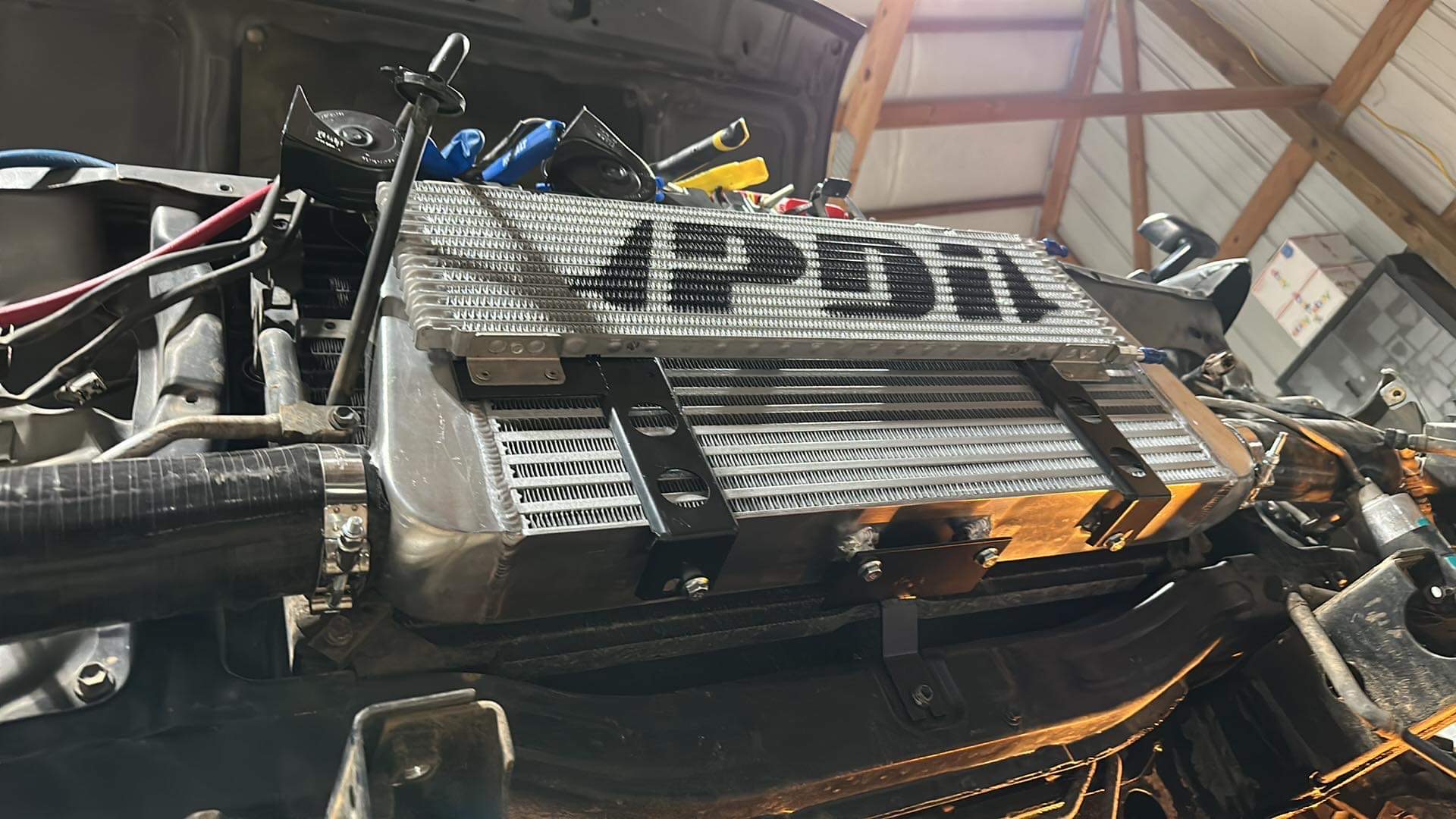

Trimmed down the lower IC hoses using the old hose clamp guide method -
The instructions mentioned I might need dish soap but it's all gone together easily.
Then I realized I should orient the hose clamps so they can be accessed when the car is reassembled and all this is blocked by the grill and headlights, so I reassembled everything.
Passenger side:
Driver side:

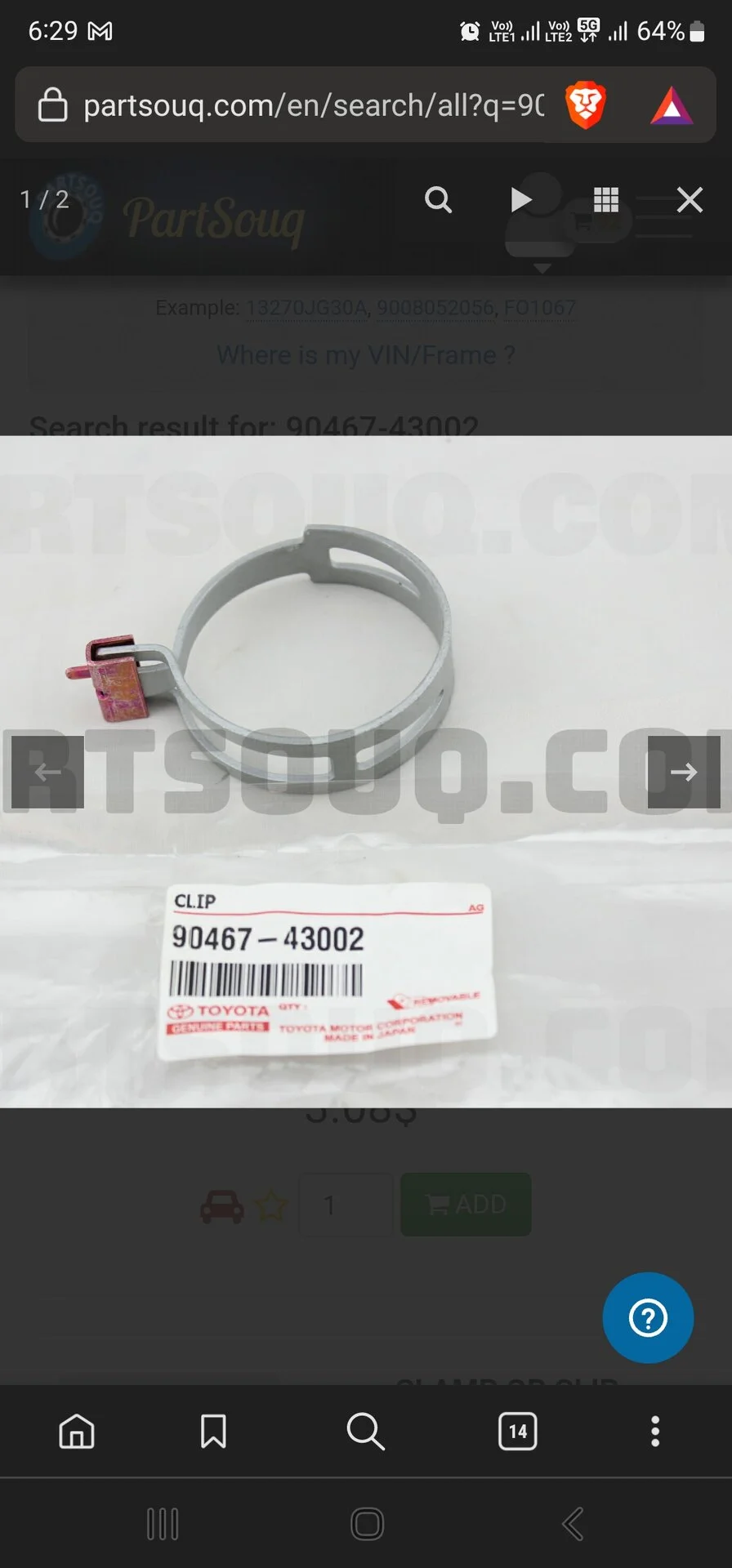

But on the lower, I ran into a problem. From the Partsouq diagram, I ordered 2x 9611110490.
It fits great on the radiator side, but on the water inlet side where the hose is larger it won't fit. This measures 50mm ID fully extended, probably need just a couple more mm to make it work. Any ideas before I just use a breeze clamp? Is there a slightly larger OEM hose clamp?
Working on wrapping up the intercooler install and ran into a snag there too. The pipe going to the turbo needs to route exactly where the intake PCV hardline is.
I have a PDI airbox on order so it's not the end of the world, but that won't be here til August or September. In the meantime I'm wondering if I should just chop off the hardline and plug the hole.
