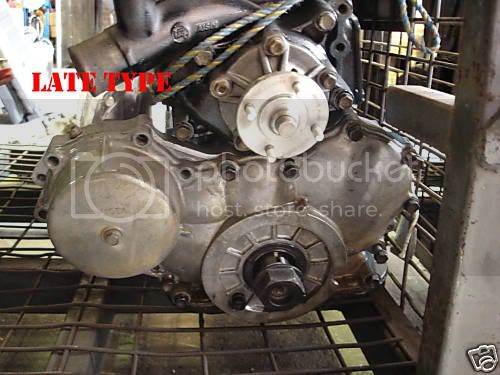

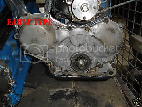

Theres a casting number on the side of the block sorta just behind the oil filter. Early (80-84) will have 58010, and late 2h's will have 58020/58030. Also, if you can get a picture of the front of the motor, the timing cases were different between early and late 2H's
Image of the early doesn't seem to want to work, but it doesn't have the bolt in the middle of the LHS of the timing cover, and is shaped differently around the crank
