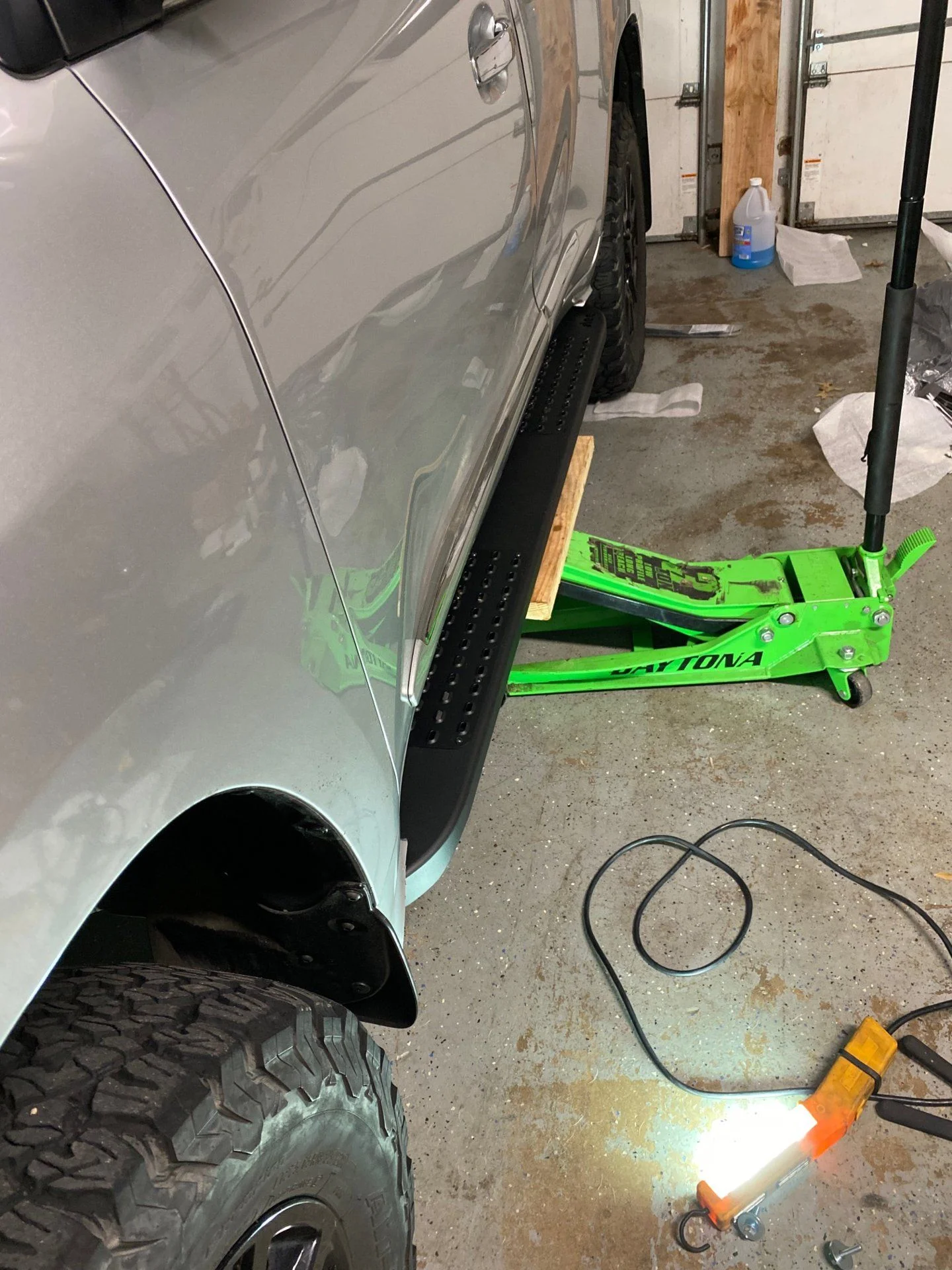

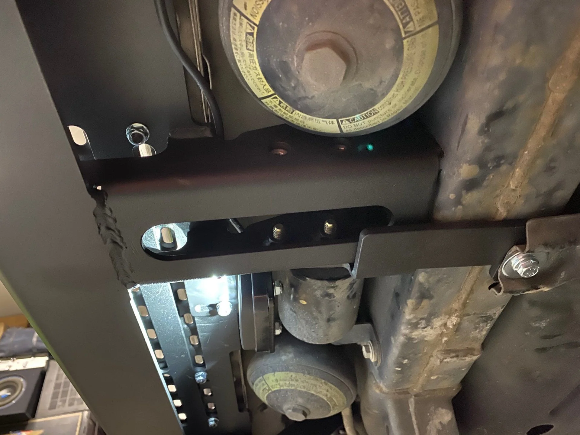

Thank you for your notes and tips. This thread and grinchy were very helpful. I just installed my sliders yesterday and it went well. The instructions were much improved and clear. The only tips I would add are to install the led light brackets last, they get int the way. Also, your run taps through the welded bolts on the step to clean up power coat overspray as your first, much harder to do once they are mounted.

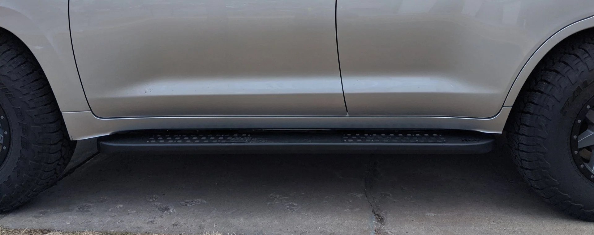

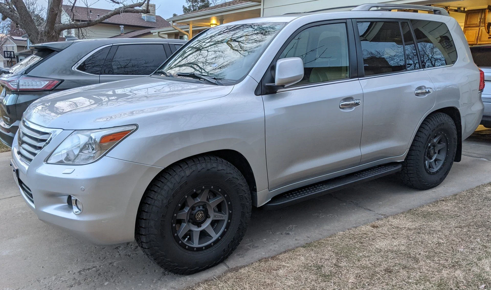

Do you have a close up of the full on side shot of the slider to show spacing? I had mine on a jack with all hardware loosened and could not get the slider to go up anymore.
Also, how is the positioning of the slider front to back? I tried to get it to slide all the way forward but it seemed to be centered on the horizontal slots used for hanging the slider and all the holes lined up but it seemed like it should be able to go more towards the front of the truck?
I didn't notice at first but you're correct, it isn't centered front to back and there are no adjustment options. I'm okay with it as the step is functional where one would need to step.

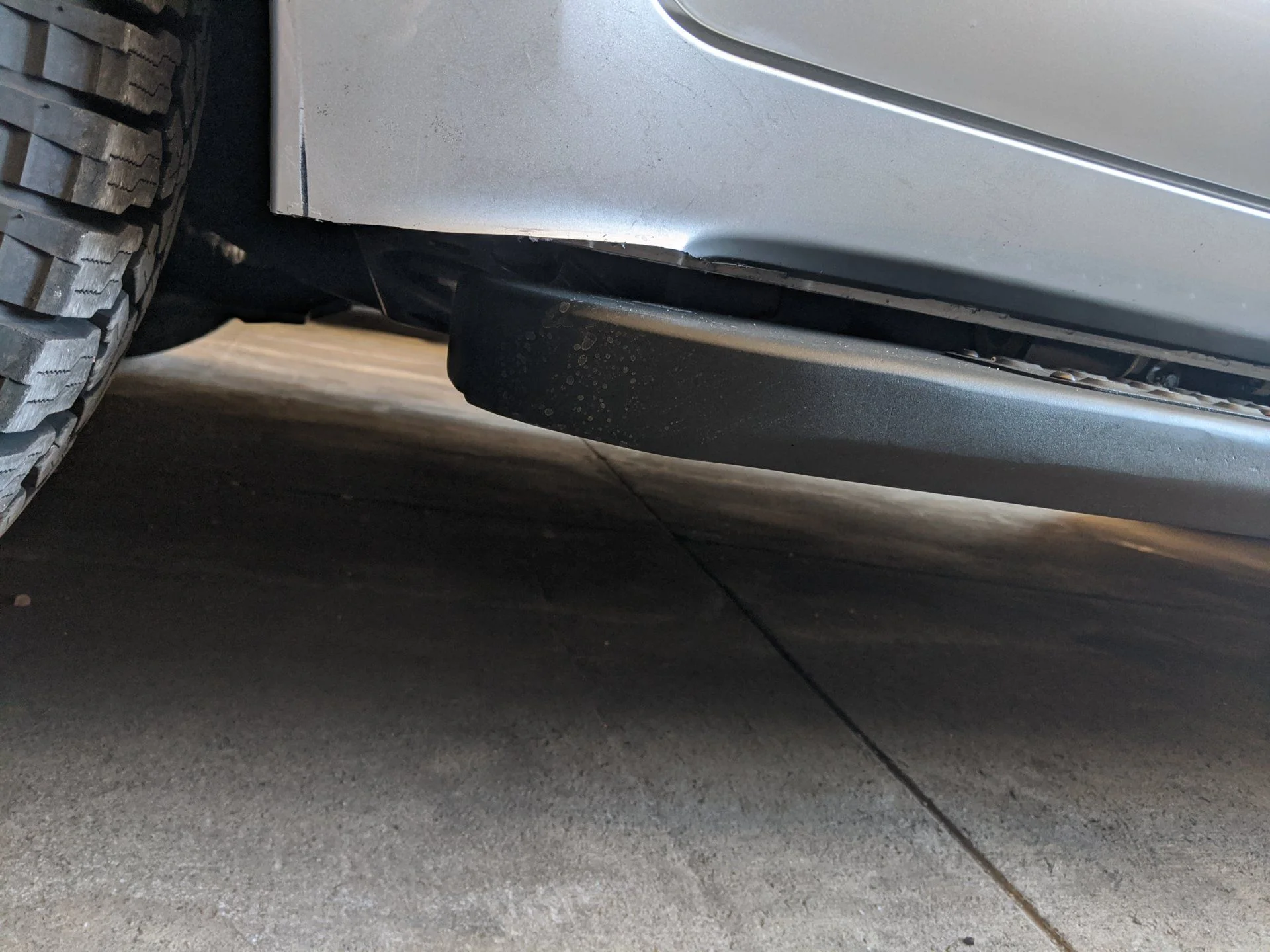

The sliders are as high as I could get them. The gap is about 3/4 of an inch to the metal body.

View attachment 2183608View attachment 2183610 View attachment 2183609

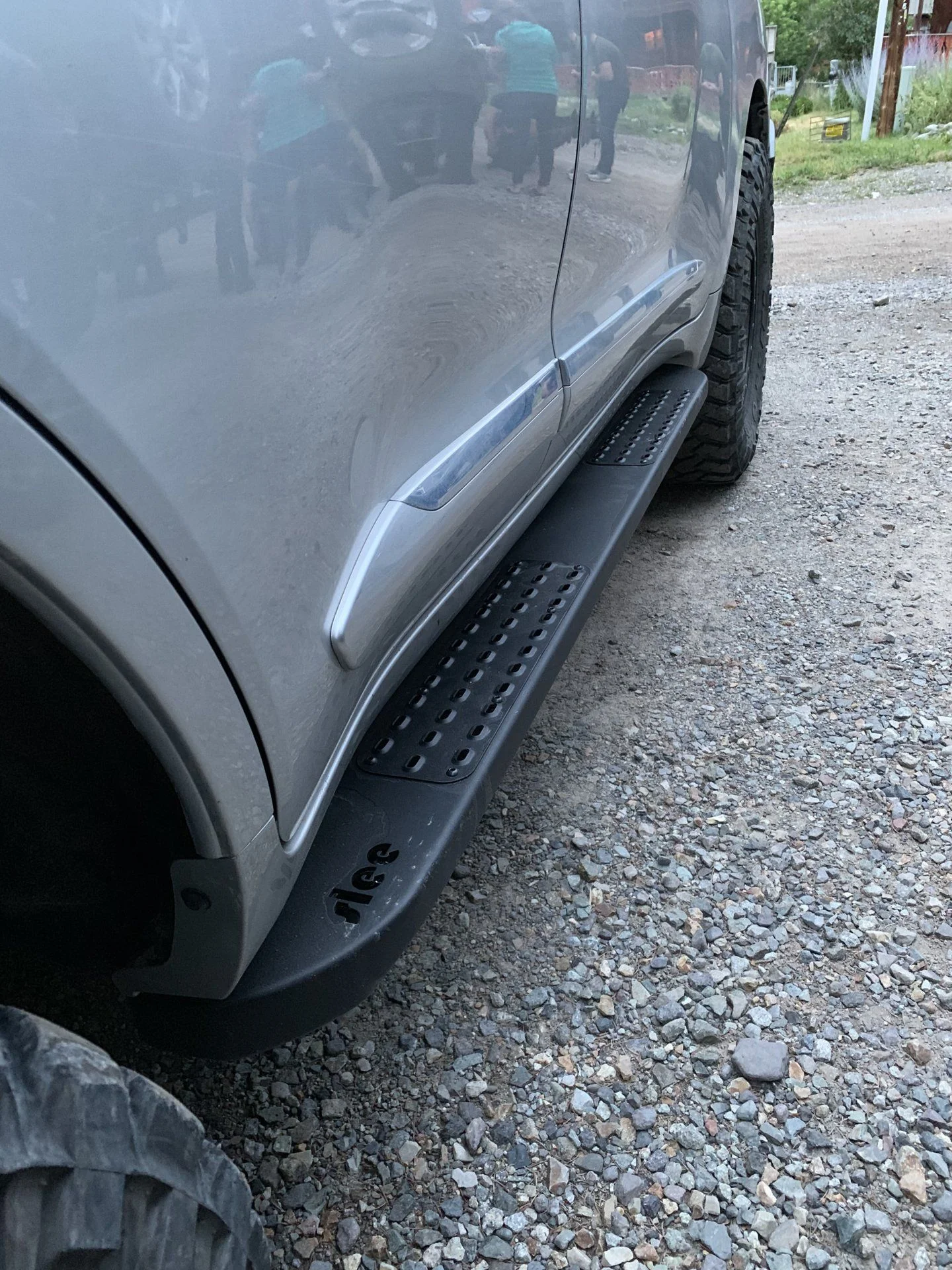

Mine are basically the same as this. They are designed to be centered between a regular land cruiser rocker panel.

I used a jack to try and get the slider as close to the body as possible and had the same gap, so I am assuming that is the way it is supposed to be with the 'new' style slider. I believe @tbisaacs was the previous revision based on the SLEE logo cutout being on the treadplate vs the body of the slider and also the location (rear on the slider I have, front on his).
I just noticed that too. It fits and looks good with the land cruiser rocker panel. The first picture here kind of shows that.
