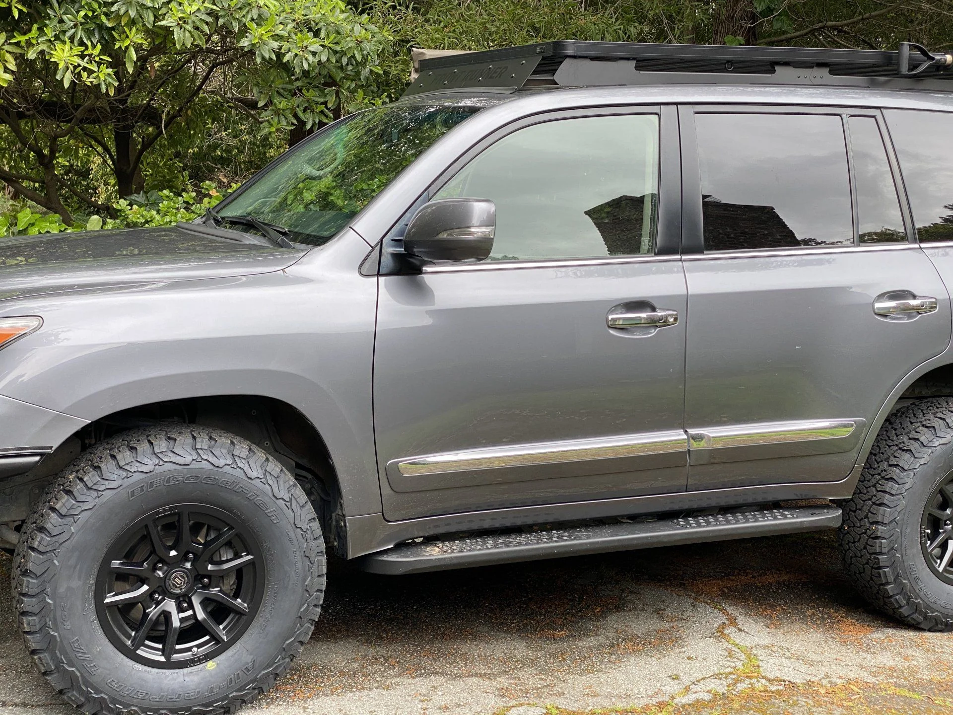

I had Ben at Dissent do my install since he was already doing some other work for me. It was comparable to your quote minus the rocker panels. We decided to just chop the LX rockers. If it didn't work there was no big loss since I would have just used LCs anyways. I thought it was worth a try. Seems fine to me:

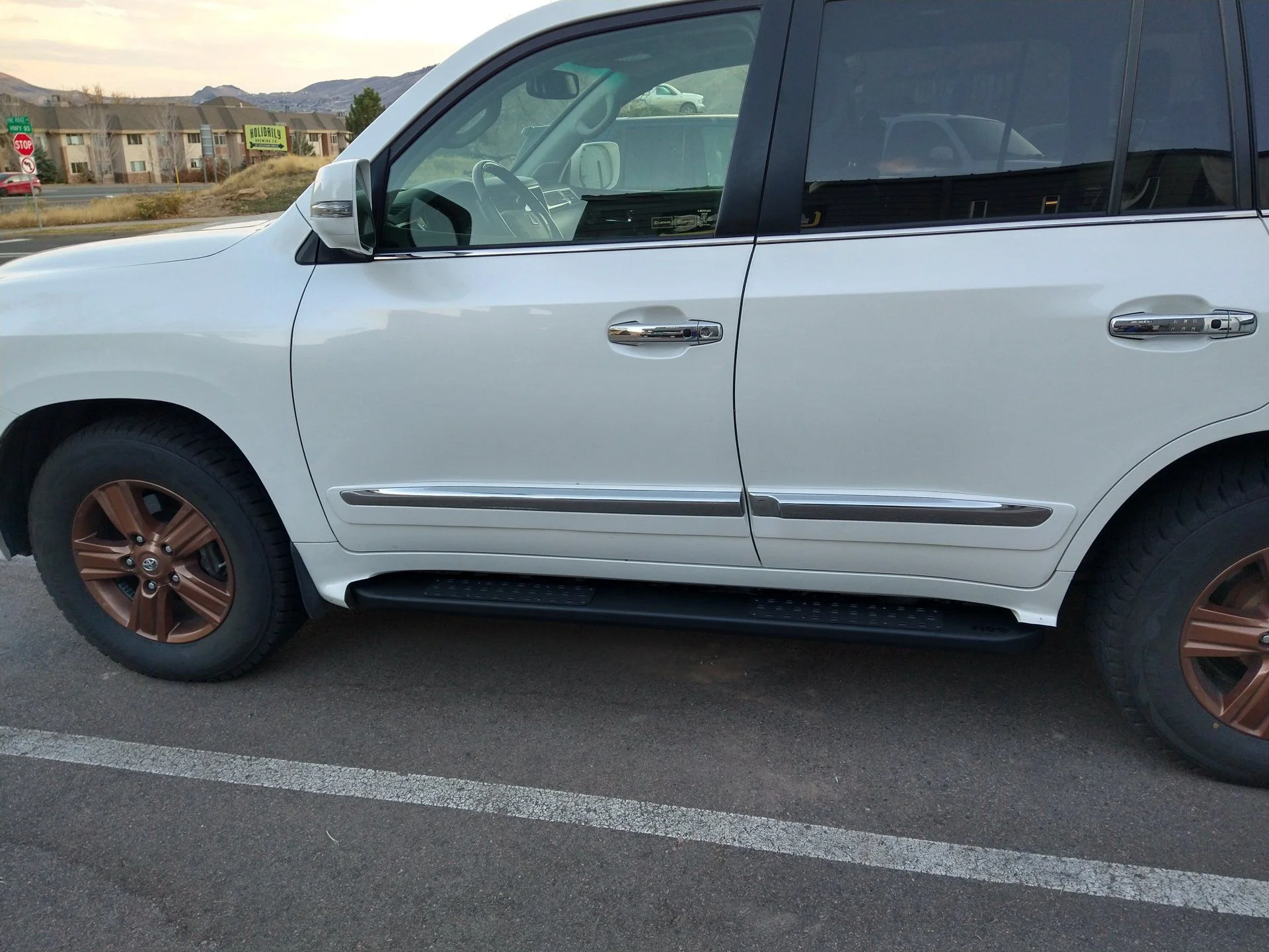

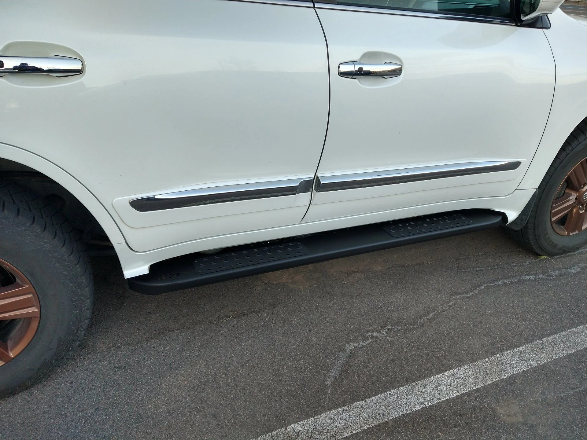

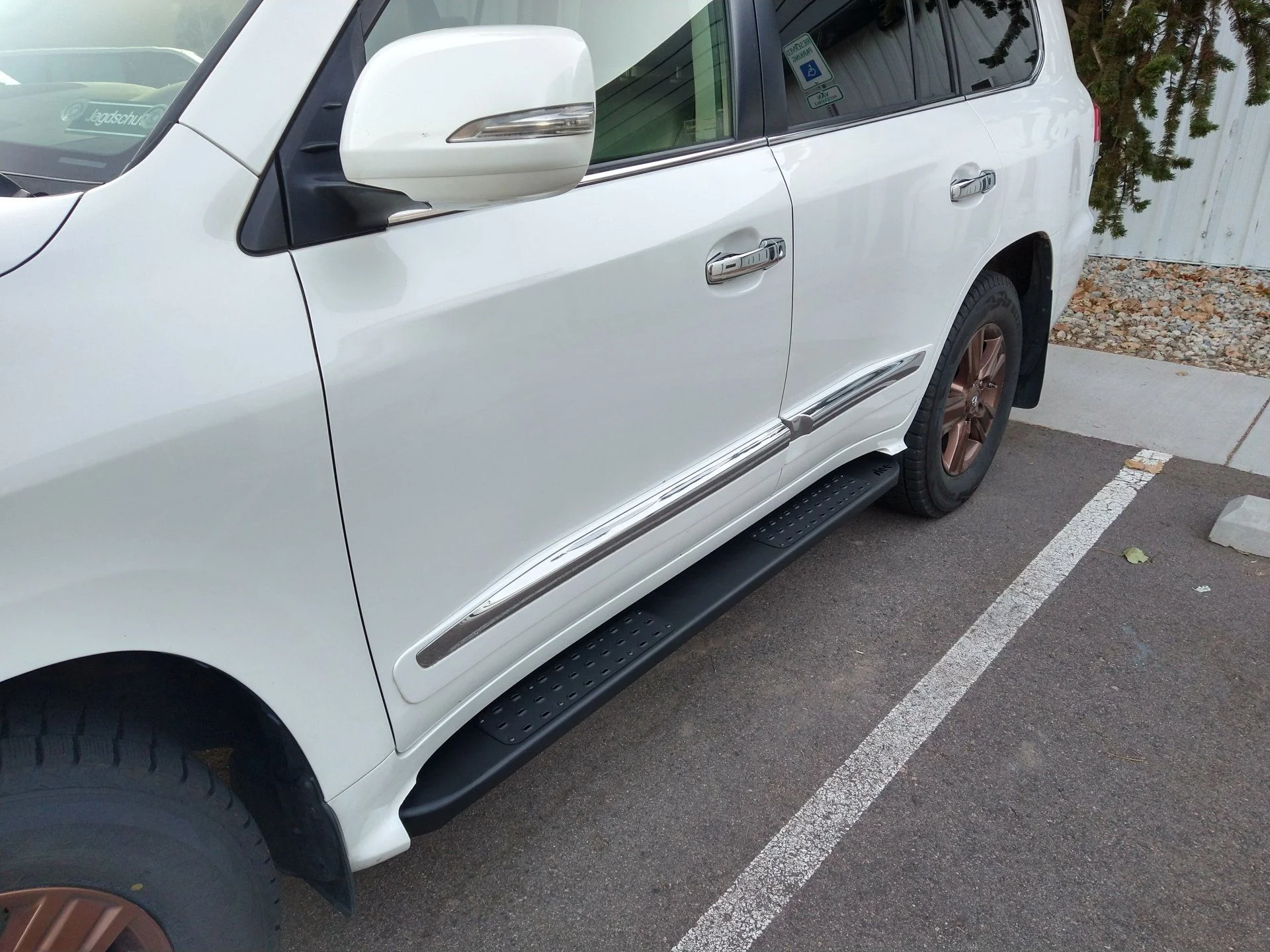

Finally (after a couple reschedules on my end) got my Sliders installed by Slee. It's a pretty big job, I was there most of the day. Thankfully that have a super comfortable waiting lounge and great WiFi. Everyone was very friendly and their shop is pretty impressive.
I didn't opt for replacement rocker panels, I think it looks fine with the cut panels.

Finally (after a couple reschedules on my end) got my Sliders installed by Slee. It's a pretty big job, I was there most of the day. Thankfully that have a super comfortable waiting lounge and great WiFi. Everyone was very friendly and their shop is pretty impressive. View attachment 2486871View attachment 2486872View attachment 2486873View attachment 2486874
Why didn’t you cut the front rocker panel higher? I like the look...but if you hit a rock ledge just behind the front mudguard, then you are gonna have damage?
