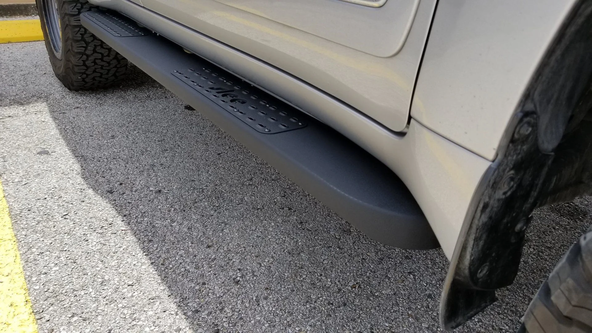

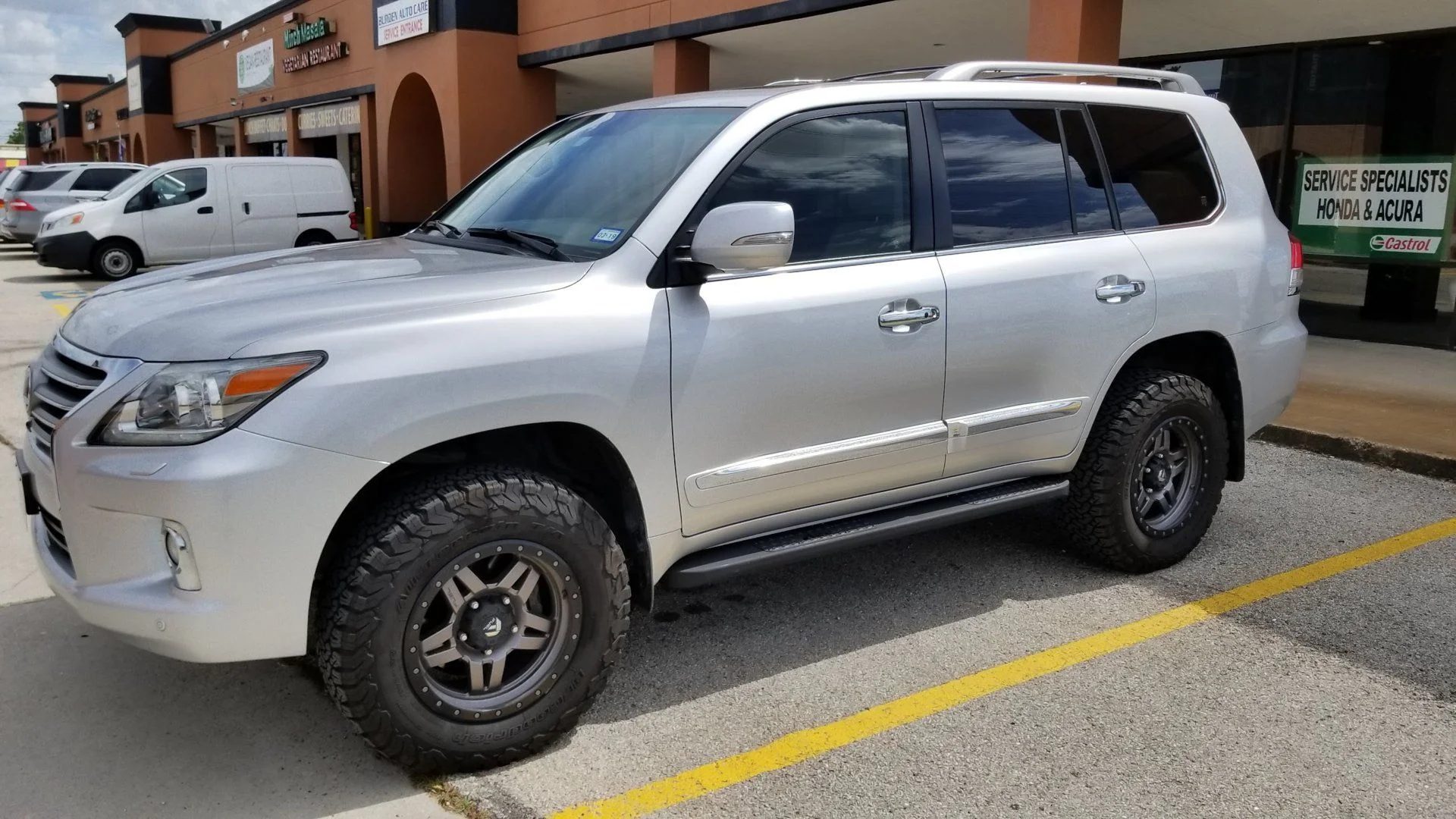

Here's a couple shots:
^Nicely done! She sits up nice and high. With that step adding additional clearance and protection. That's everything I want for my car when I grow up. :)

Thanks @TeCKis300. BTW it's probably obvious to everyone, but just in case, the suspension is in high mode. I've also done the AHC lift (max in the front, about half way in the rear).
Between the 34s (+~1.5”), sensor lift (+~1.25”), and AHC high (+~3”), that’s a solid 5-6” total lift! You’re rig is likely one of the taller overall rigs on these boards.
There’s more to be had in this platform. Waiting for the next guy to push 35s (+2”), sensor lift (+1.5”), AHC high (+3”), body lift (+0.5”). That would be a wild 7” lift, without the rig being actually that extreme in mods. And without all the compromises that would classically come from a rig lifted 7”.
