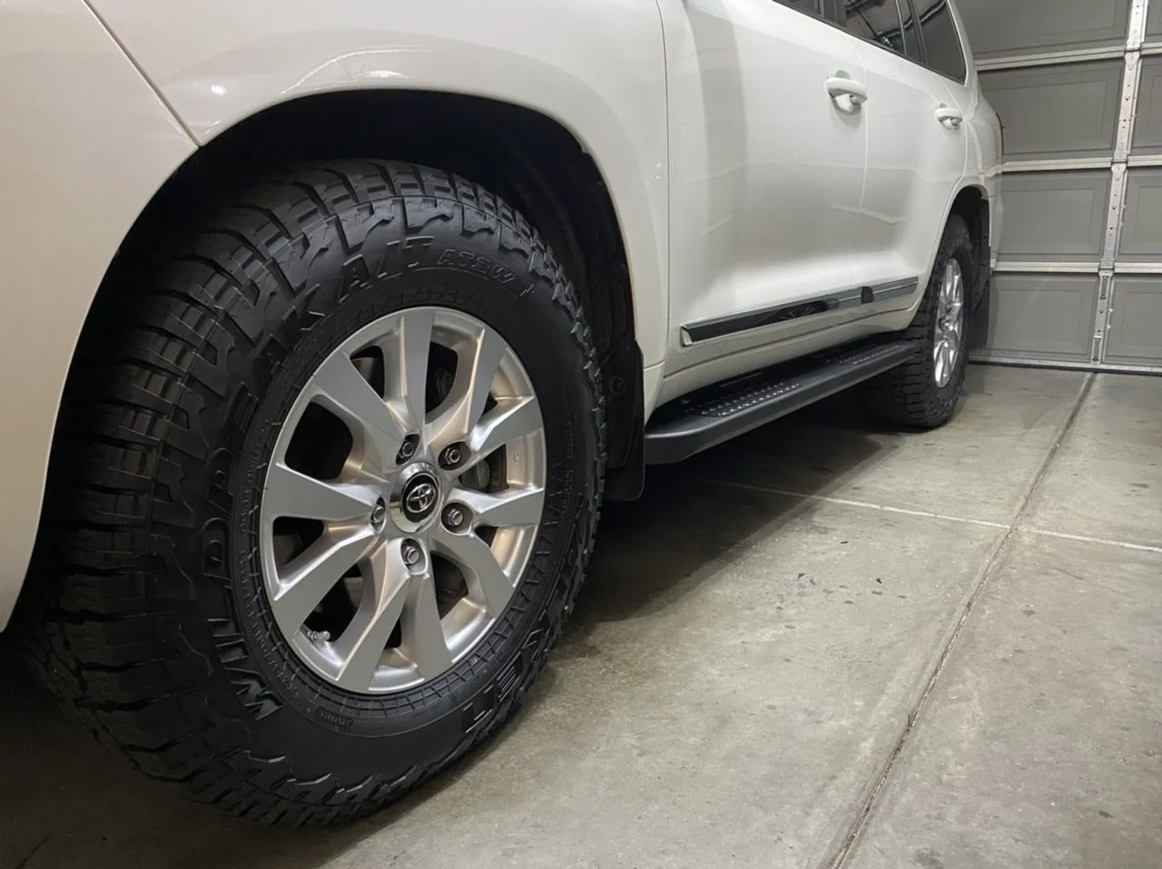

I installed Slee Offroad LX570 sliders, here's how it went

It took some time installing this on a LC but it all worked out in the end.
