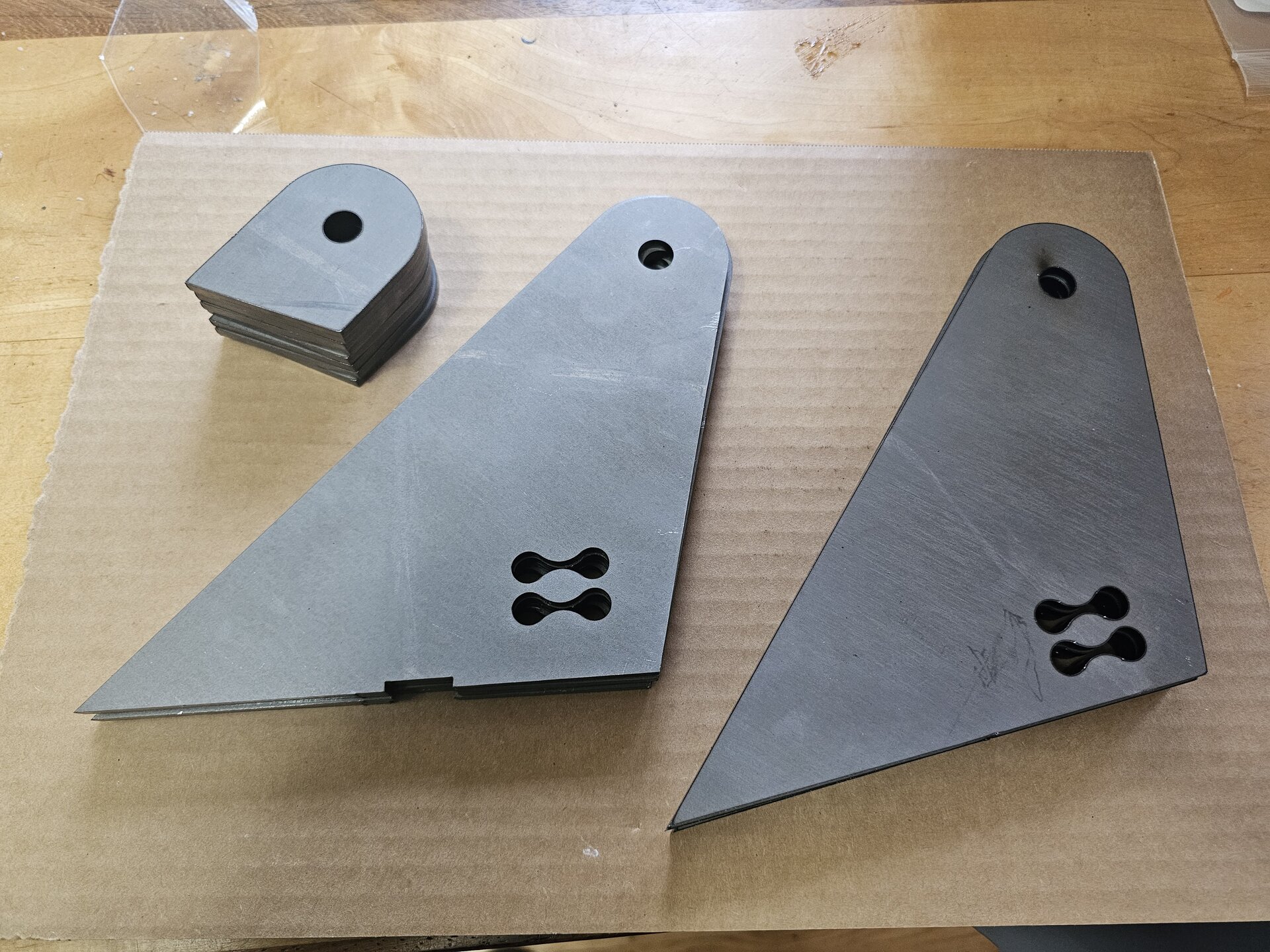

I needed a larger resevoir to go with the hydto assist kit, also nice to have one that leaks less then oem with a new cap.
Psc mounts coming soon.
Working on a full kit for hydro assist.
These are the brackets
I used a 1in ram like @dirtlifestylenate did and love it. Smaller ram means less lag in the system with a smaller ram.

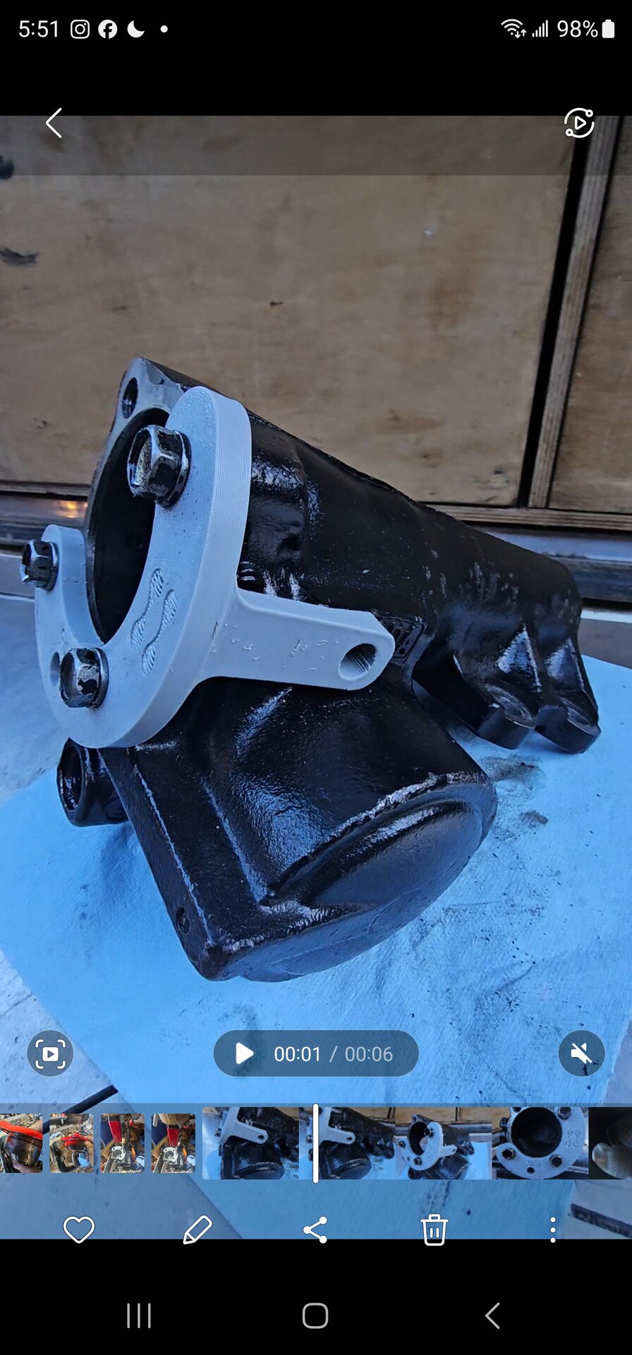

I also tap and rebuild steering boxes with 105 shafts.
For those who want to do their own.
I have a template to mark tapping locations.
This comes with a plug to keep the shavings out of the needle bearings. I had to print something.

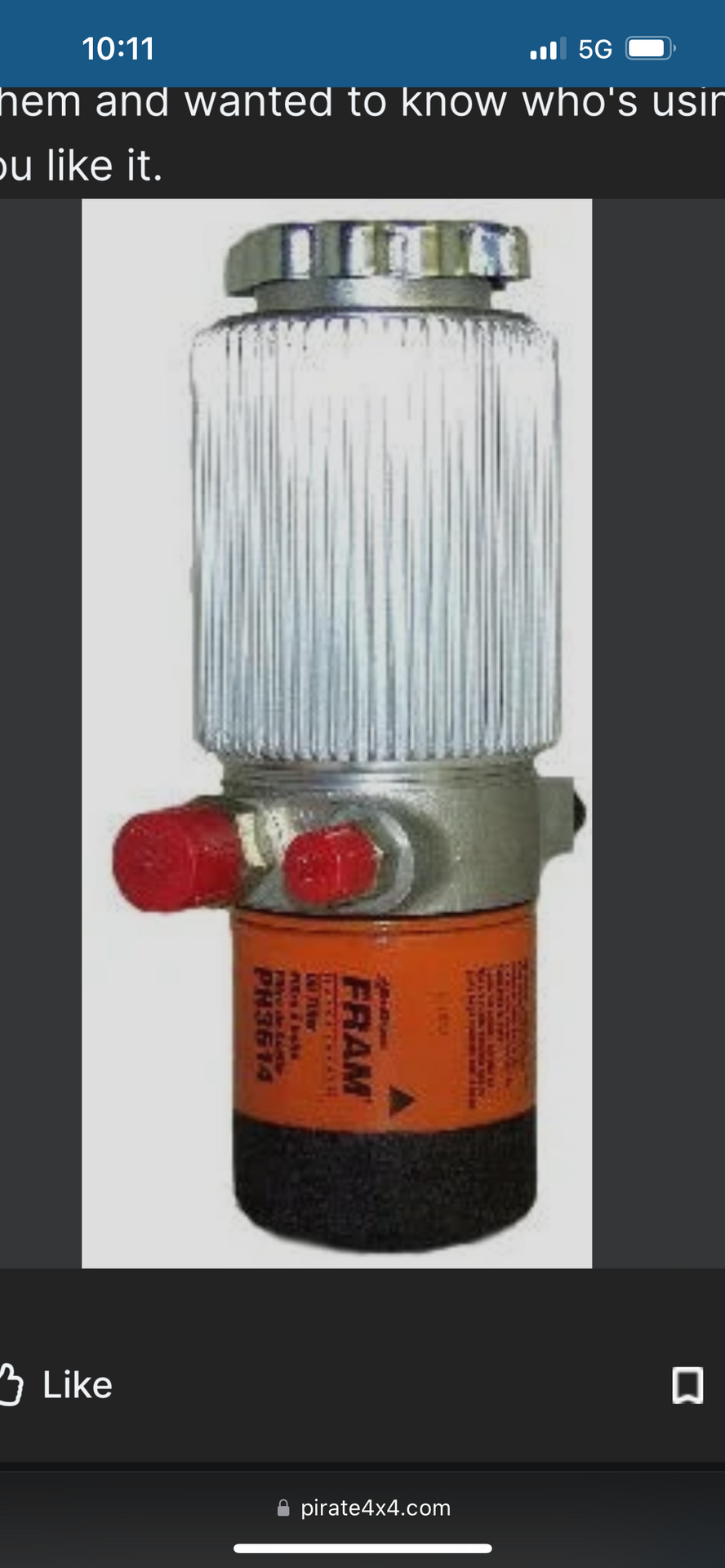

What reservoir are you running?
Not sure if Appleton still sells them.
Nice work Outsane.....
Chase bays with hose fittings
just confirming, is this the one? I clicked on OEM push in fittings, not AN fittings.
Does anyone the capacity (in oz) on the OEM vs Chase Bay resi?

Nice work as always....I've had some growl & howl when crawling, installing the Witt's End style kit for the cooler really helped, but definitely interested in a functional ram system too that would help with the stiff crawl steering. I have the 105 sector rebuild kit and the delta vs reinforcement plates on the shelf for when I do the box. May need to at least drill and plug the box for now in anticipation of upgrades... ;)
IIRC, did you have a pic a while back of how the ram is mounted on yours? If so, can you re-post? Also assuming that this works fine with the @Delta VS steering rod upgrades since I think I saw those on your rig too, correct?

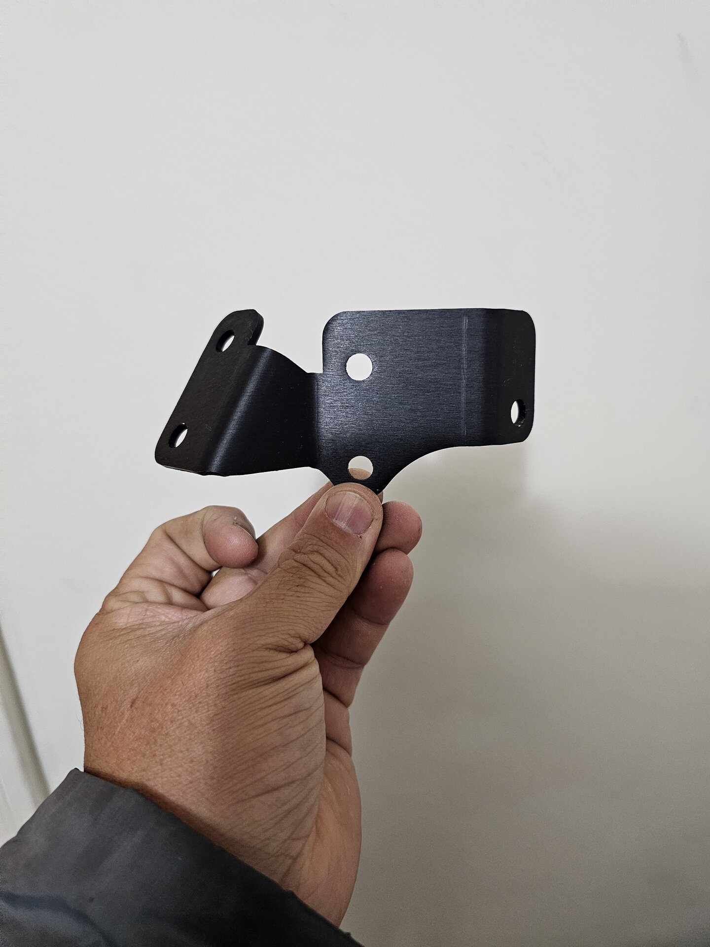

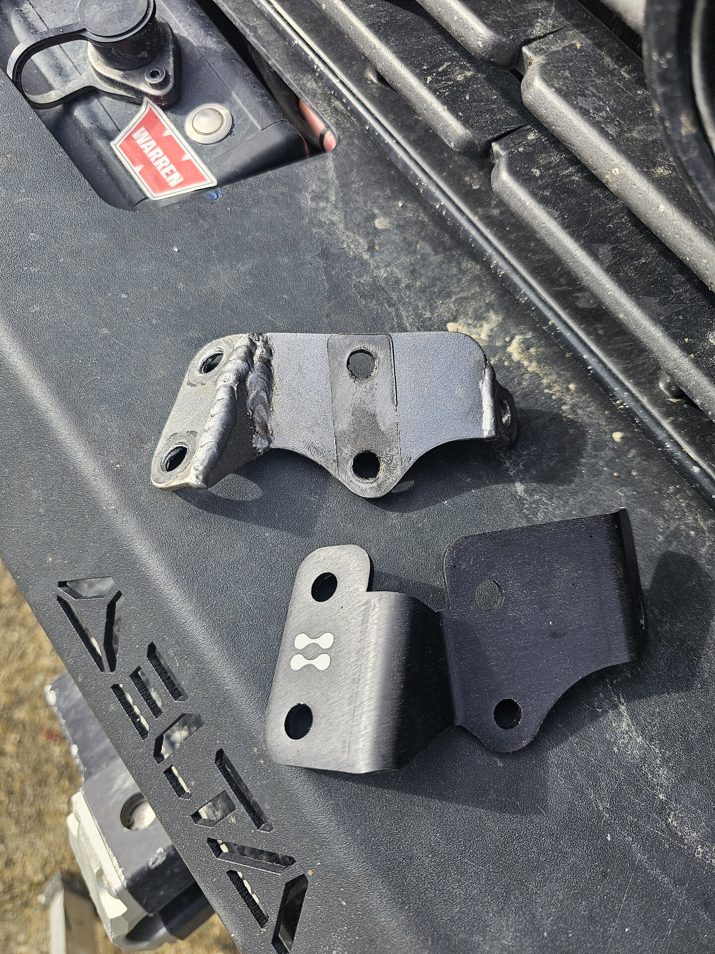

will you have the brackets for sale on the website? I looked but didn't see them on there, but the wording in this post sounds like it's still a developing story. I have a 61 but I assume that the brackets should work on my axle housing as well.
Brackets on the site
Tie rod is in the front on a 61.
Probably need to modify to make it work as everything is different. And a shorter ram.
