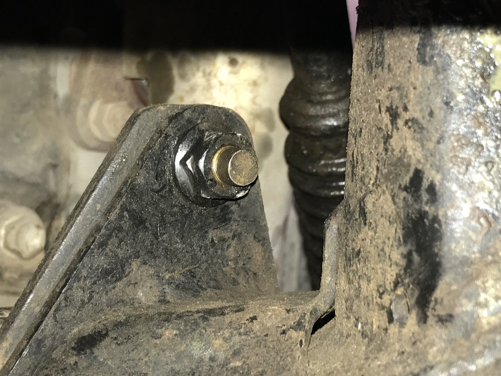

I am having problems getting the forward 14mm bolt loose - any advice? I just can't get any leverage to break it loose. The lower bolt feels like it is welded on to the plate - it is a 15mm. The back nut was not affixed to the plate, it was a 14mm.

Add a picture of which nut you’re talking about
The forward engine mount bolt.
You can get to the back one easy-peasy.
The one in front is difficult to turn, there is no room.
I am trying from below. I can't see how you could get it from above.
Here is the engine mount from the back:
