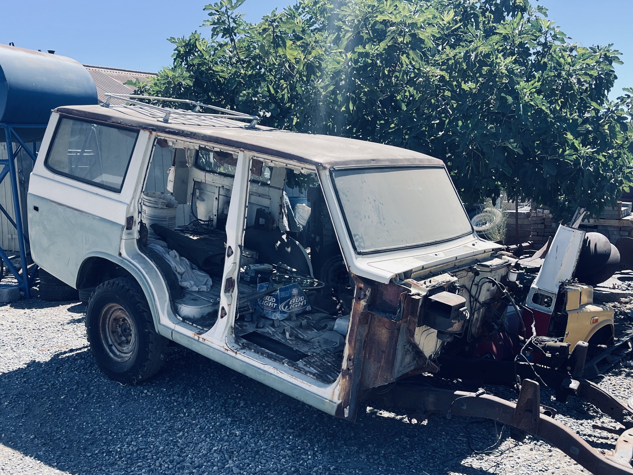

Pig under a fig, this one waiting for scrapper, see anything you want, come and get. Many of you have parts off this pig, Mr pig, thanks for your sacrifice!

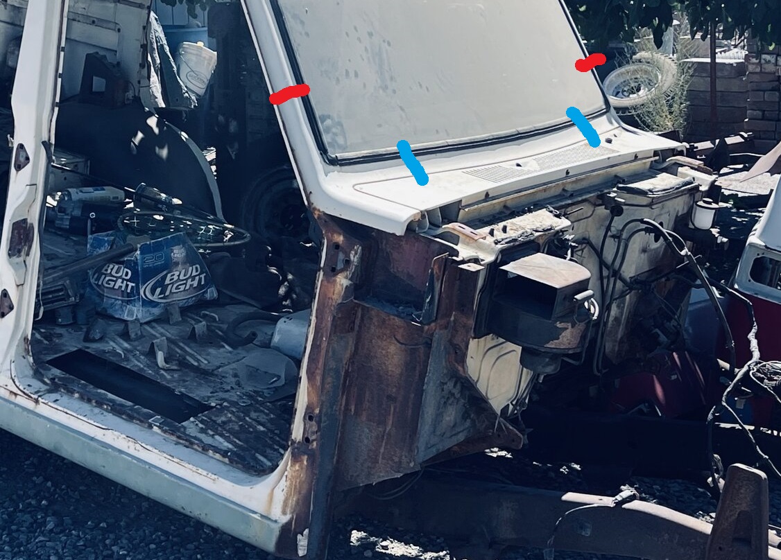

Well if someone goes over to take Don up on his generous offer, and if said individual has a Sawzall with him, and if they perhaps need the front windshield (so that it's removed), then I would be happy to pay for their efforts to cut the bottoms of the A pillars out for me. That is assuming of course that they are as rust free as they appear. That also assumes compatibility with my '77 pig. Looks like this one might have the later year's front doors? Not sure if that matters. I only see one part number listed for the Cowl Panel Subassembly so I assume they are all the same.
I honestly don't know how the front of our pigs are put together. Can you just cut at the two red lines and somehow remove the bottom of the windshield frame (I think it's all the "cowl panel subassembly") in one piece or do you need to make additional cuts at the blue lines and remove it in two pieces? Would be great to remove it in one piece as that saves two welds. Looking at the parts diagrams, it appears that it was originally installed as one piece with welds about where the red lines are. Can't tell though where else it might be welded.
This is definitely not a must have as I already have some decent cut pieces; I'm just thinking these are nicer.

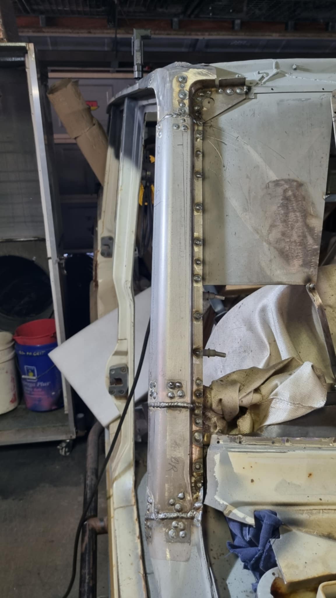

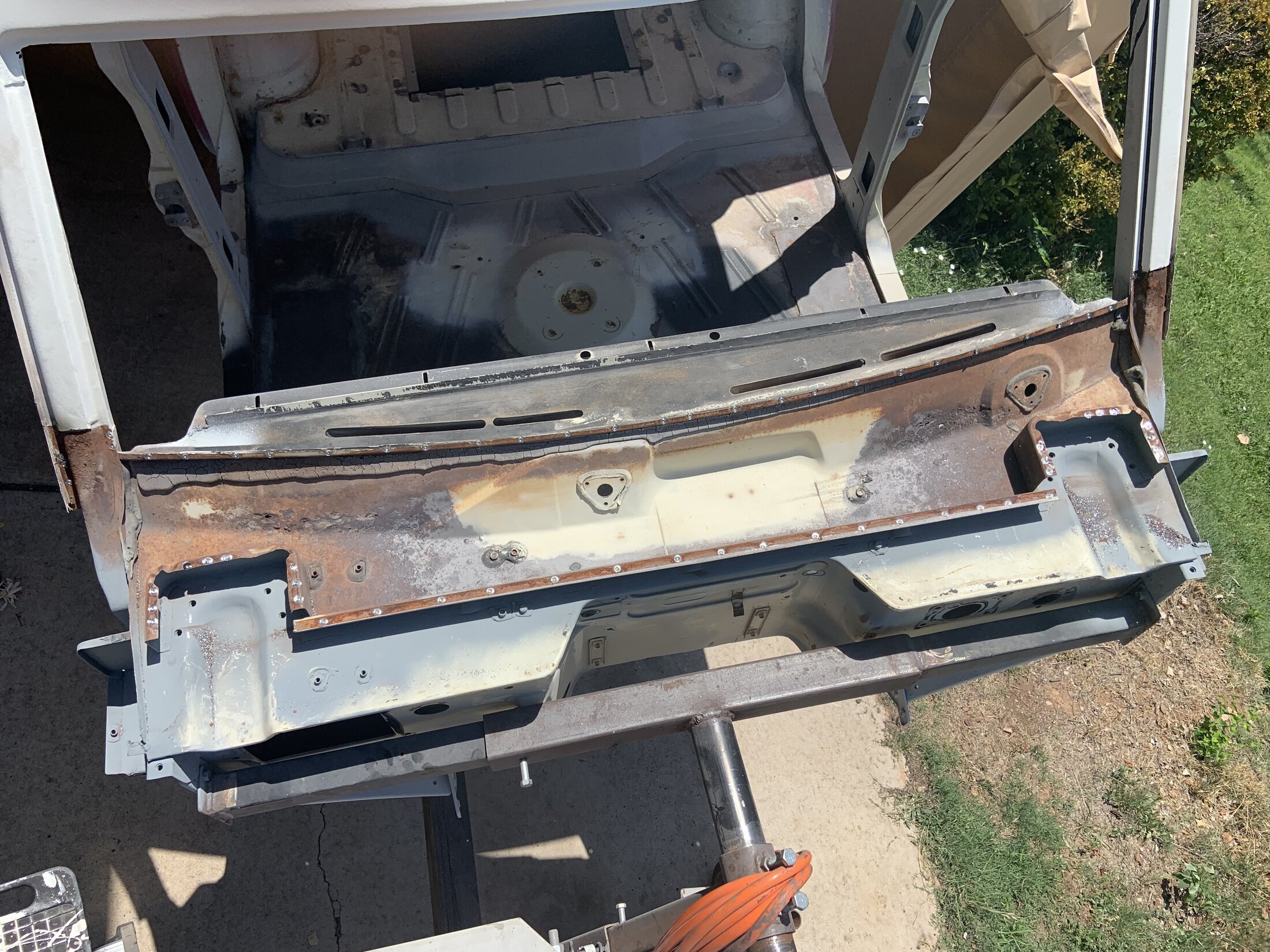

I was thinking the same thing WDE. How many people in the last couple of years have had to cut out that section of cowl and A-pillar and graft a new one in? A few anyways, with more needing to do it.
To take the cowl off, there are welds across where your red lines are, the rest are spot welds. The A-pillars are like two or three layers. @fre55h has intimate knowledge of the inner workings of the A-pillars.

This truck was strange, roof was toast, most of body in pretty good shape. We cut into a few areas and parts and metal looked like they came out of factory, maybe parked under tree that dropped leaves or needles that kept moisture on roof? Doors and everything bolted on was rust free
@fre55h is the A Pillar Master!!!
He has his technique down and everything...

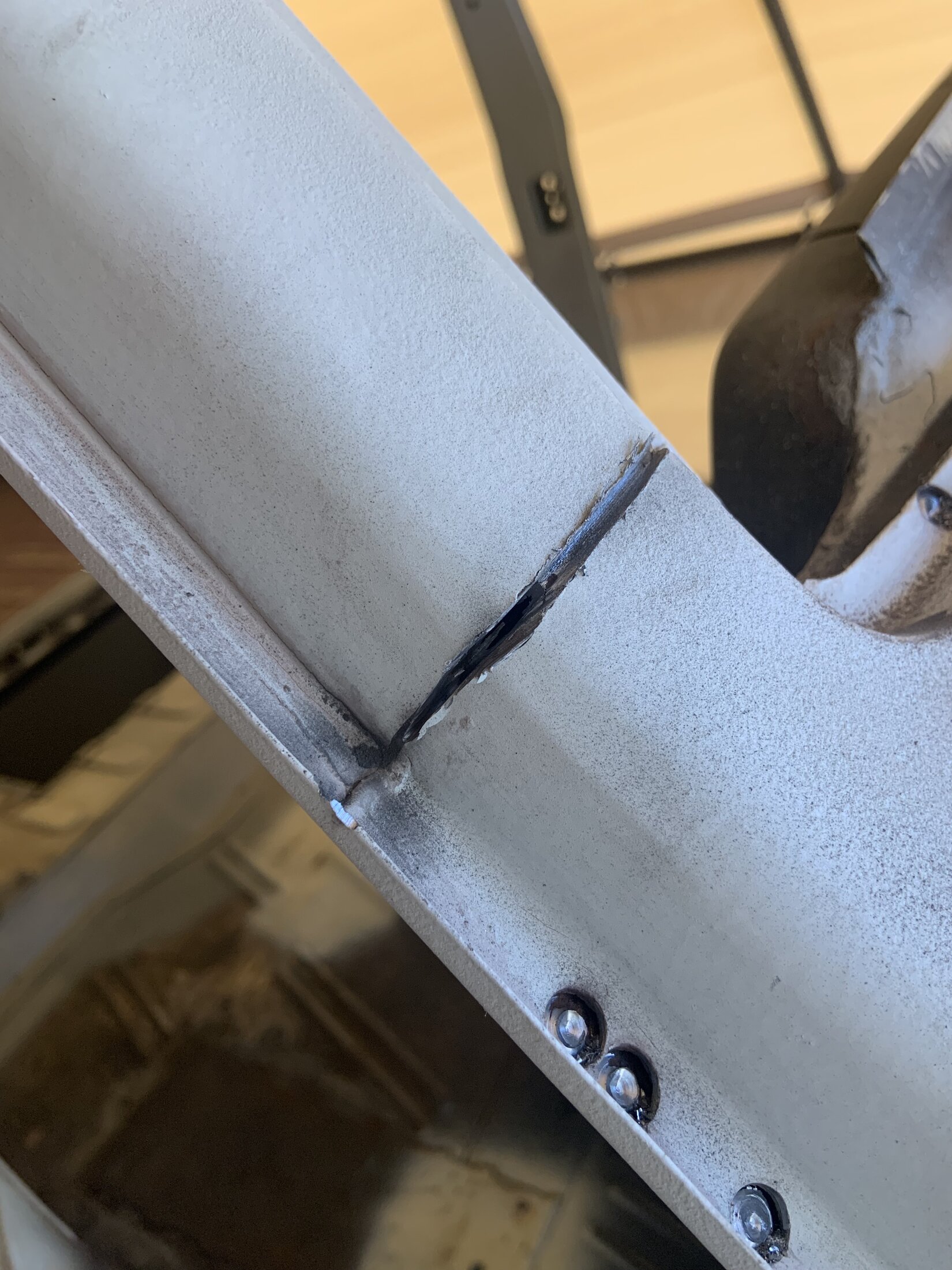

Yes @RUSH55, here is the relevant parts diagram. It obviously doesn't show the spot welds but those shouldn't be overly difficult to remove as long as you can get to them.
Not overly difficult, just time consuming.

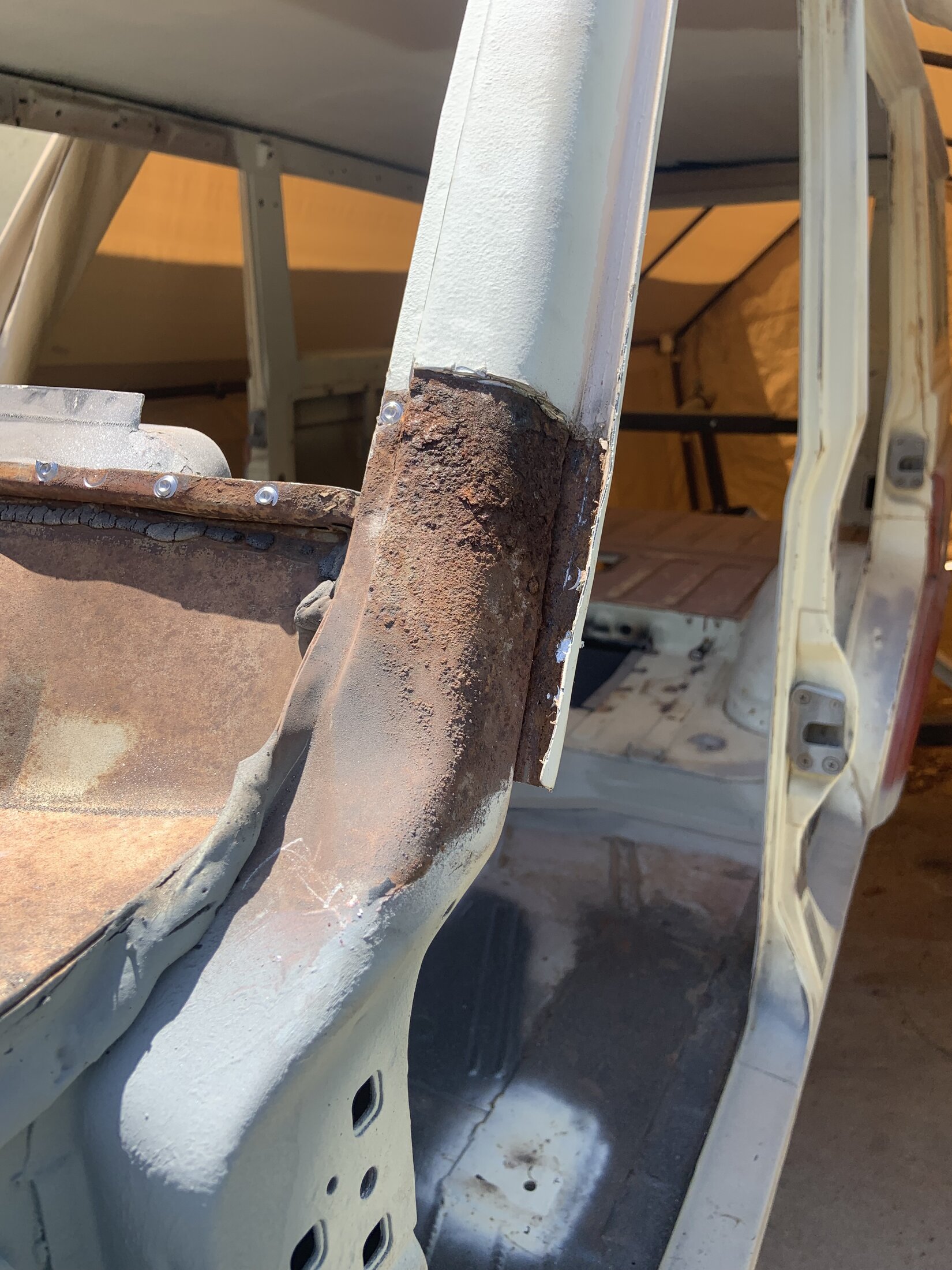

IIRC, you coated the under the cowl with some products, I don’t recall what you used. What was it?
Something like this.

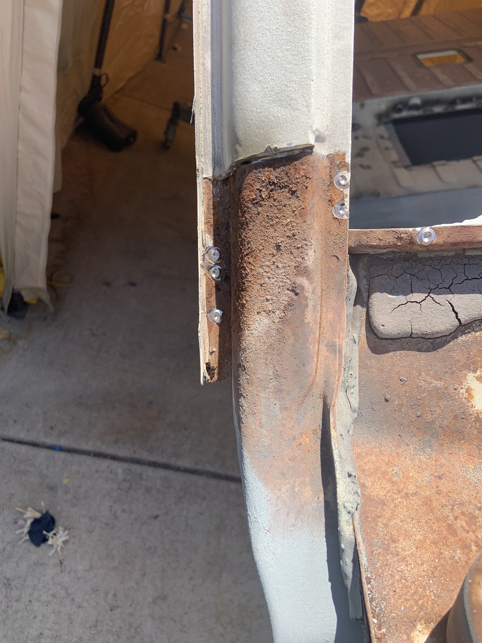

Inside channel.
Outside skin (3) layers.
