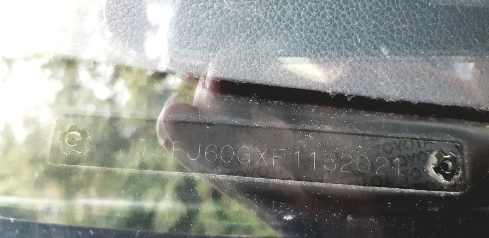

My FJ60 is made in Japan, and has the designation GXF (as identified by the vin,) which this site states means it was made for outside the U.S. market: http://everythingfj60.com/60-series-buying-guide/ However I bought it in the U.S. and it doesn't have any features identified with foreign models, (sun roof, lean indicator, 3rd row seating, etc.) So I imagine it was made in Japan, for the American market? It's left-hand drive. Has anyone encountered this issue? Do I go with the A/B springs, or A/A or

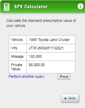

Found this on the Texas DMV website (guessed at the mileage):
2001123
A little experimentation with my VIN and also different mileages always returns $6000 :)

I read that article twice. It states GX is a trim offered outside of the US. Not that it is in the VIN. The F in your VIN represents a 5 as in 1985. A=0, B=1, and so on. Every ten years the eighth number from the end switches between letters and numbers. My 1984 has an E there.
I’m not sure what the X in yours represents. I have a 1 there. We’d have to do some VIN research. I’m sure we all know that made in Japan is designated by the J as the first digit. United States is 5.
HTH

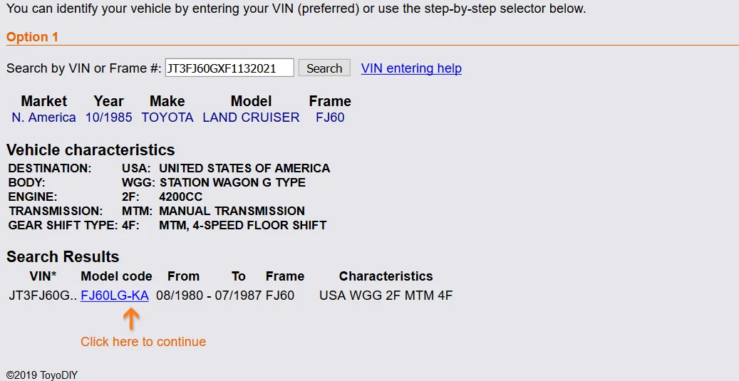

It's a US market truck.
