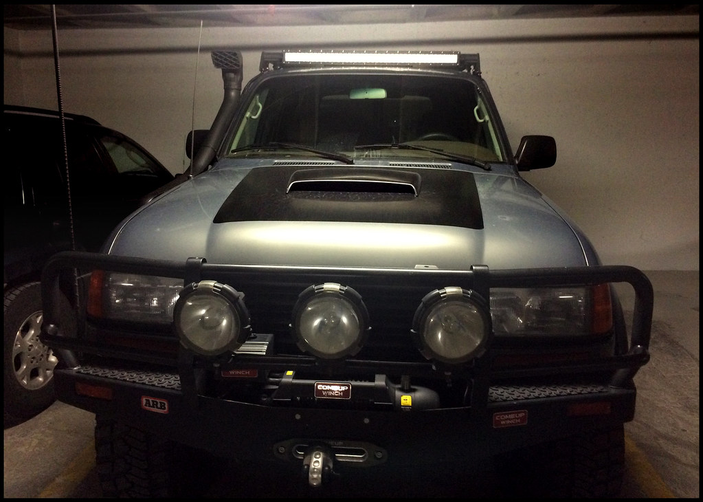

I picked up a scoop (designed for a Mustang) on ebay a while back. I was contemplating using it to help cope with some high engine temps I was having at the time. I put it on for a while purely for cosmetic reasons to see if i even liked it before cutting the hood. The Engine temps ended up being a bad head gasket which I replaced so I never cut the hood to use this again.
But I do keep considering putting the scoop back on or doing some kind of louvers just to let some of the eng compartment heat out. It's crazy hot in there and I think it can only help to reduce those temps however possible.

Can you move the vents closer up towards the windshield? At speed, that would put them in a low pressure area and effectively pull hot air from the engine bay.
I had posted my scoop earlier but it was purely cosmetic at the time as I wasn't 100% committed to it. I have since made it a permanent mod. I'm using it to increase some airflow into the engine compartment to help with ambient/engine temps. I plan to also add some vents soon to help. The idea is that the increased air through the scoop will create more high pressure in the engine bay and then the vents will allow the hot air to be pushed out.
Anyway, here are some pics of when I made it more permanent.
