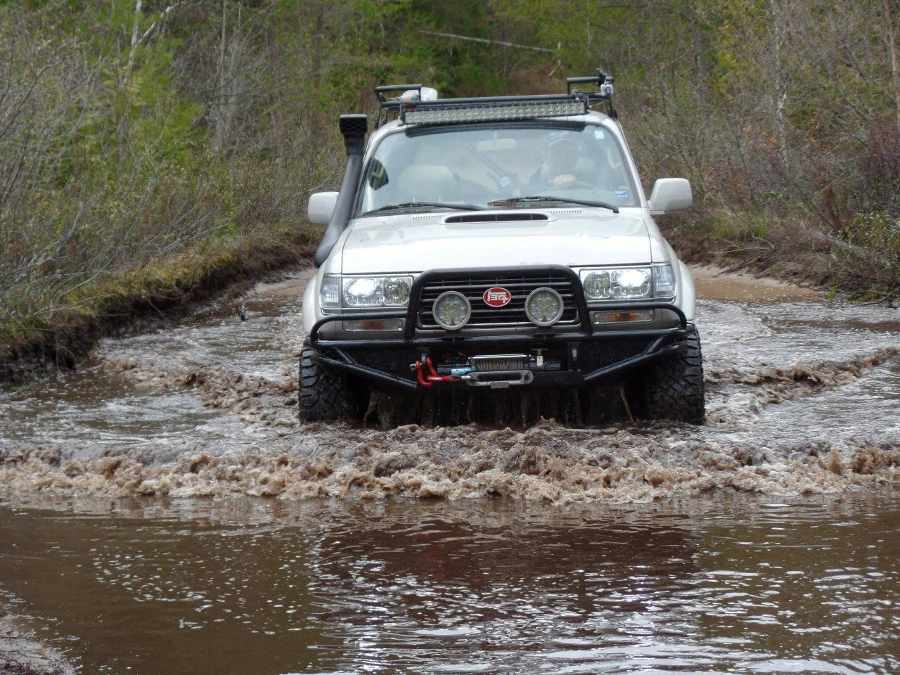

I test fit a WRX scoop on my old 40th and think it's a logical choice if you can't source the Aussie one or don't wnat to do the 4Runner retro fit and the associated body work...
an old thread, but it has good pics.... I was looking at it jsut in case I ever find a unicorn Sc'er or the Turbo kit is avail ......

Do you think just on eBay to purchase a wrx scoop?
Hood scoops
What year WRX?

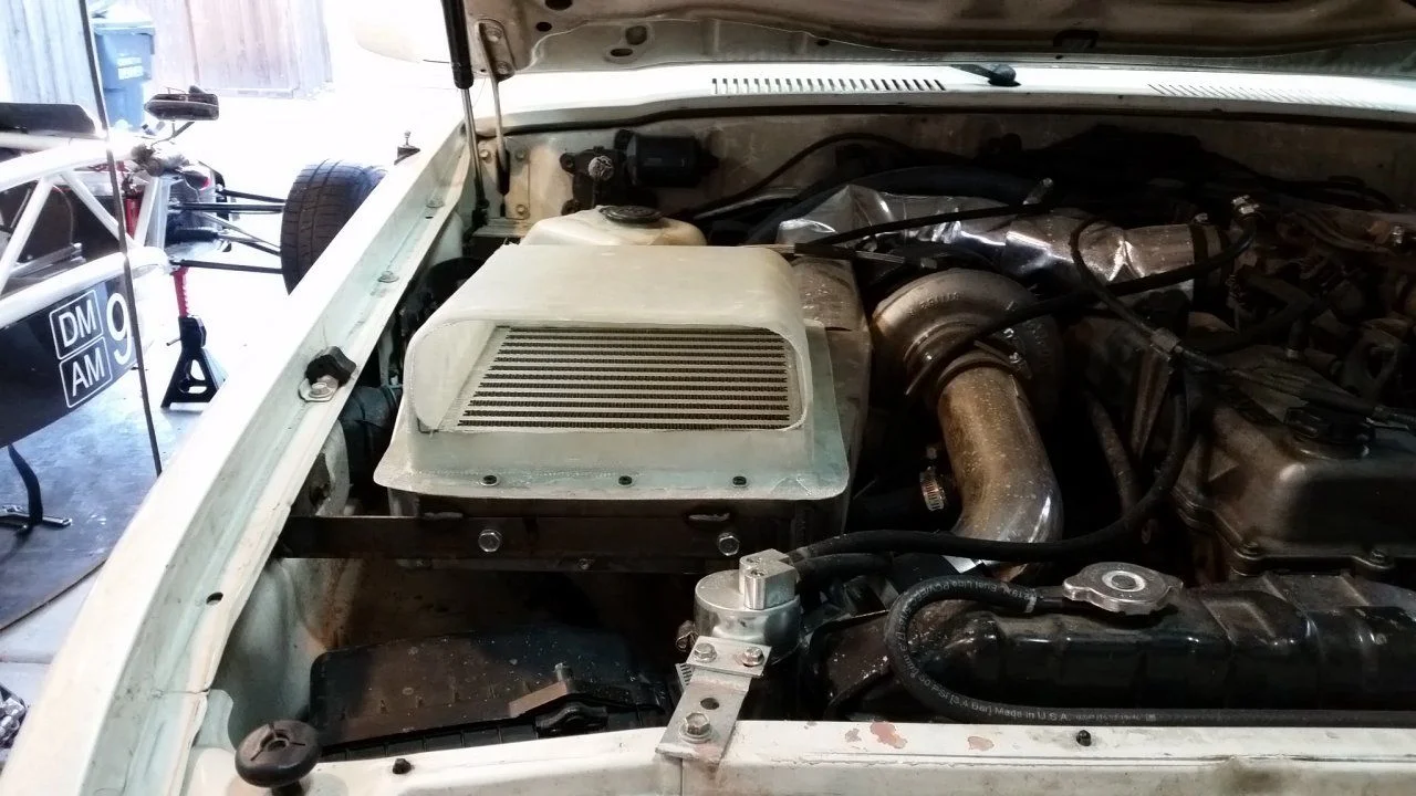

I have a subaru scoop that sat above my (former) intercooler.
I really like the looks of this. What did you build the scoop out of?
I have an STi scoop (ebay) that I plan to put on mine middle center over an IC for my 91 6BT (that year did not come with intercooler, just a crossover pipe) but I really like how simple but good looking that is. I might have to rethink things...
Scoop is fiberglass mounted directly to intercooler, then you cut a hole in your hood to shut the hood with the scoop sticking out. It is totally redneck, and I wouldn't do it again, but it was fun to annoy the neighbors and worked great :hillbilly:
No problem with rain, just made the intercooler more intercoolery. For a while I just had a hole in the hood and had the truck parked through multiple rain/snow events--didn't get anything important wet.

I don't know why you say rednecky, I really like this setup. For what it was it was awesome. The Intercooler isn't sitting on top of the hot engine and it is getting plenty of air. What's not to like?? :)
