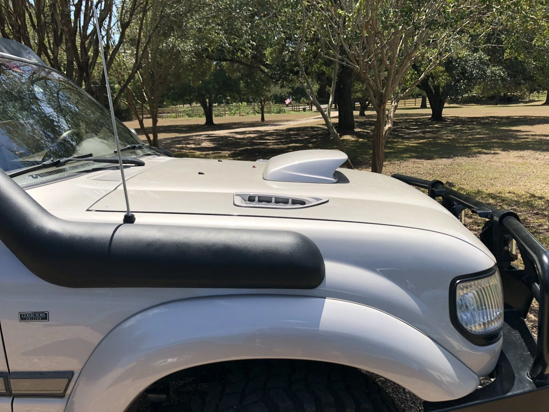

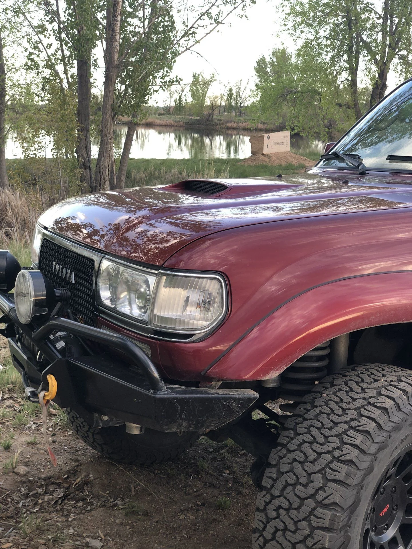

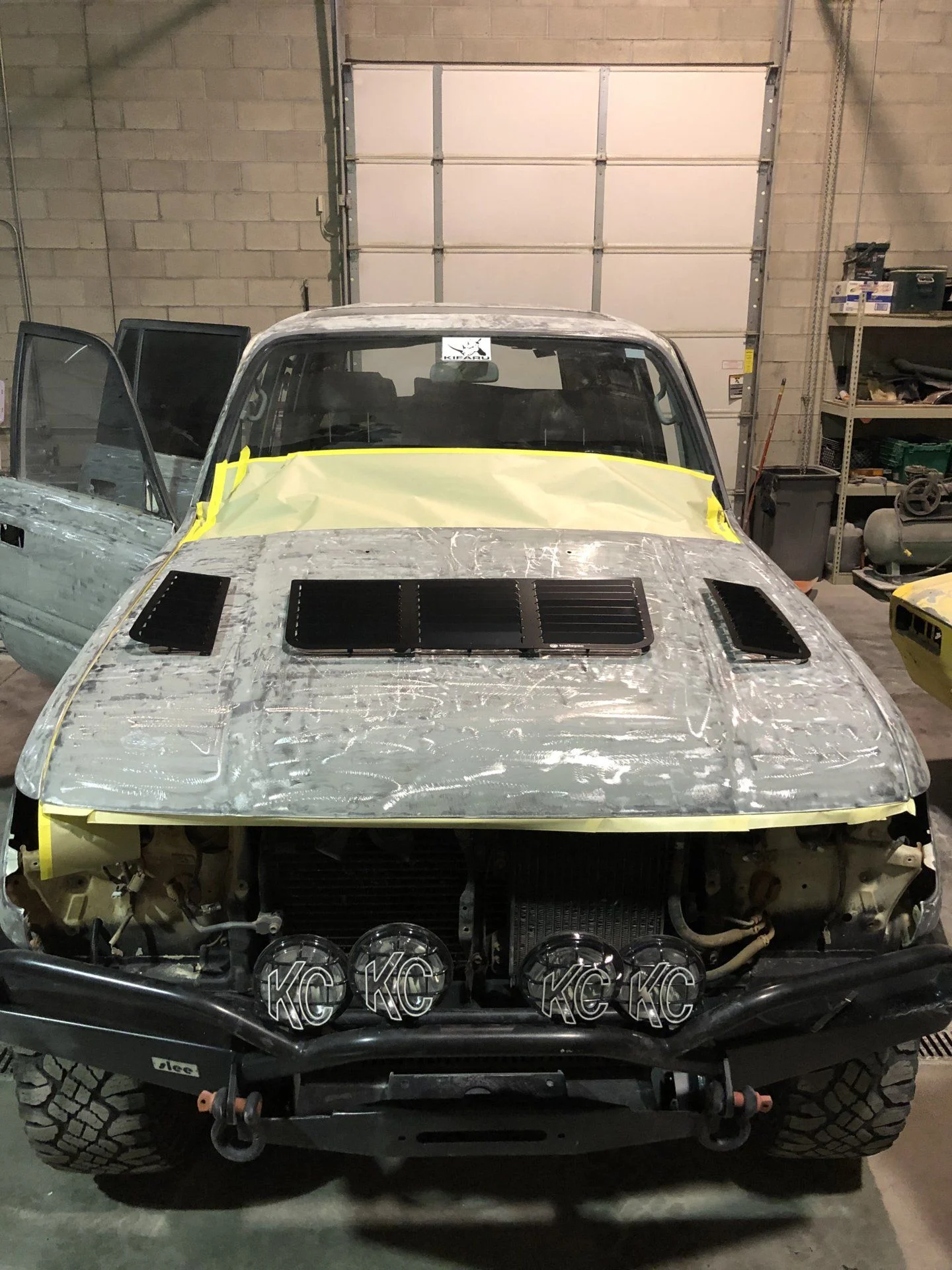

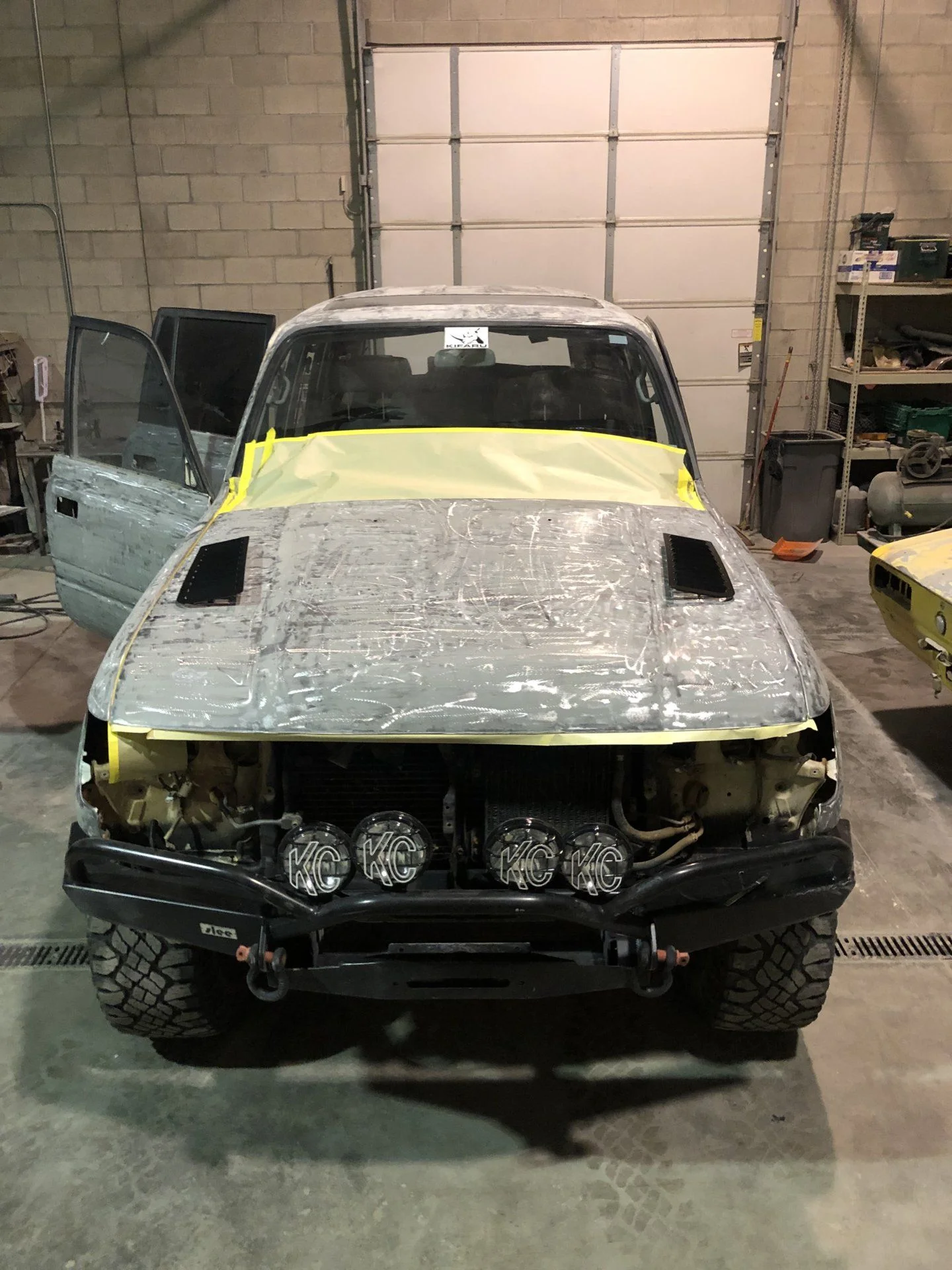

Went with a 99 forerunner scoop, It was cut into the hood repainted.
That looks really sharp. Did you notice any changes in engine temps or anything after intstalling it?
204 degrees around town, 188 degrees at highway speeds, 75-80mphThat looks really sharp. Did you notice any changes in engine temps or anything after intstalling it?

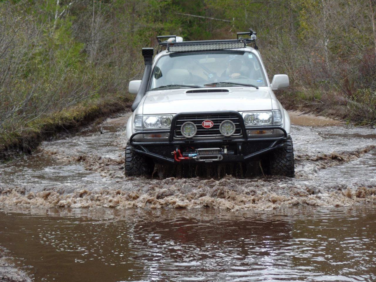

I have a subaru scoop that sat above my (former) intercooler.

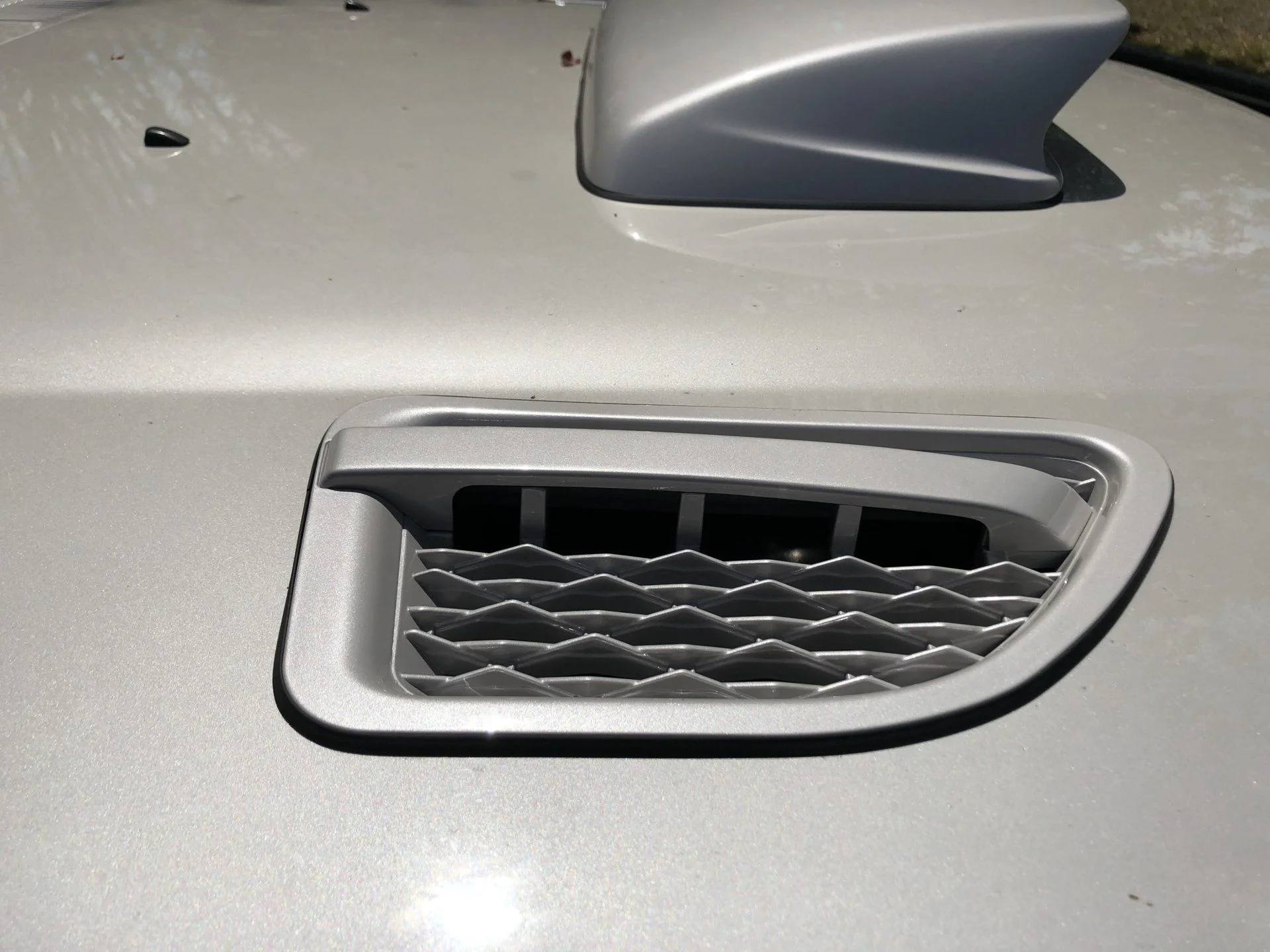

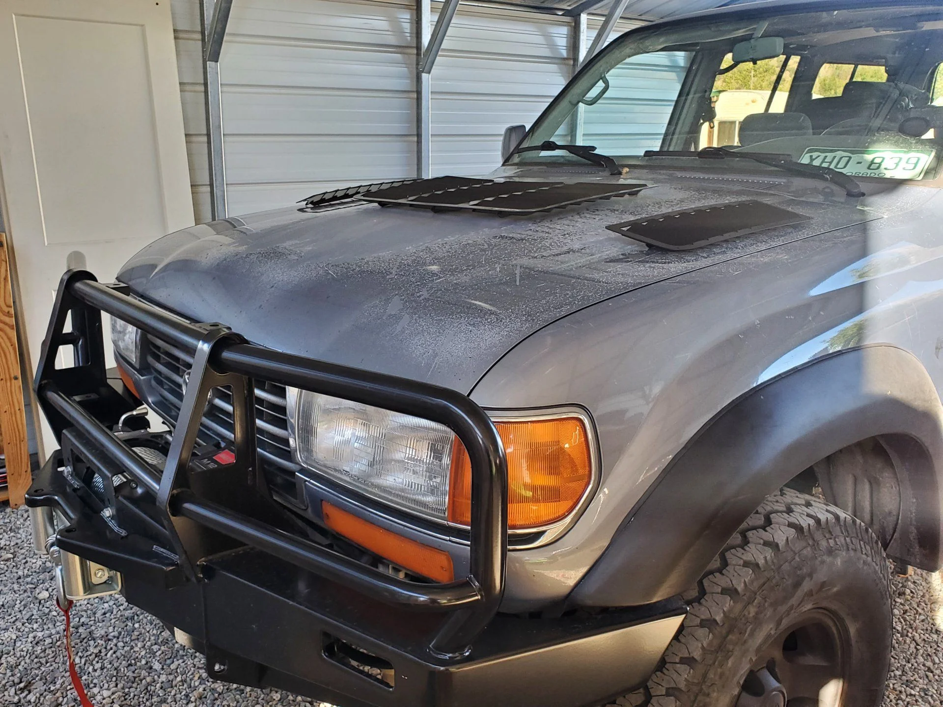

Got a set of the rover vents for mine. Just need to install them.I used a STI scoop from Ebay for 118 bucks and then some rover knock off vents ( had to fill the "sport" script in)
more than a 20 degree drop in temps while it's been in the 90's here.... well worth it IMHO.

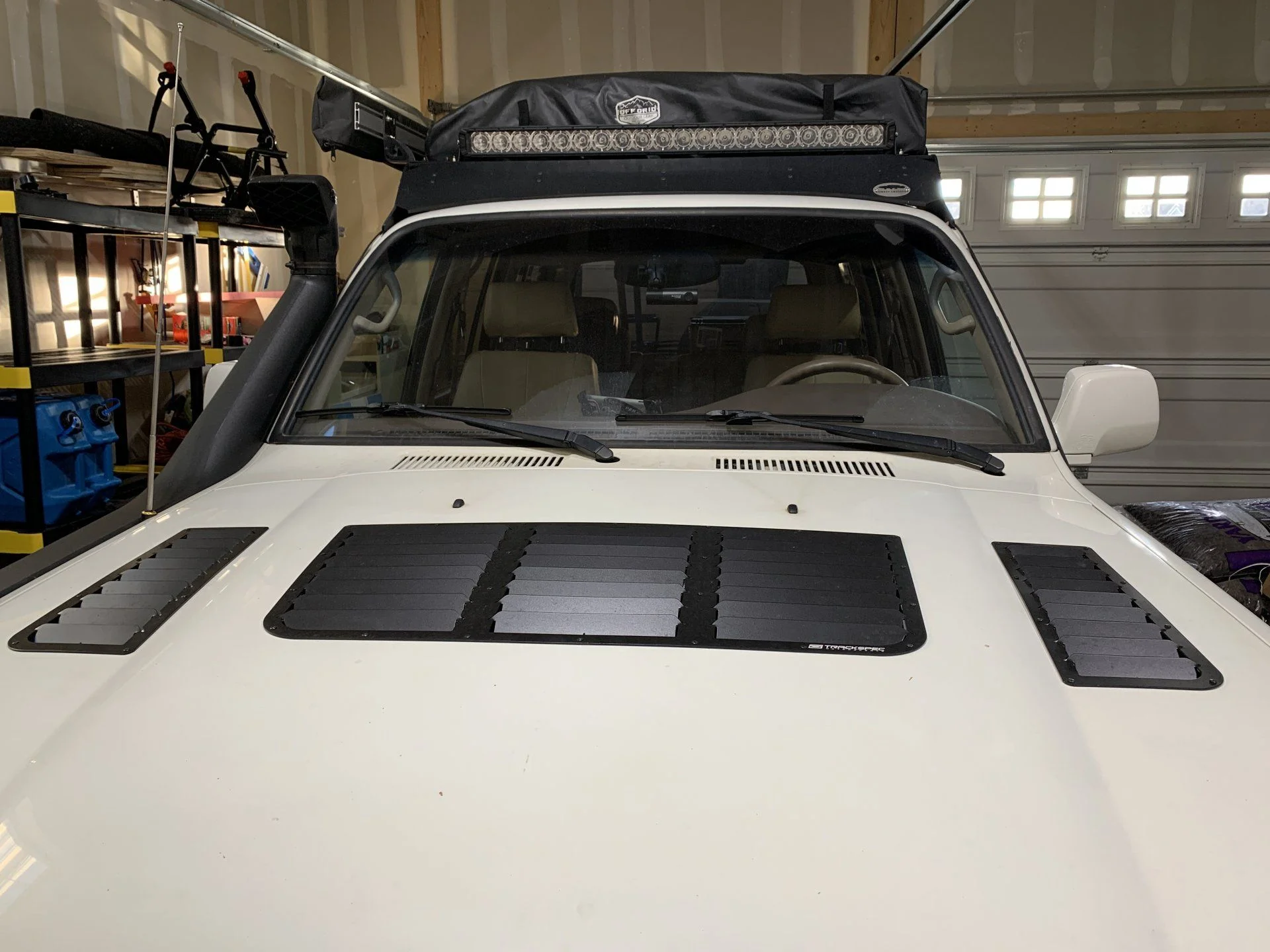

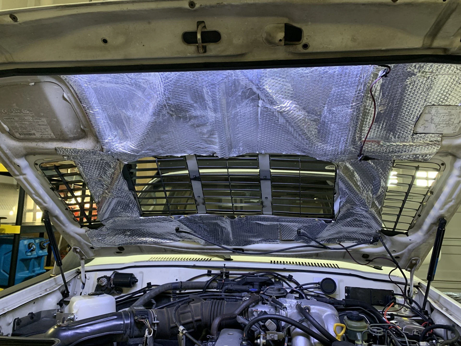

I will be watching this because I was looking at these exact ventsAnyone in this thread know how important the framing of the fzj80 hood is? Can it be cut into? I have some vents but the slats in the vent drop down below the mid point. See photos. Not sure if it will work to use these vents. If hate to trim them...and would be willing to cut the hood open if the frame is not super important. Bummer, I was under the impression that these vents lay flat on the hood.
Looks like @Hoosier Daddy did the same kit. Maybe you could PM him and ask about it. He's on this same thread on page 2 or 3Anyone in this thread know how important the framing of the fzj80 hood is? Can it be cut into? I have some vents but the slats in the vent drop down below the mid point. See photos. Not sure if it will work to use these vents. If hate to trim them...and would be willing to cut the hood open if the frame is not super important. Bummer, I was under the impression that these vents lay flat on the hood.

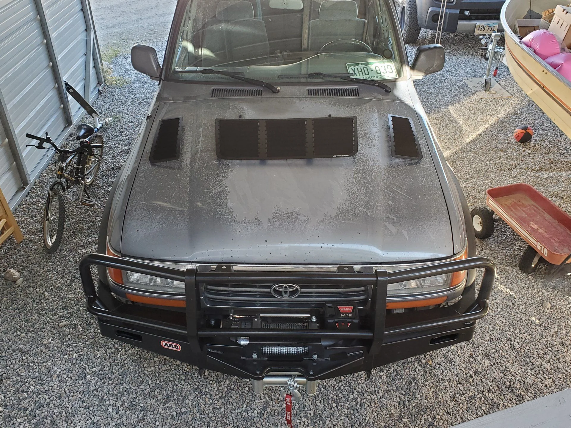

Did you remove the frame from the hood? Did it have any negative effects? I just got the exact same louvers. Thanks in advance for any help you can provideOrdered the trackspec kit. Can’t decide on doing the center or not. Thoughts?
I like the way it looks. The side driver vent is right above the fuse box. Will this be an issue?

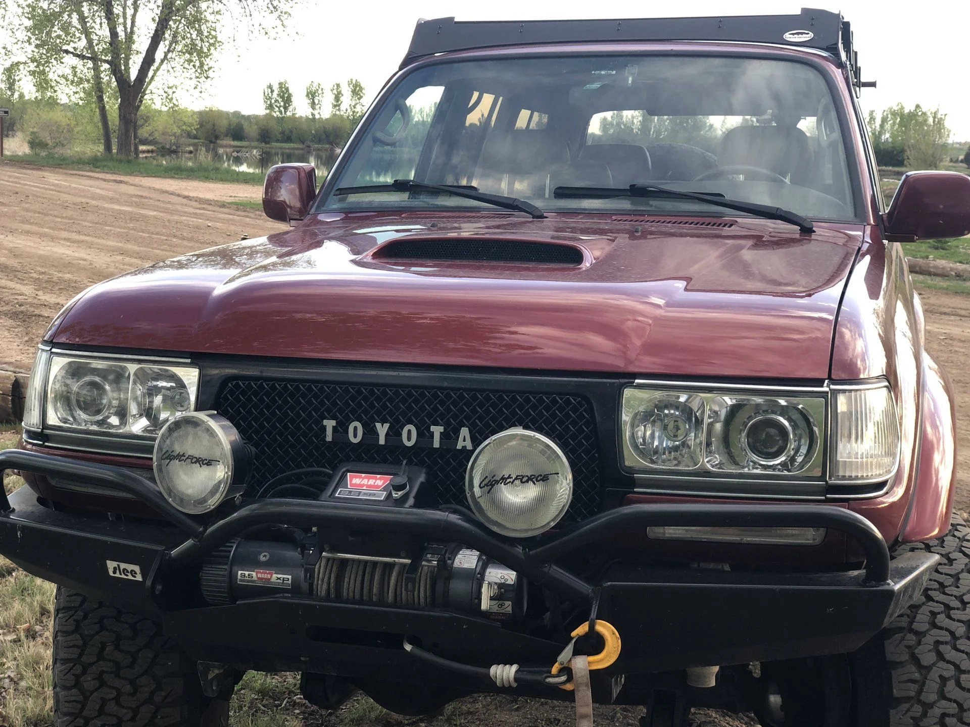

First post ever, build is well under way so I thought I would finally share.
Thanks for reading!
1992 Fj80
Thanks for the heads up. I dont think I gave the photos time to load, so I missed that.Looks like @Hoosier Daddy did the same kit. Maybe you could PM him and ask about it. He's on this same thread on page 2 or 3

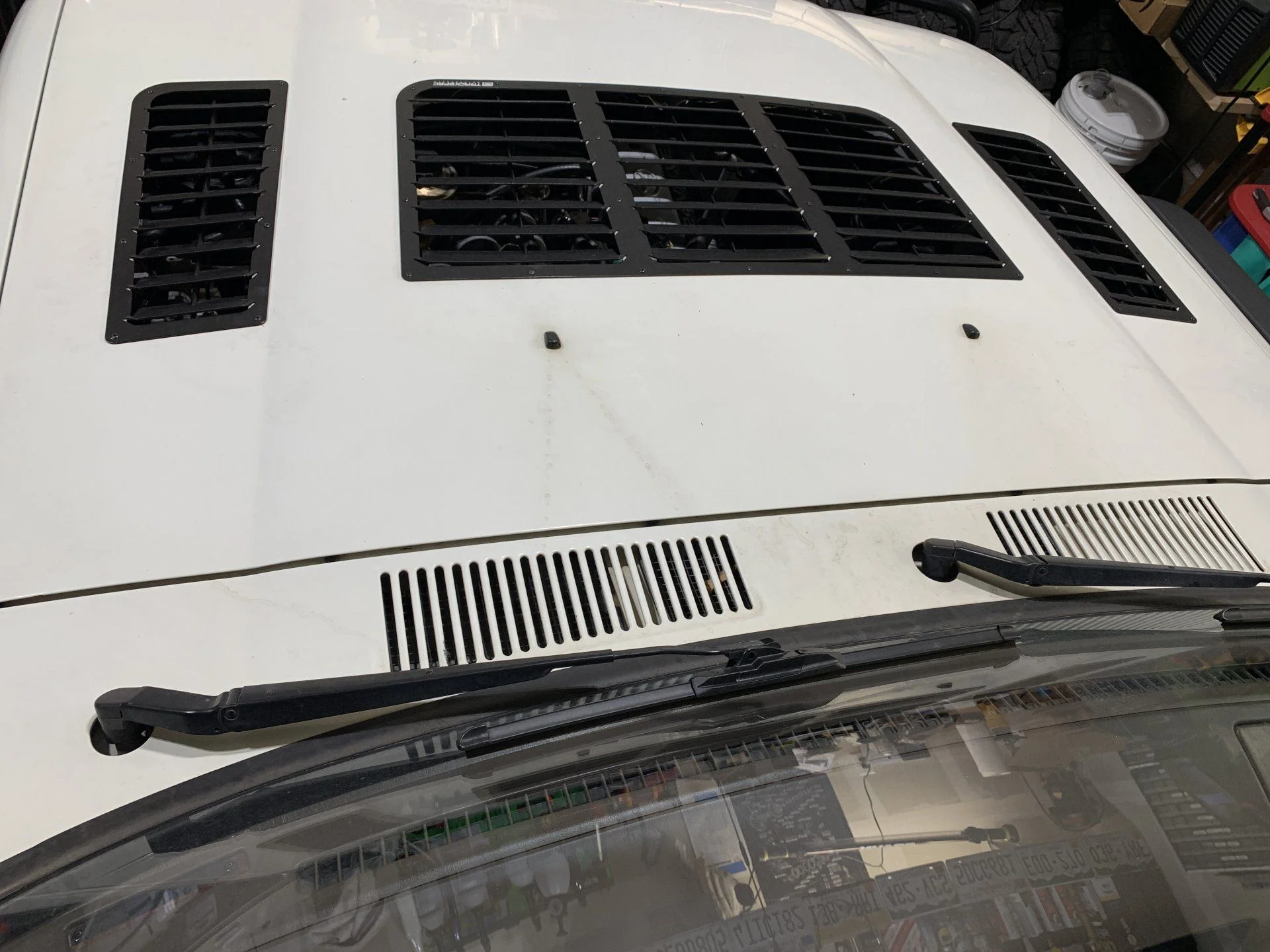

Yes! Save my life dude. Thank youI installed these a while back. I cut the supports and re-bonded the factory brace. I also added an aluminum brace in the back. The vents actually add a bit of bracing back into the holes. Here are some pics...hope it helps.
Thats what I'm talking about. I want that 180 degree life. I'm sitting at 185 and spiking when I park. No more!None, and water ingress hasn’t impacted anything. Plus, now I drive around at 180F all day long![]()
I also want the same setup, but I'm a little worried about messing up the paint because my hood is raptor linedI installed these a while back. I cut the supports and re-bonded the factory brace. I also added an aluminum brace in the back. The vents actually add a bit of bracing back into the holes. Here are some pics...hope it helps.
