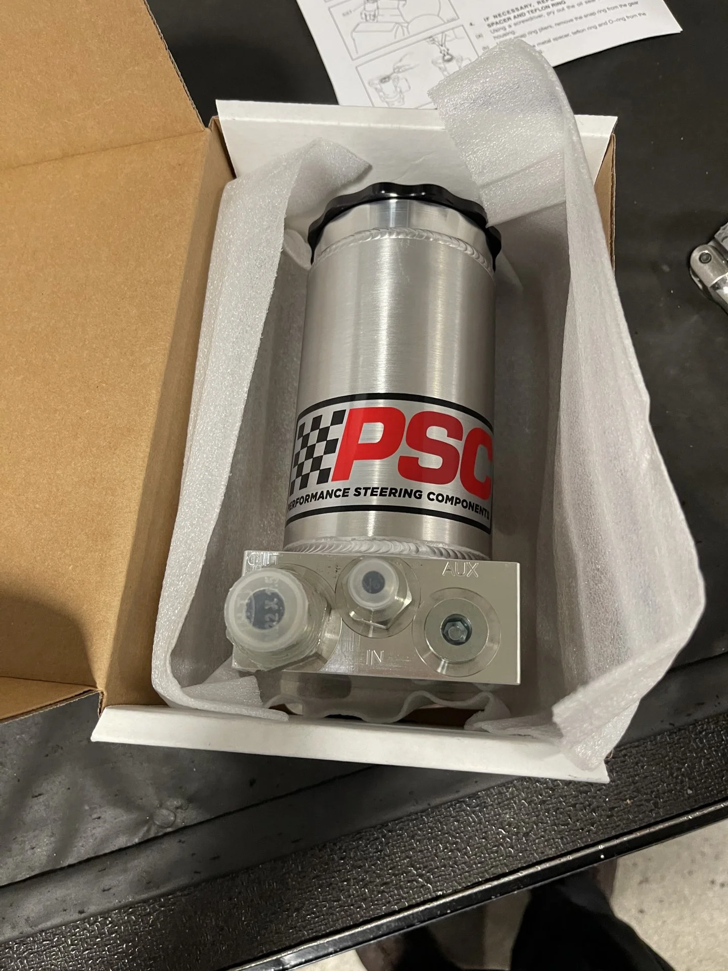

Okay after some thought, i returned that reservoir and ordered the psc sr146..

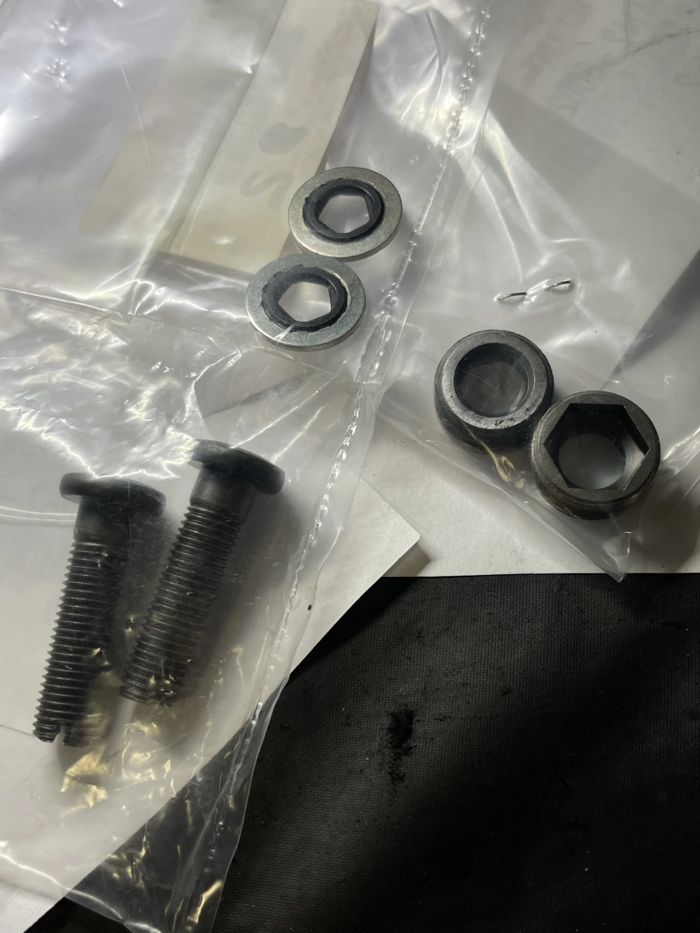

@Broski you got a 105 sector shaft, did you get a new adjustment screw and nut? I was looking at @Box Rocket 105 sector thread and he replaced his. Anyone have part numbers for those 2 parts?
Okay i ordered 2 of each of those part numbers..

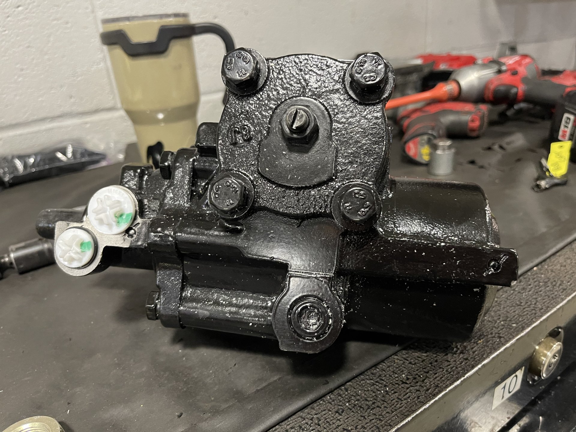

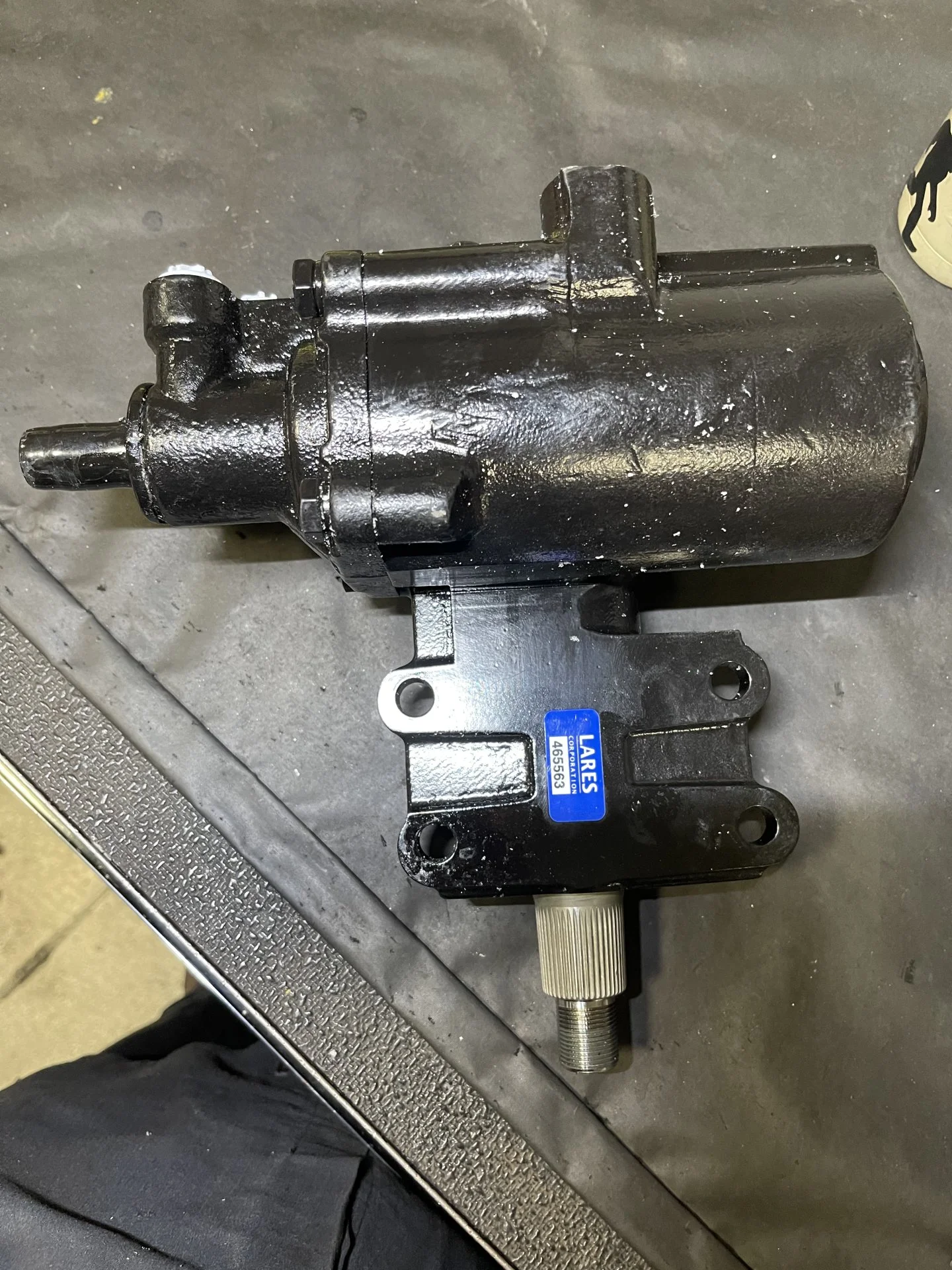

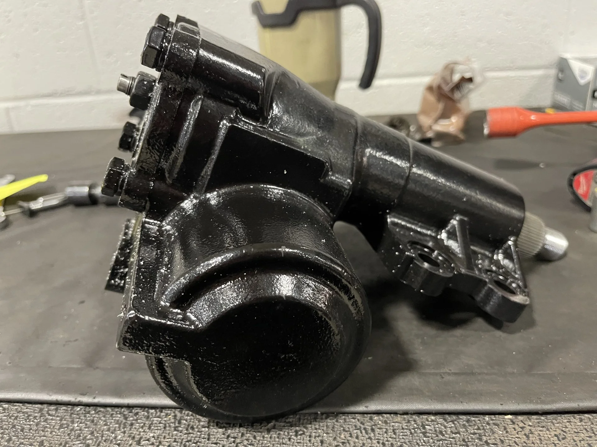

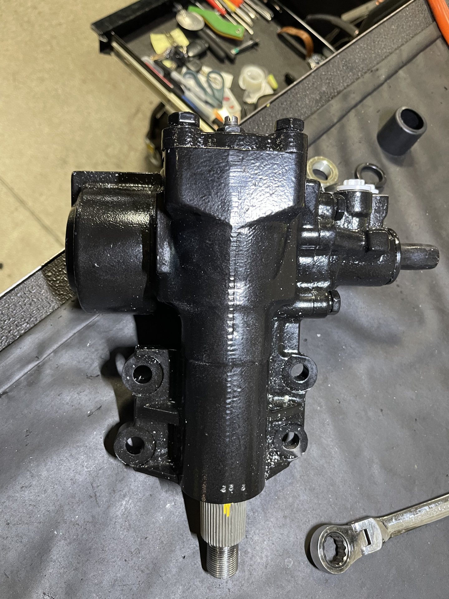

My lares steering box came in today, heres some pictures, its seems kinda suspect to me. What do you all think, keep and build, or return?

Ordered one last week and got it in today with the remote antisplash kit. Sucker is beefy! Bit bigger than I expected. Does have a nice internal filer but seems like it will take up some space for fluid meaning less capacity.... Looks like a huge step up from factory tho.
I guess i could put this in my truck and use my original box as a builder.. thats more work than its worth probably, otherwise no cores available to me..

I bought a box with a twisted sector for cheap n put my 105 in it.
Some guys break em clean n toss em, you could post a wanted add for one that has a broken shaft.

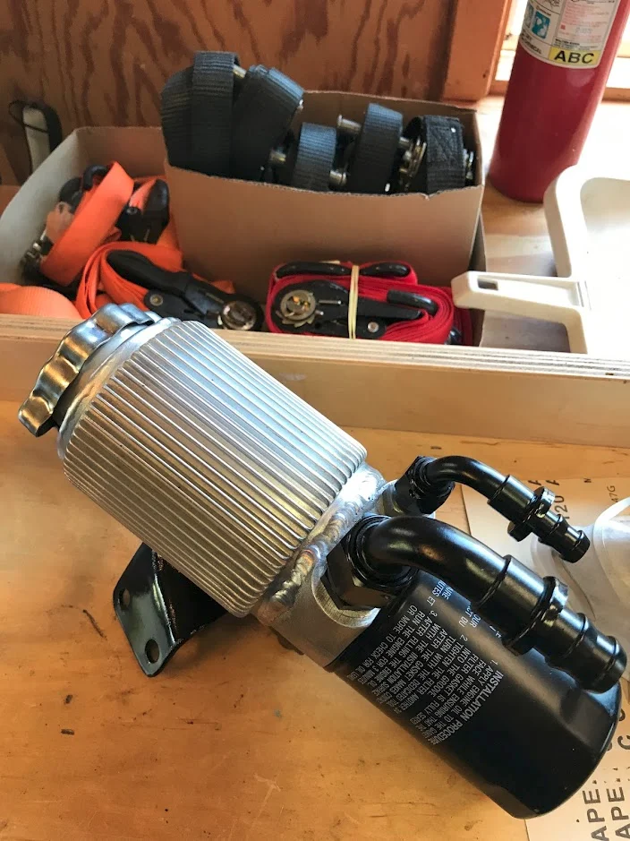

I'm running this one form Appleton rack and pinion. It utilizes the same filter that the 1FZ uses and I like the cooling fins

That said, i see people drilling the steering box in many different places to tap in for hydraulic lines. I understand we need the power steering pump pressure to push the ram back and forth. Im going to post a handful of example photos(mostly found on mud and ig) so we can discuss reasons for placement, but also which part of the box goes to which side of the ram, and the rams positioning in general.
