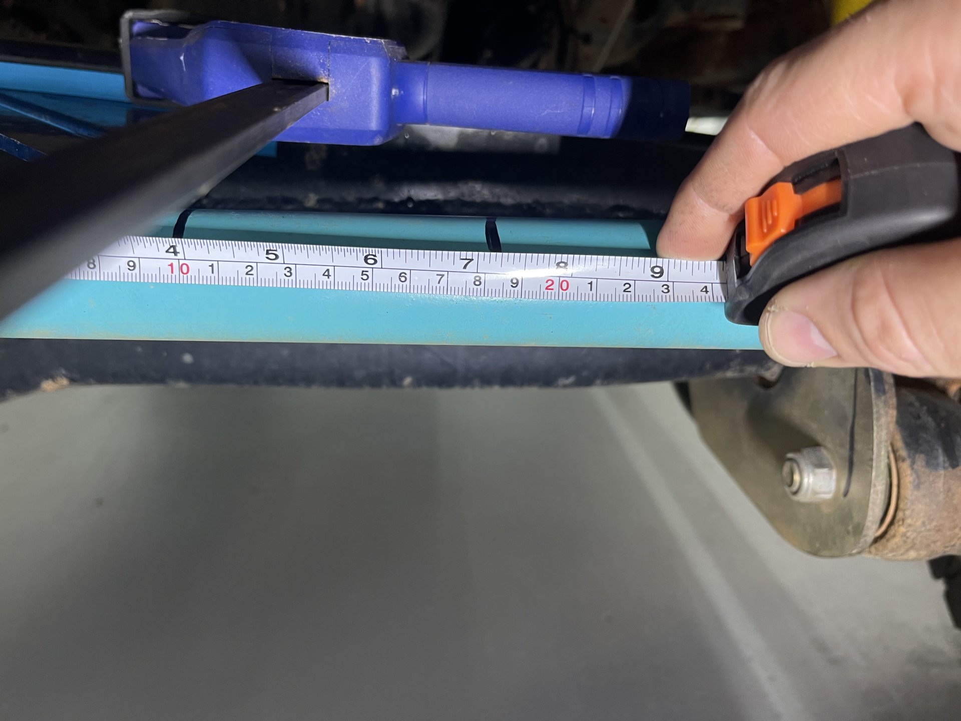

Today i measured my steering travel lock to lock. I have approximately 7.25” of total travel.. Unlike a stock steering arrangement, my steering is on the front of my axle. My tierod is mounted closer to the trunnion bearings on the steering arms, which makes for a shorter total sweep than a stock behind the axle tierod.. I clamped a square to my truss, marked a start point, had the wife steer it to both ends and marked them, then measured the length of the outer marks, that simple..
