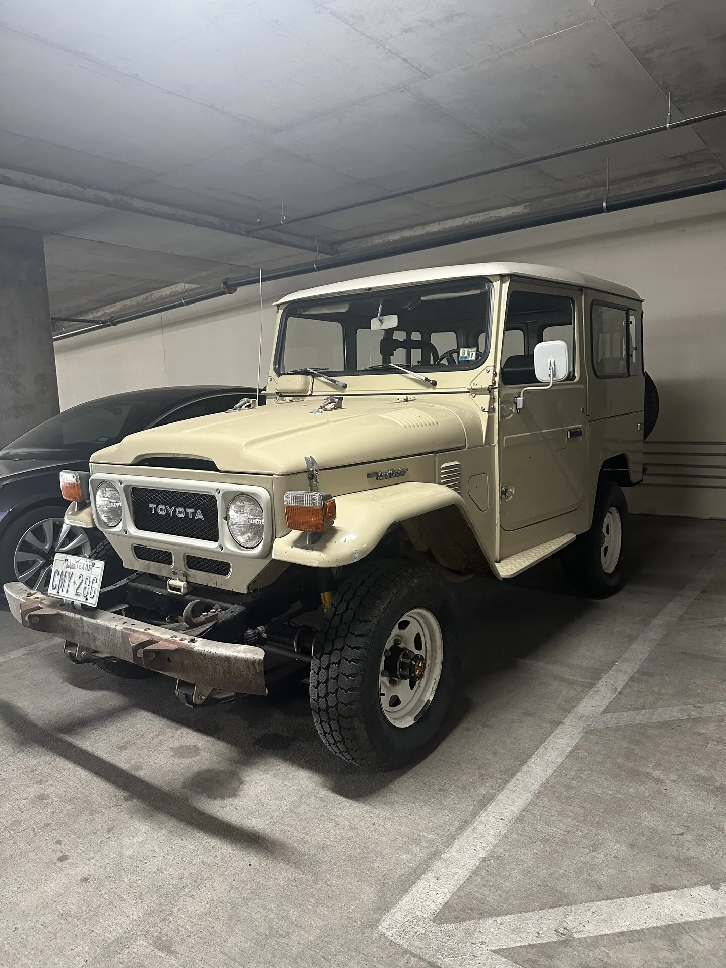

I just bought my Land Cruiser 81' today. My dad drove it 30 min home as I can't drive stick yet. Everything felt good. However, he noticed rhe RMP's sounded high when at stops or when starting up the car. Almost like the choke was on but it wasn't. Could it be something with the Carb? Anyone else have similar problems? Sorry if that doesn't make sense and TIA .
