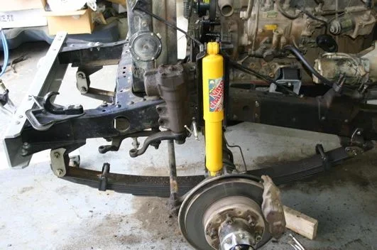

But that little rant aside, I worked as hard as I could to mount the shock tower as far back as possible (to make the drag link/tie rod as parallel as possible to the relay rod). I just tacked it into position here to check fitment.
And here's a wider picture. This shows how far back I can get the 60 series steering gearbox. It's better than others I've seen posted up, but it's still not entirely parallel.

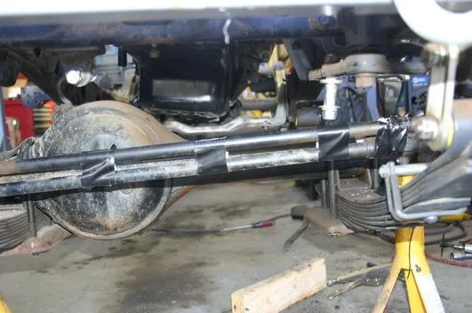

So I wanted to mock up the tie rod to see how it worked. Of course, I don't have anything the right length, so I got creative with some duct tape.
Here's some pictures showing the tie rod angle compared to the relay rod.
In this picture you can see the steering turned full leftt. It doesn't bind or anything, and the knuckles move from stop to stop.
I'm really not sure if that's acceptable or not. Any input? Like I said, the knuckles move from stop to stop, and the steering gearbox has about a quarter turn left in it when it gets to either the left or the right stop. But the angle seems a little excessive to me--am I just being too picky?

okay, you will need the 7* cross link, the 1979 and newer ball joints and you are ready to play. no cutting and no welding required.
Lowenbrau enlightened me to this setup. good man, that one...
I've read that. I like that. Toyota parts make me happy. Looks like I'll need to get the credit card out for an order.... The 7* cross link has a tab for the steering stabilizer, correct? And I just need one from any LHD 7* truck, yes? Like 45450-69085?
How does that angle look to you? It looks good compared to other 60 series conversions I've seen on MUD, but before I go crazy making everything permanent (it's just tacked in right now) I want to make sure I'm not missing anything.

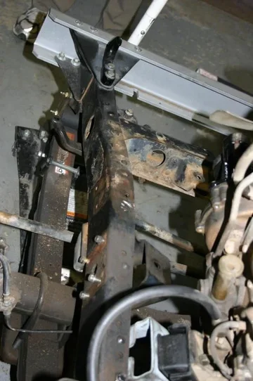

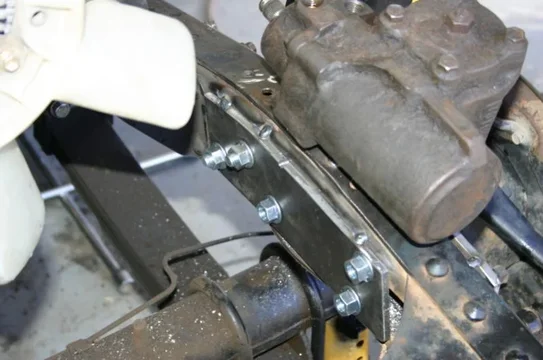

Also, I've been working on the 60 series PS conversion (when this is all done, I'll probably write up a single thread for the 40 series FAQ on it).
The plates on the frame are just tacked in position, and I just drilled 1/2" holes for the time being.
But here's how it lines up with the steering gearbox and Ftower bolted on.
And some detail of how it sits. Compare this to crusher's response in his 1HZ thread and you'll see I've got the PS box a little more than an inch farther back. My tie rod isn't quite parallel, but close enough to it. I like where this one sits.
And the back side... I made the inner frame plate long enough to also get the bolts for the F-250 shock tower. Right now it's just 1/2" holes for the bolts, but I will eventually sleeve the bolts with 1/2" Schedule 80 pipe (the I.D. is just over 1/2", and a 12mm bolt is 0.47" in diameter). you'll notice that the aftmost upper PS box bolt hole is a bit high on that sheet. I'll weld on a little ear to give me something better to drill into and attach the sleeve to.

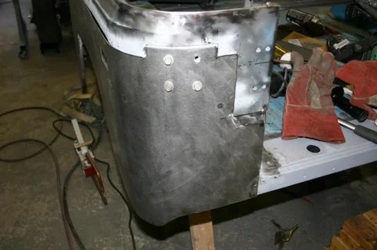

Look ma! No clamps!
Just spot welded on the left side. I'll finish the welds tomorrow, and hopefully put the right side on as well.
I looks and feels good to get that done. The right side is ready to go, I just have to put a couple holes in the flange by the rear doorjamb and the right side is ready too.

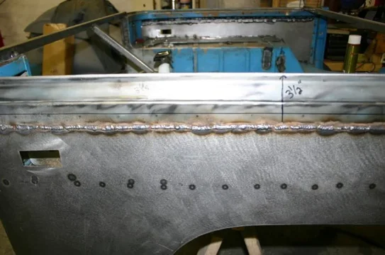

Welding the seams of the quarter panels...
Left side tacked up.
And the right...
And a closeup of the welds on those seams. I'm happy with them. Flanging the original metal made welding that sheet metal seam very easy.

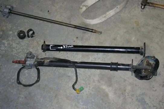

So, with the 60 series PS swap, we've got to do something about the steering column. Since this is a factory 40 with PS, I didn't want to cut the original column at all (since someone would probably find that most useful with the 40 PS box).
So, we got a column from an FJ-55. Here's the 55 column and the 40 PS column. The 40 column has the rag joint on the end, and still has the "bucket" that goes through the firewall on it. The 55 column is the one with the splined end (those splines just happen to match the splines on a 60 series gearbox).
Here's the disasembled 55 column. There's really nothing to it. All the "bits" from the 40 will attach to this seamlessly (like the ignition, the plastic housing, etc...)
But here's where some work is needed. The 40 column is about 35mm shorter than the 55 column. That little bit (a bit more than an inch) really makes you feel like the steering wheel is really in your face.
I'll come back to this in a bit.
