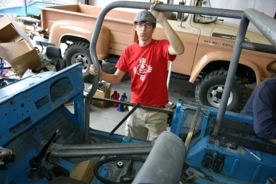

Then I had Paul sit in the driver's seat to get a good picture of how close the MT cage came to his head. He's tall (6'2" maybe?).

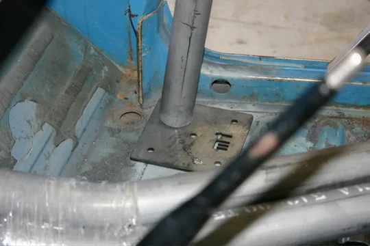

Here's a pic of the underside on the right, showing the cage plate bolted to the topside plate, just so I can start figuring out how I'm going to tie the cage into the frame....

After pappy got his MT Jackson cage pre-welded, I was a bit worried that the cage would be too "short" in our truck. I'm sure the pre-welded models are a bit smaller just to make sure they fit in all the trucks, but I want to save every inch possible inside, AND I'd already done the bodywork on the floor to make room for the MT cage plates.
Luckily, the cage kits come with the front hoops still long, so no worries at all.

And Paul holding the front hoop up for me to get a pic of it's fitment...

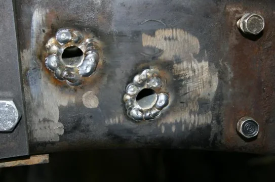

I also sleeved the bolt holes for the shock tower and welded the inside frame plate for the PS gearbox on.

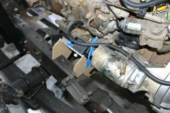

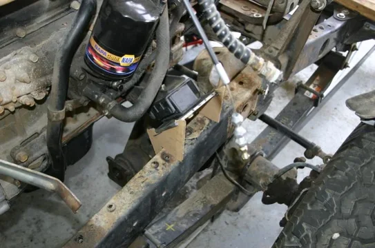

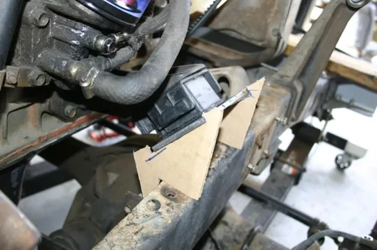

Since I had lowered the crossmember, I decided I should stop procrastinating and get to fabbing up the motor mounts. It really wasn't as bad or hard of a job as I was expecting. I took maybe 5 hours to them them pretty much done.
I'll let the pictures do the talking, but I used 1/4" sheet steel, cut with the plasma cutter for them. But I started with some cardboard...

Then I tacked them into place...
The right side...
And the left side. I know that the stock radiator core support rod won't stay in that form (it hits the steering shaft), but I went ahead and put a hole in anyway just to make it work if I wanted to. If you were keeping the original steering gearbox then this would work beautifully.

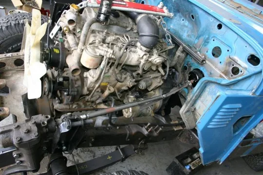

An overview of the engine in the frame.

That's it until next week! Those motor mounts will work well I think. I'm much happier with the angle the engine sits now, and the motor mounts are compressed perfectly with these. I'll probably gusset them a bit, and there's the already mentioned spacer/stiffener between the top of the frame and the motor mounts, but they're pretty much checked off the list!

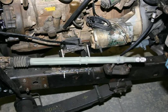

I won't get too much into the steering setup here, but when it's all said and done I will do a complete write up on just the 60 series PS conversion I did in the 40 section. That said, you can see the trick we used here to make it all work in these pictures. The parts are basically an FJ-55 steering column, and an FJ-62 steering shaft.
I did have to lengthen the FJ-62 steering shaft. you can see my cut and splice pretty clearly here (just look at my not-as-nice-as-Toyota's welds). I even managed to keep it straight within about 1mm, not bad for my primitive means.
I still need to figure out what I'm going to do to connect the pitman arm to the knuckles. I think I'll be using a stock 60 series pitman arm tie rod, a custom tube and a TRE that mates to the stock FJ-40 TRE on the right side knuckle.

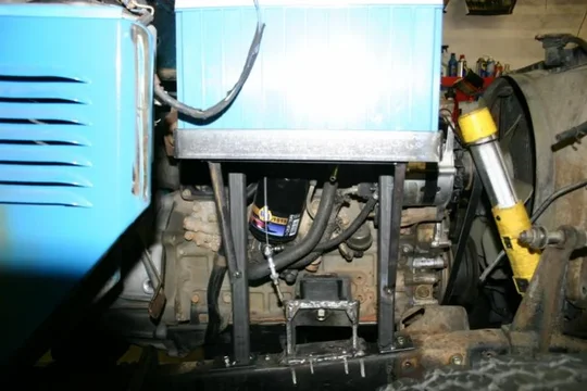

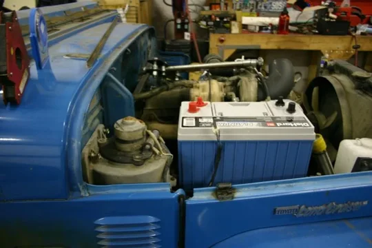

Anyway, I got to fabbing up a battery tray....
The battery is a group 31 Diehard Platinum. This single battery is a pretty good alternative for a dual battery setup. This thing has HOURS of capacity at more amps than all the accessories on the truck can draw together, so I like the simplicity of the single battery, but the MASSIVE capacity of this one.
First off, it all fits, and I've even got plenty of room to fit my hand between the battery and the hood when it's on.
Here's a pic showing how it's constructed. I used existing bolt holes in the frame (the original battery tray bolt hole in the front) to attach it to the frame, 1"x1"x1/8" square tubing, and a little bit of 1/2" angle to support it.
I will also attach a small bracket (or rubber perhaps) between the battery tray and the fender/apron bolts to support it a bit more at the top too.

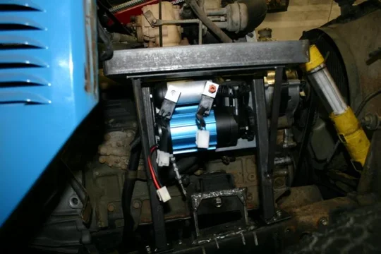

And underneath the battery there is BARELY room for the ARB air compressor.
There is not much room at all to work with. But I think I got it with enough clearance from the engine so that when it torques over it should still clear the battery. I will also add a heat shield on the back corner to protect it all from the heat of the turbo and exhaust. Additionally, I will add a small plate on the front of the assembly to mount the power relay for the compressor.

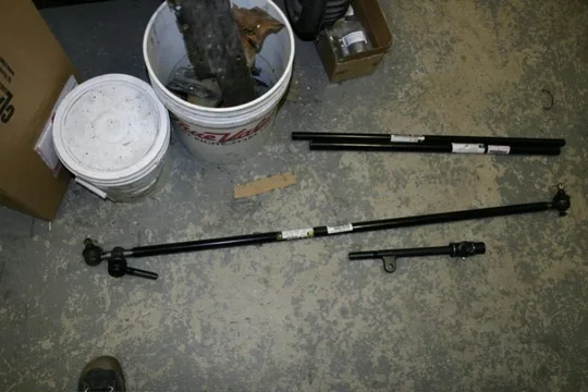

So, I stopped by American Toyota today to see what CDan could order for the last of the steering linkage....
Turns out he had everything I needed on the shelf! Good stuff.
So, here's what I bought:
  1. FJ-60 LH Relay Rod End (goes into the pitman arm)
  2. FJ-40 LH Tie Rod End (comes with new tube, and I already have a new 555 RH TRE)
  3. FJ-40 RH Relay Rod End (that goes into the RH TRE)
And the part numbers...
And here they are mocked up together.
I'm going to order a custom Relay Rod tomorrow threaded on the left side for the FJ-60 Relay Rod End, and threaded for the FJ-40 Relay Rod end on the Right side. That will be the only non-Toyota part in the steering system, so I am pretty happy with that.

I finished up the battery hold down also. I took the original battery hold down and cut out the "T" pieces, then welded on some tabs and used some simple clamps to let the "T" pieces rotate. I think it came out pretty slick! You can also see the fan motor that Dad prettied up. I'd say it looks great, don't you?
And here's the front of the battery tray--you can see there's just not much room between this and the fender. I will make a small bracket from the holes for the ignition coil to help keep it from flexing from side to side.
