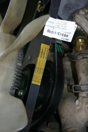

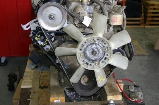

Ever wonder what belt you would use if you made your own PS pump bracket that moved the alternator 5cm farther out from the engine?
Oh look, the correct PS belt fits that PS pump bracket I made (swish!)
And just to prove to myself that it all looks normal.... here's both belts installed.

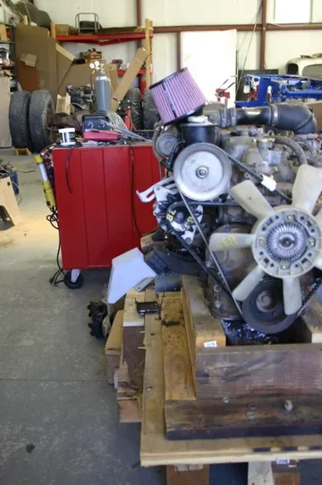

So, I cleaned up the motor mounts (because I'll be attaching them to the frame pretty soon). Problem is, when I bolt them to the rubber isolators on the motor they don't sit "square" in the vertical plane. The inside frame rails look square to me, but bolted securely to the motor the mounts are about 15 degrees off of vertical.
The frame side mounts came from a BJ-40, so I'm sure they are correct for the frame/engine. But the motor came from a BJ-73, and I'm wondering if the motor mounts that attach to the engine block are at a different angle than for the 40 series. Apparently I didn't snap any pics of that bit, but I will when I get home. If the 40 series and 70 series use a different motor mount on the engine itself, I can either look to replace the mounts on this engine with 40 series mounts, or I can fabricate some custom frame side motor mounts to mate with the motor mounts/isolators on the engine.
Or am I making too big of a deal out of this? If I simply attach the mounts to the frame and set the engine down will it end up square?

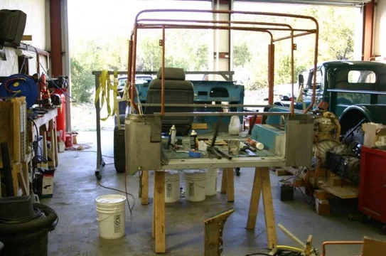

And lastly, just because I haven't looked at it nearly put back together recently...
It's getting REALLY close to welding the quarters back on. The left side is just waiting for me to spot weld the soft top bracket on, and then the quarter is ready. The right side has maybe 3-4 hours of rust repair left before I weld the quarter panel back on (if that--that's what it took me to do the left side--same repair).

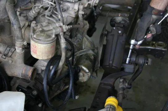

So, with the crossmember in place, we set the motor into place to start making some motor mounts.
Problem: the factory steering gearbox interfered with the starter on this 3B (which came from a BJ-73), and pushed the motor WAY over to the passenger side.
With the motor like this, the output shafts of the T-case didn't remotely point towards either differential. So, we removed the steering gearbox.
I don't know if this was because this 3B was from a 70 series, or because I shifted the whole thing a couple inches forward (but the starter was pretty much centered on the steering gearbox, so it would have had to move back a good 3" to clear).

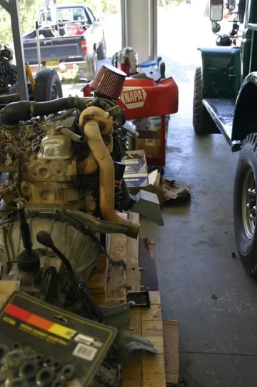

So, with the steering gearbox removed, here's how it lines up...
Pay no attention to Dad holding the Donaldson filter there, I'll discuss that in a bit. With the radiator support and fan shroud installed, it centers up nicely.
And here it is from the side... Looks to be about right as far as the angle goes.... At least to me it does.
And here's how the transmission/transfer case are lining up there...
Looks to me like it's lining up with the driveshafts and differentials just perfectly.

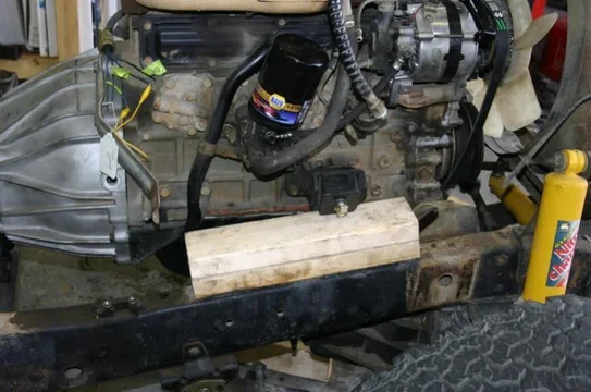

But there's a small problem, which you can see in the side view above. The motor mounts at pretty high. The engine isn't completely level, so the right side motor mount will come down a little, but I'm not too sure how far. Maybe an inch, maybe two?
So here's some closer pictures. Don't mind the battery tray--it won't fit either way, so I'll be fabricating a battery tray into the motor mount I build--but I was wanting a bigger tray anyway, so it's not too bad.
Here's how the left side looks. Much better IMHO.
Now, I could lower the whole thing (transmission and all), but I'm not sure how far below the frame I want to go with the T-case and crossmember.
Are these motor mounts going to be a problem? Since they are above the frame, they won't be pressing directly against the frame. I've never seen a motor mount like that before, and it sounds a bit wierd to me. I'm guessing that the B motors installed in 40 series trucks had different motor mounts bolted to them, which were lower than these 70 series brackets. Am I correct in thinking that?

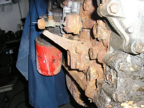

ah, the engine side mount peices. yes the 70 is quite a bit different from the 40 series mounts...
Exactly. Looks like 12311-56030 for the right, 12315-56011 on the left for the BJ-42. Looks considerably different in the EPC for the BJ-52, than the BJ-60 or 70/73. I think that's where the problem lies.
Time to make some calls... Engine mounting brackets from a BJ-42.... That said: the BJ-40 uses 12311-56010/12315-87304. Anyone have a good picture of the difference between the BJ-42 and BJ-40 engine mounting brackets?
Dan
I can take a snap of my BJ42 3B - its on a stand with the block brackets still on (don't mind the rust). I also have the frame brackets. I can post a pic @ around 4:30 PM Pacific when I get home.
Fantastic! That would be much appreciated.
I'm going to go tack up some mounts to make what I've got work, just to see if I like it (or how much I hate it).
Dan
as promised
another left side
You weren't kidding about the rust! :)
I like that RH engine mounting bracket a lot more than the one I've got. I'll have to get one...
