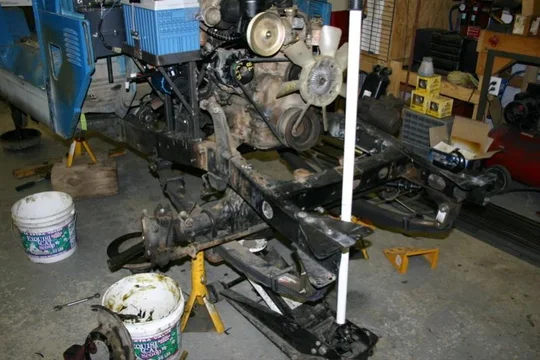

Dan looking good! Are you going to have heat problems with the turbo and the close proximity to the battery? It looks close, but could be the photo angle.
I think it should be allright, but I will still fab up a little heat shield out of 16GA to protect the battery from the exhaust. I was just going to weld two M6 bolts to the side of the battery tray, and then bend a 90 degree piece of 16GA, about 6" tall with two holes for the bolts.

How about a turbo heat blanket?
I may end up doing both the heat shield and a heat blanket. I really like the idea of having the heat go out the tailpipe instead of into the engine bay.

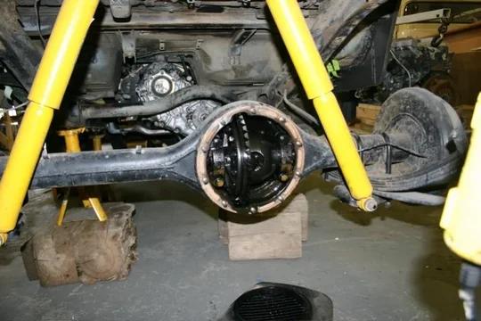

Because we were going to install ARBs, alia176 came over and we started doing the differential stuff. We took a baseline gear pattern: first one we took though had a pattern neither of us had ever seen. It was really, really odd. So we adjusted the carrier nuts a bit, and it came out to be a perfect pattern. It had kind of high backlash when we started, so I'm guessing that had a lot to do with the weird pattern. But here's what we had with a few turns of the spanner. Not bad at all, the gears have no real wear that I can see.
On the left rear though I found something alarming: I don't know what exactly it is, but it's not good. I think it's just a failed axle seal allowing gear oil to mix with brake dust, but this truck didn't pull at all before, and had fine brakes.

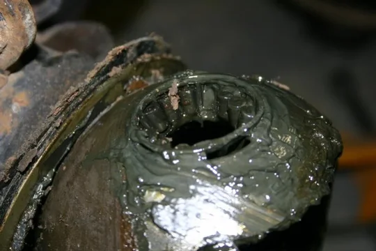

Then I moved on to the front axle. On the right knuckle I knew something was no good when I didn't need a hub socket to loosen the hub nuts. They weren't even hand tight. Dad has owned this truck for about 4 years, and this is the first time we've been into the axles. It drove perfectly before we took it apart--amazingly.
Anyway, here's what came out of the right knuckle. Not birf soup. Not grease. Not oil. I really don't know how to describe what was in there--but it wasn't right.

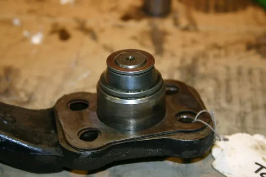

On to the left side. This is the scary one. Again--this truck drove perfectly straight down the highway at 65 mph. I would not have EVER guessed this was in there...
With the knuckle itself removed, here's a better picture of the failed trunion (knuckle) bearing.

Here's the steering arm from the left knuckle. This is stuck on there something fierce. I'm afraid I'll have to cut it off of there or grind it off (carefully).

rear brake, yep axle seal leak.
front, minor axle seal leak.
kingpin bearing, seem MUCH worse. a very sharp cold chisel works wonders at getting that race off. work both sides and use a file to smooth the retainer once completed. it comes off easier than you think.
front ends are ugly to work on, rubber gloves, old preused rags and lots of cleaner. going back together is a messy job too.
that truck is going to run like new when you are done.
Good to know. I'll try that before I break out the die grinder then.
I rather like putting them back together. I have never had one NOT drive like it was new, and now I'll know what is in there, so then I just have to do preventative maintenance from now on, and not have to worry about fixing broken stuff so much.

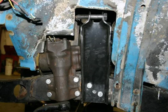

So, for the 60 series PS conversion I had to do something with the steering stabilizer. I could just not use it altogether, but I like the idea of leaving on there, since we've got it just sitting here....
So, I knocked the rivets off of the factory stabiliser bracket, and moved it towards the passenger side a bit. I actually just mocked it into place by reusing the hole farthest from the steering gearbox to bolt it to the frame (if that makes any sense). The picture should explain what I'm trying nicely.
I am still waiting on my relay rod to arrive, so I can't be sure how it works until I have that and have bolted the knuckles back on, but I think this location will work fine and not limit the steering travel at all.
this picture shows the now vacant hole to the right of the now relocated bracket.
And here's how it looks bolted up to the 60 series drag link.

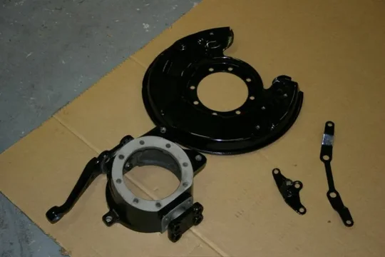

That's right. I powder-coated the knuckles, lower cap, and steering arm. I hate waiting for paint to dry, so this works just fine. :) They came out BEAUTIFULLY.
I also powder-coated all the other bits for the knuckles. Like the backing plate and the various bracketry. It really came out nicely. It looks like a mirror now!
And here's just a quick picture of all the bits for the left knuckle. The right is also done, and I'm going to try to do the backing plates for the rear axle this evening.

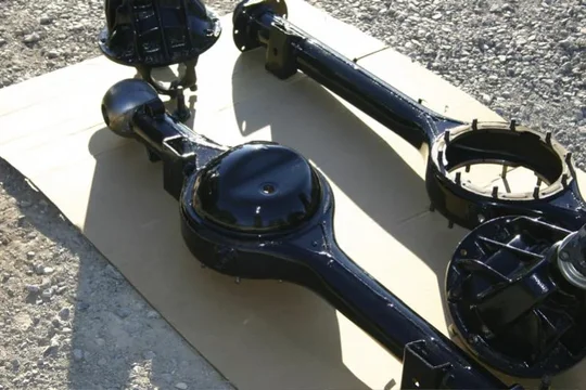

So, today we brought the axle housings back up to the shop. This is just two coats of POR15. Since the truck won't live outside, and they are on the bottom of the truck, Dad wasn't too concerned with putting a UV blocking top coat on, so we'll leave them this way.
They look like mirrors!

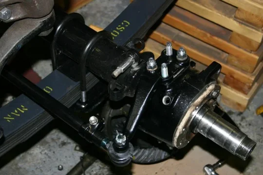

I also installed the new knuckle studs (with the E12 torx on the top). I also used good threadlock on them, so hopefully I don't remotely have to worry about these working their way loose.
With all of that done, I installed both steering knuckles. It was a really easy job with those clean powdercoated parts. While they were out I had run some sandpaper on the bearing caps and their mates in the knuckle. It made a HUGE amount of difference to knock down some high spots. These guys just took light tapping to seat. I just assembled them with two nuts per cap, because I decided that the washers were just too crushed to be of much use, so I'll buy some new shiny ones tomorrow to finish it up.

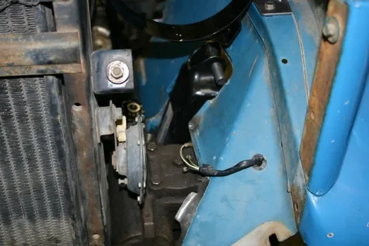

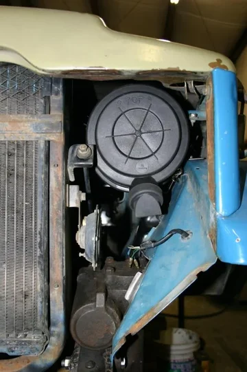

Then I finally stopped procrastinating and started fabricating a bracket to hold the Donaldson air filter. I used two holed in the fender to bolt the bracket to, to which the Donaldson ring bracket bolt to (so, the Donaldson bracket bolts to my bracket). I also drilled a hole in the fender for the second bolt of the Donaldson bracket, but I will need to buy or make a 1/2" spacer to make that bolt tight.
Here you can see my bracket, bolted to the Donaldson ring bracket.
And here's the filter in there...
And then I put the new fender on the other side of the truck (LOVE the fit of the Toyota fender--it's perfect!), bolted the apron to it, and set the hood on. It all fits--BARELY. I might have to cut the intake down just 1/4" to make sure the rain cap on the Donaldson doesn't rub on the hood.
So, with that done, here's the bit of intake I have to figure out. Pretty easy by the looks of it. I might swap this Donaldson out for one with an elbow air outlet, but maybe not.

Dan,
Is that Donaldson from the FPG series? I've been lookin at them online and when I called the local distributer I forgot to ask if the elbows rotate on the models with the elbow. I assume they do - would you happen to know?
