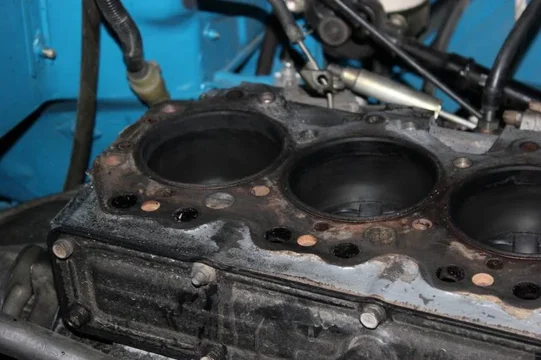

I pulled the head today. Easy as pie (literally did it during a little grill session at my sisters house).
Here's where I believe it is failed. When cranking, the engine was spitting out of this area from what I could tell. Also, the #3 and #4 Glow Plugs were really wet, compared to #1 and #2. Also, the aftermarket valve cover gasket SUCKS. Nice new Toyota one in the care package from beno...

The head is off! See any obvious signs of the failure? I don't from this view.

The engine surface scraped of the old HG. Is it normal to have the sleeves protrude so much from the block? Any telling signs here? I see no pitting to speak of, so that's a good sign.
