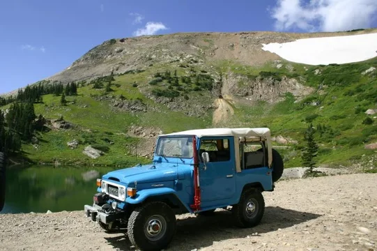

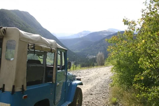

So, yesterday went up to Jenny Creek, which was awesome. Beautiful scenery, and the truck did very, very nicely.
Yes, that is the eastern end of the Moffat Tunnel in the distance.

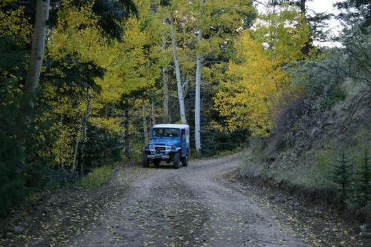

But that's boring talk: here's pictures of it. I took my mother in law to explore our property this afternoon, and the 854 mixed with the golden aspens is absolutely beautiful. Here's some pics:
