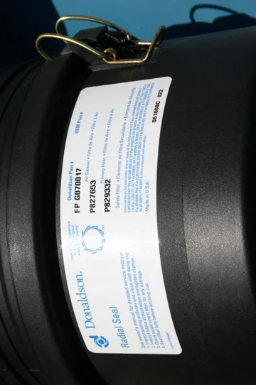

Is that Donaldson from the FPG series? I've been lookin at them online and when I called the local distributer I forgot to ask if the elbows rotate on the models with the elbow. I assume they do - would you happen to know?
They do indeed rotate.
It is an FPG. Since the inlet to the turbo is 3 inches, I just bought the FPG with a 3 inch outlet so that I didn't have to adapt between different sizes. A smaller filter would fit better, and certainly flow MORE than enough air but since it fits....
That's the part number for that one. IIRC, it's just the last two numbers that indicate the outlet (straight or elbow).
They are plastic, but they aren't in the least bit cheap. Actually, the metal band seems lighter than the plastic FPG filter.

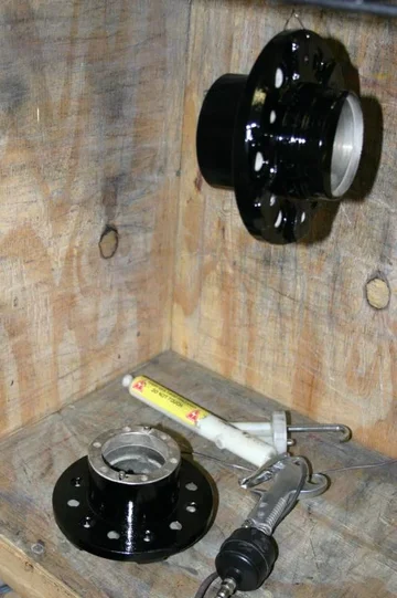

But, after that, Dad and I got a good bit of work done. Dad spent the afternoon cleaning various parts and prepping the front hubs for powder coating. That meant removing all the studs and getting them into the blast cabinet. We also made a fancy tool for loosening the bolts that hold the rotor to the hub by drilling a few holes in a large chunk of wood. It made it VERY easy to get them loose. Why didn't I think of doing that earlier?

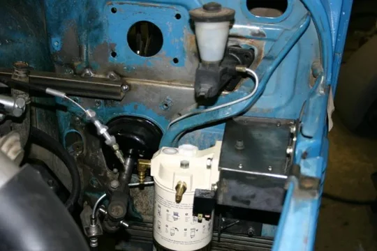

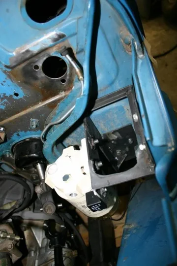

Then I decided to get cracking on a fancy bracket. It will serve two purposes:
  1. It will hold the Racor fuel filter
  2. It will have a small switch panel just for the starter and glow plugs--and all wired to bypass the rest of the truck's electrical system. Just a very simple way to get it started and drive home if push comes to shove. It's right by the EDIC, so it would be a one man job to start the truck right there.
I always like seeing the process for building the boring things like this, so I figured I'd take step by step pictures and explain the process if anyone is wondering how you fabricate stuff like this.
First I made a panel that matched the contour of the firewall. In my case, there were unused bolt holes that originally held the carb cooling fan. So, I made a simple plate that would bolt to those holes.
Next I tacked a vertical piece of metal to that plate. I set this at approximately the plane on which I wanted to mount the Racor. I also tacked a little gussett to this vertical piece just to stiffen it up a bit.
To that vertical piece, I laid another piece of metal perpendicular to it, so that it runs horizontally. In that piece of metal I drilled two holes to mount the Racor fuel filter.
Once that was done, I made a plate to use the other two bolt holes originally for the carb cooling fan. These are located just above the louvered inlet. I also cut a piece of metal to length to join the plate above the louvers and the bracket I had been making. This makes the bracket really, really strong because it's supported on two sides. It also slightly stiffens the wing of the tub a little.
And the same thing but with the Racor bolted on...
And a picture from the top, so show you how much extra room there is (not a whole lot, but there's plenty here).

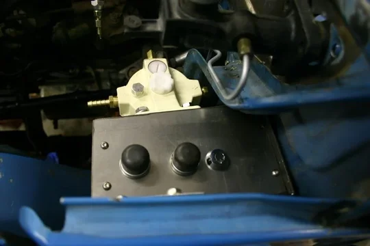

With that part of the bracket done, all that remains is to put some skin on it. On the top there'll be a single plate with two large pushbutton switches. They both have rubber boots to protect them. One will glow the glow plugs, the other will crank the starter.
Here's two pics of one of the switches loosely set in place to gauge the size and to see how much room I'm working with for the wiring. Plenty of room really.
The glow plug relay will be mounted on the fender I think, and the starter has the relay built onto it, so these switches (which are rated for quite a lot of current) should be more than adequate. I will need to figure out how to make some nice faceplates for the switch panel (and for a gauge pod inside the truck), I don't know how fancy a trophy shop or engraving shop can get, but I'm not looking for anything TOO fancy. Just a single plate with some labels, but they have to be able to locate them to match my switches.

Well, I finished up my little filter bracket/switch panel today. I like it!
First I cut the bracket a bit to make more room for the pushbutton switches...
Then I cut a bit of steel for the end, just to make it look a bit more finished on the forward end. I also cut a 16GA plate for it and drilled/tapped M4 screw holes to hold it all together.
That done, I drilled holes for the switches. On the far right is a security key that will shut off power to the two switches, which will probably just live in the glove box or tool box. Then there's two heavy duty pushbuttons, one will glow the GPs, and the other will crank the starter.
These are in addition to the normal controls. The idea is that if everything else fails, that one person could pop the EDIC control arm off, and use these two switches to get the truck running in a pinch.

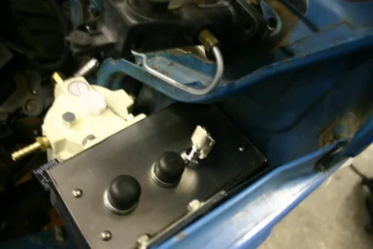

And here's the panel with the security key installed (because I know you were dying to know what on earth that would look like)
I also got some more powdercoating done. Here are the front wheel hubs. I'm waiting on new wheel studs to arrive (probably early next week) before I assemble it with the new rotors, but they are coming out nicely.

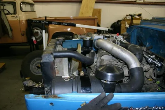

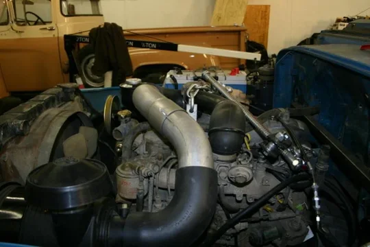

Last thing I got done today was to pretty well get my intake run from the Donaldson to the inlet of the turbo.
These 3" 45 degree bend pieces are actually Donaldson parts, and they bends are REALLY nice. You can cut them at any point and you will still have a full 3" diameter tube to weld to!
I like how it fits, but the only thing I'm not so sure about is if there will be enough flex in the two rubber elbows to account for the engine rocking and shaking, or if I will need to make a cut in the center section and put in a flexible straight tube section. Any ideas there?
Here's the intake:
That was easier to cut and fit than I had imagined.

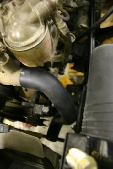

And some of the hoses I ordered (from a BJ-42).
And here's trying out the hoses. I like it! The upper hose has to be shortened just a bit because I mounted the engine farther forward, but no sweat!
Another view of the upper hose. You can see that the radiator is slightly pushed out because I haven't yet trimmed the hose.
And here's the bottom hose (at least the main hose, there's a short section that extends this to the radiator itself). It's going to work!

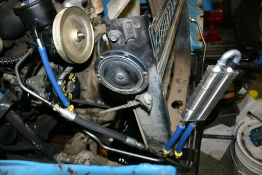

Well, yesterday I bought a bunch of hydraulic tube. That stuff is expensive! And then this morning I got motivated and bent it all up for the power steering. It's 3/8" tube, and I reused the fittings for the pressure line from the pump to the PS gearbox. I also had JIC fittings brazed on for the return line, because that way I could then screw on barbed fittings to make it all work out.
I didn't take any pictures of the process, but here it is all finished.
And the left side...
And here's the right side. The PS cooler obviously needs to be mounted to the radiator support, and those pictures are taken with everything loose, but that looks like it will work to me!
