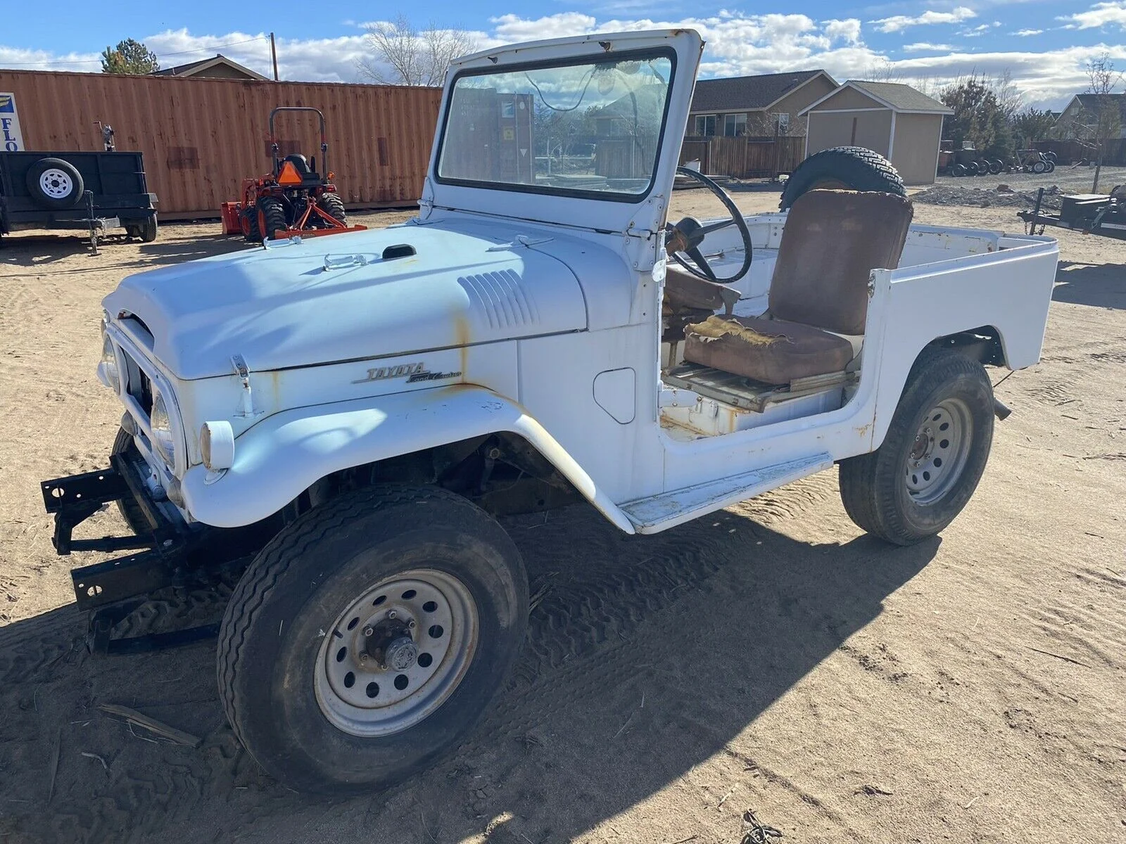

Anyway, after more than a decade of lusting for a 40 series I am finally the proud owner of a 1966 FST. She’s a project for sure, but I’m in love.

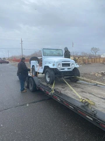

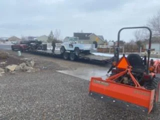

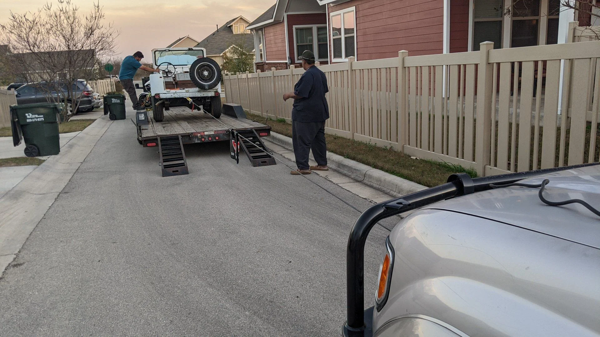

I picked her up in late January from the Reno, NV area in non-running and driving status. PO had to pull it up on the trailer with his tractor.

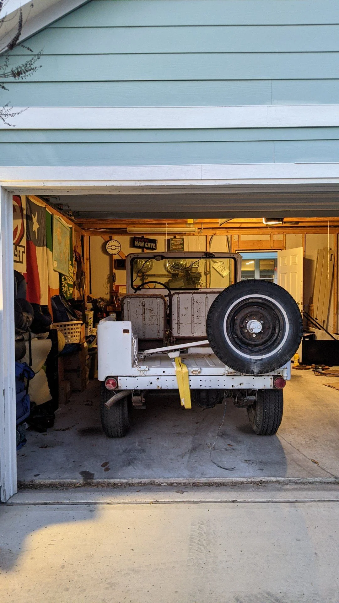

She’s arrived! Had to winch her off the trailer with the 80 and then push her into the garage with it’s bull bar which I thought was kind of fitting.

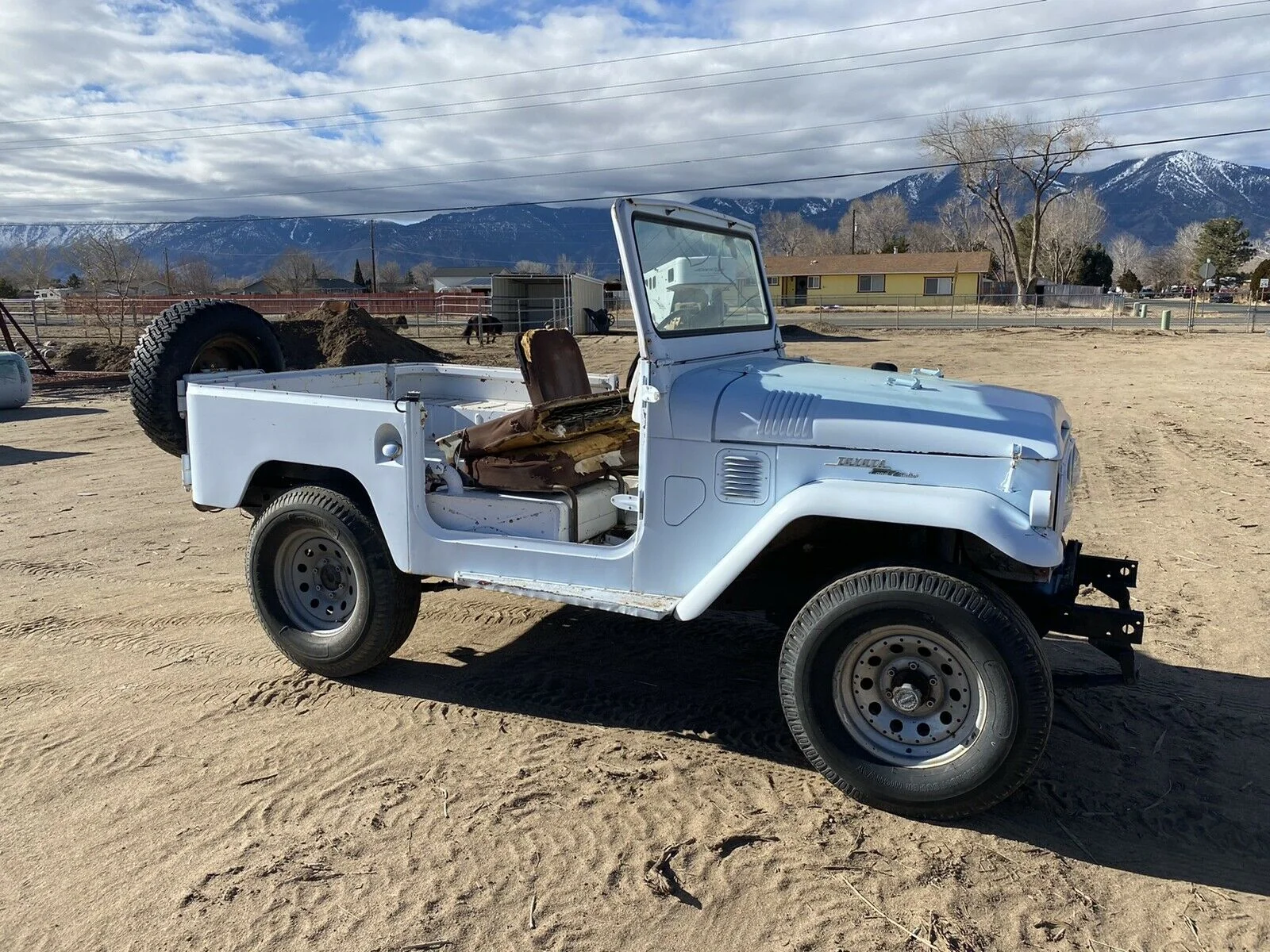

She seems to be very solid. Can’t find any substantial rust anywhere. At some point a PO sprayed the underside of the body and the frame with some sort of bed liner and painted the body white.
The original color seems to be that gorgeous spring green color. At some point I’d like to go down the arduous path of removing the crap white paint and revive the green underneath. That will obviously come later as my primary goals are getting it running and driving so I can enjoy it.

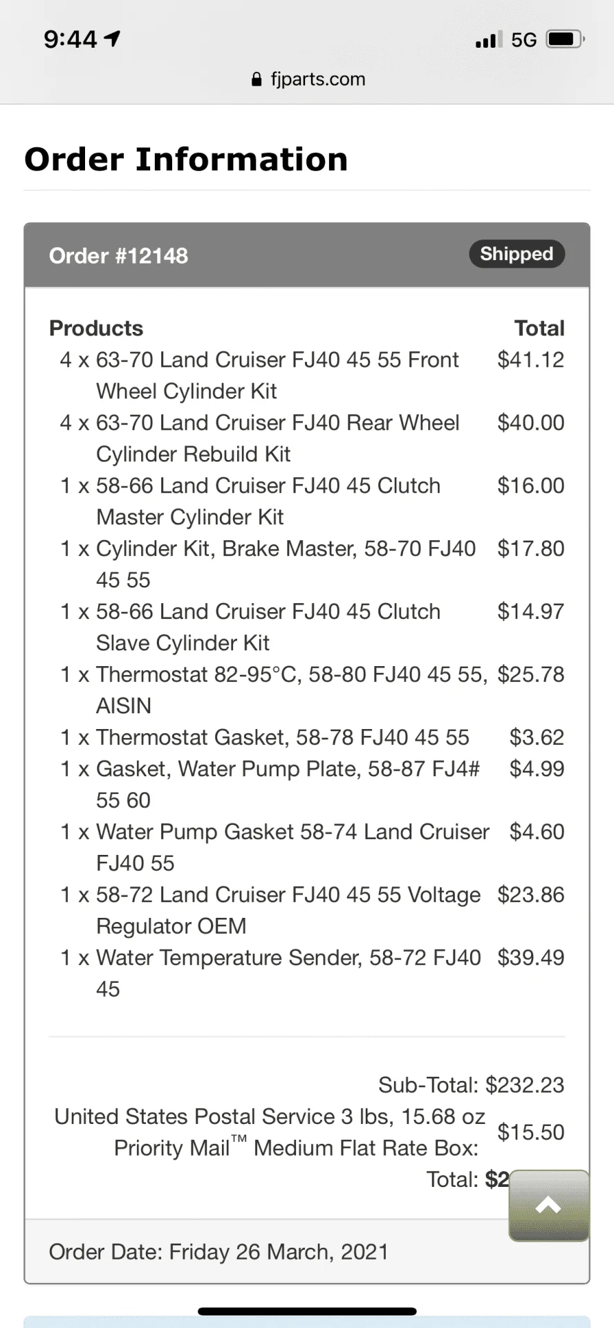

The wife graciously released some cruiser funds (after being placed on a freeze for buying the damn thing) and so the project is officially moving forward!

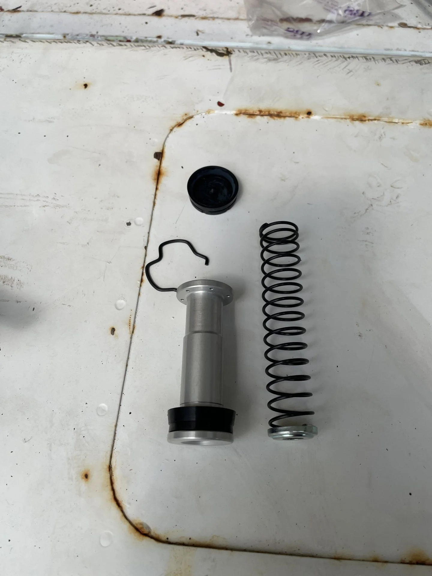

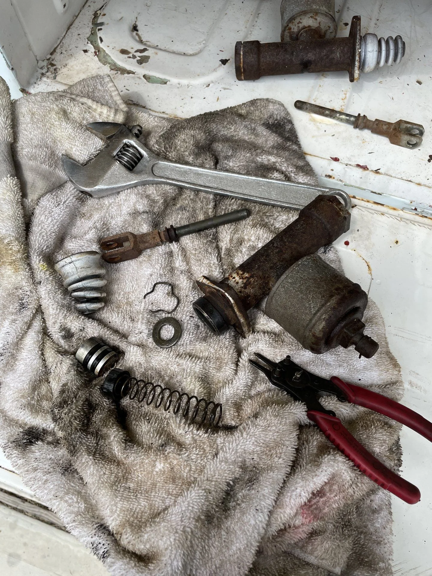

After establishing that it does indeed run, I turned my attention to marking sure it stops and shifts. I threw in a few things it’ll need in there as well to capitalize on the cash flow.

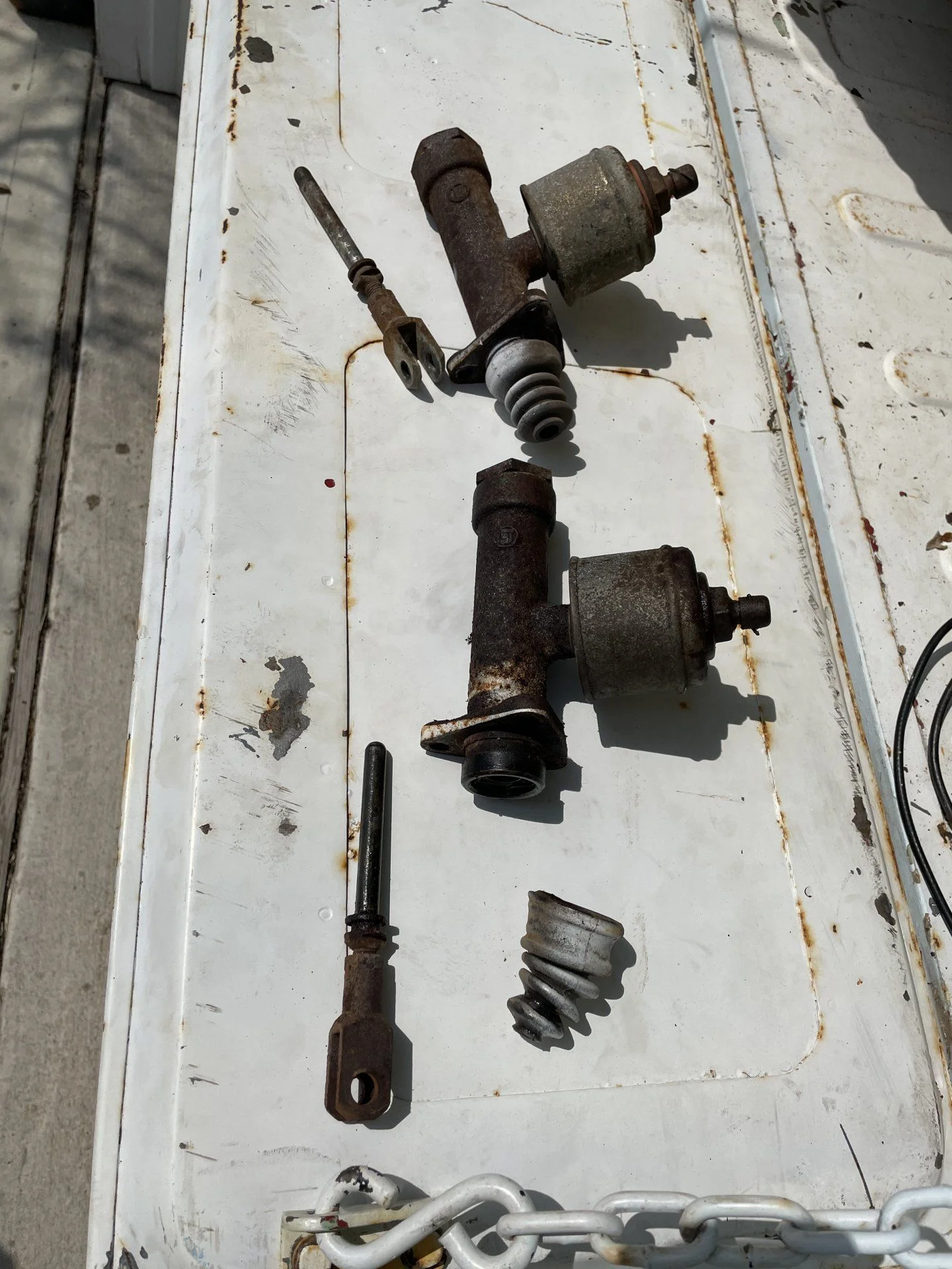

Master cylinders
Made a little progress this weekend thanks to the holiday. Rebuilt the clutch and brake masters and attempted to rebuild the slave to no avail. The piston seems to be frozen inside and I can’t seem to budge it. Any input on things to try would be much appreciated.

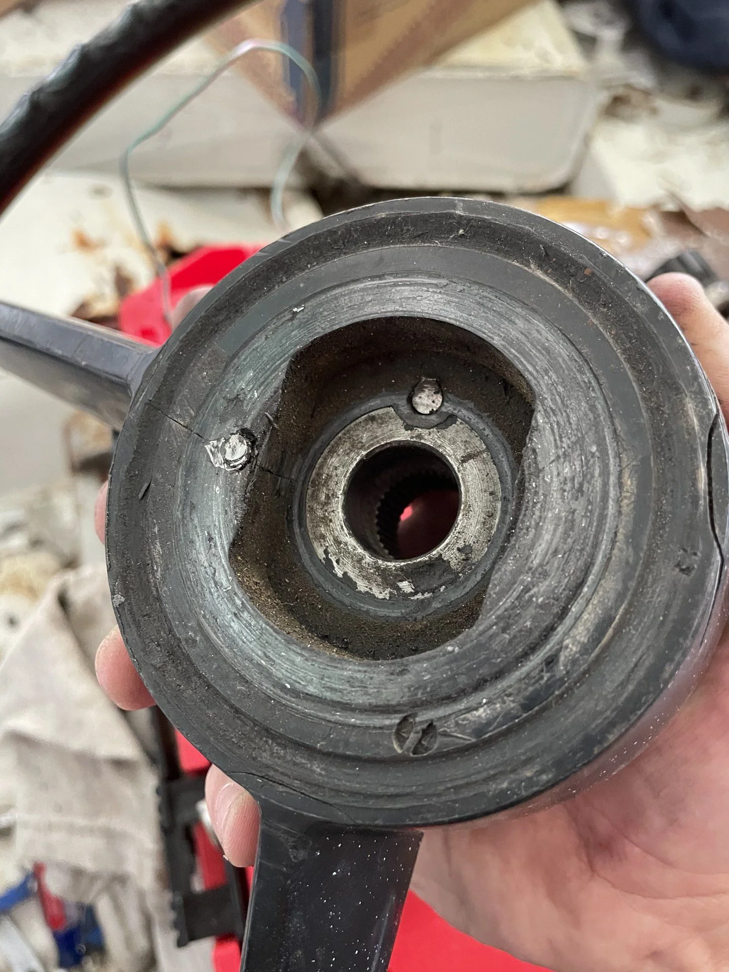

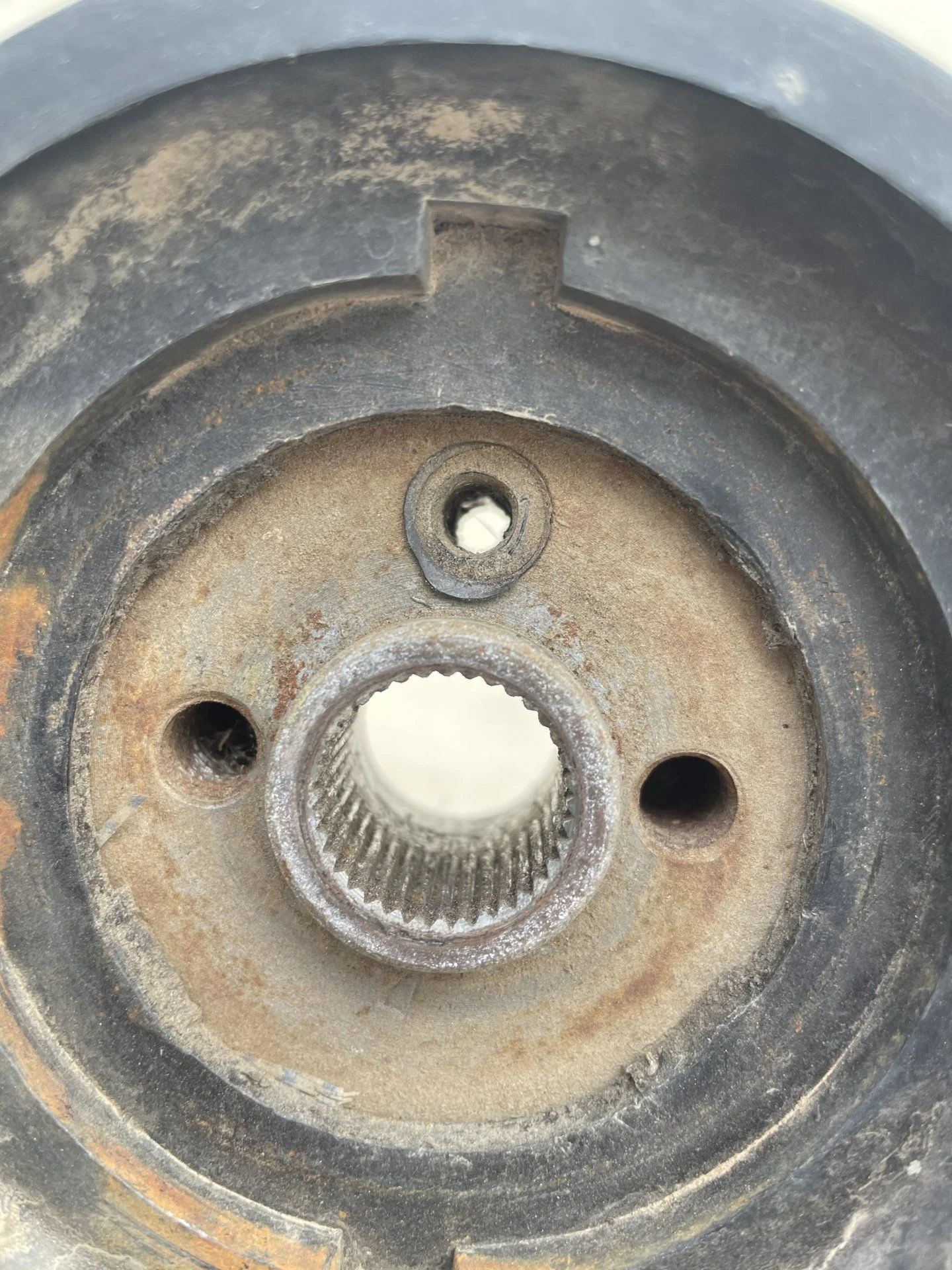

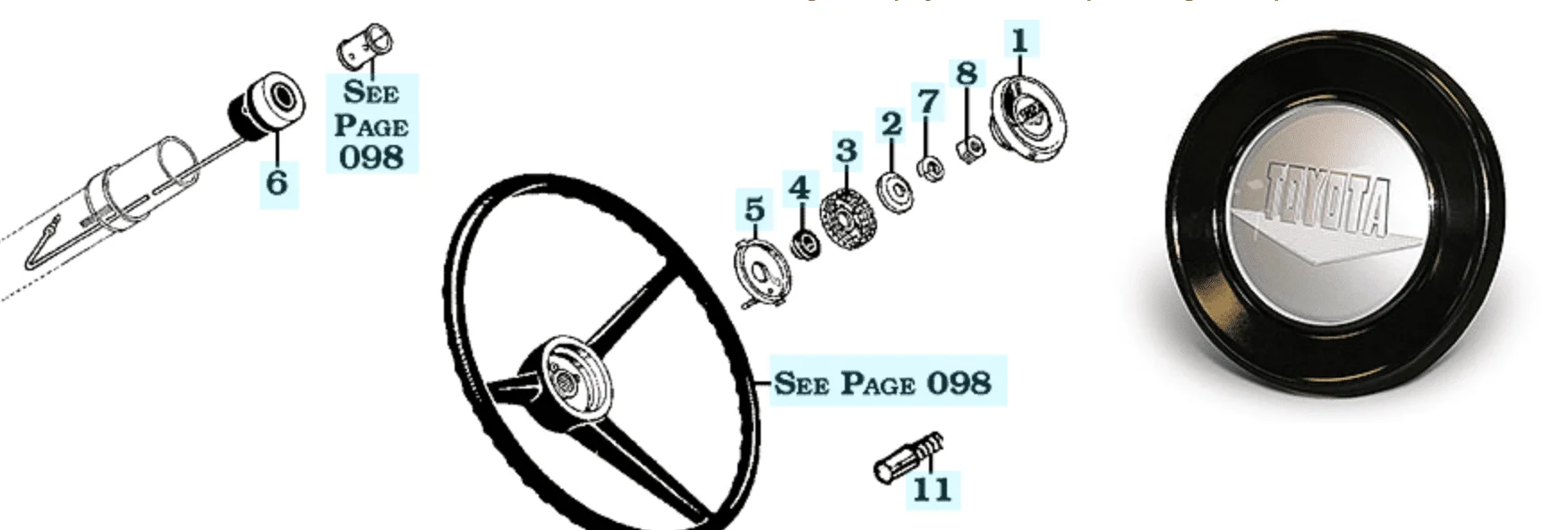

Steering wheel

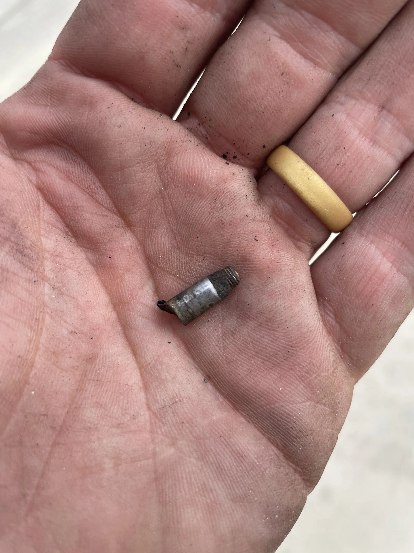

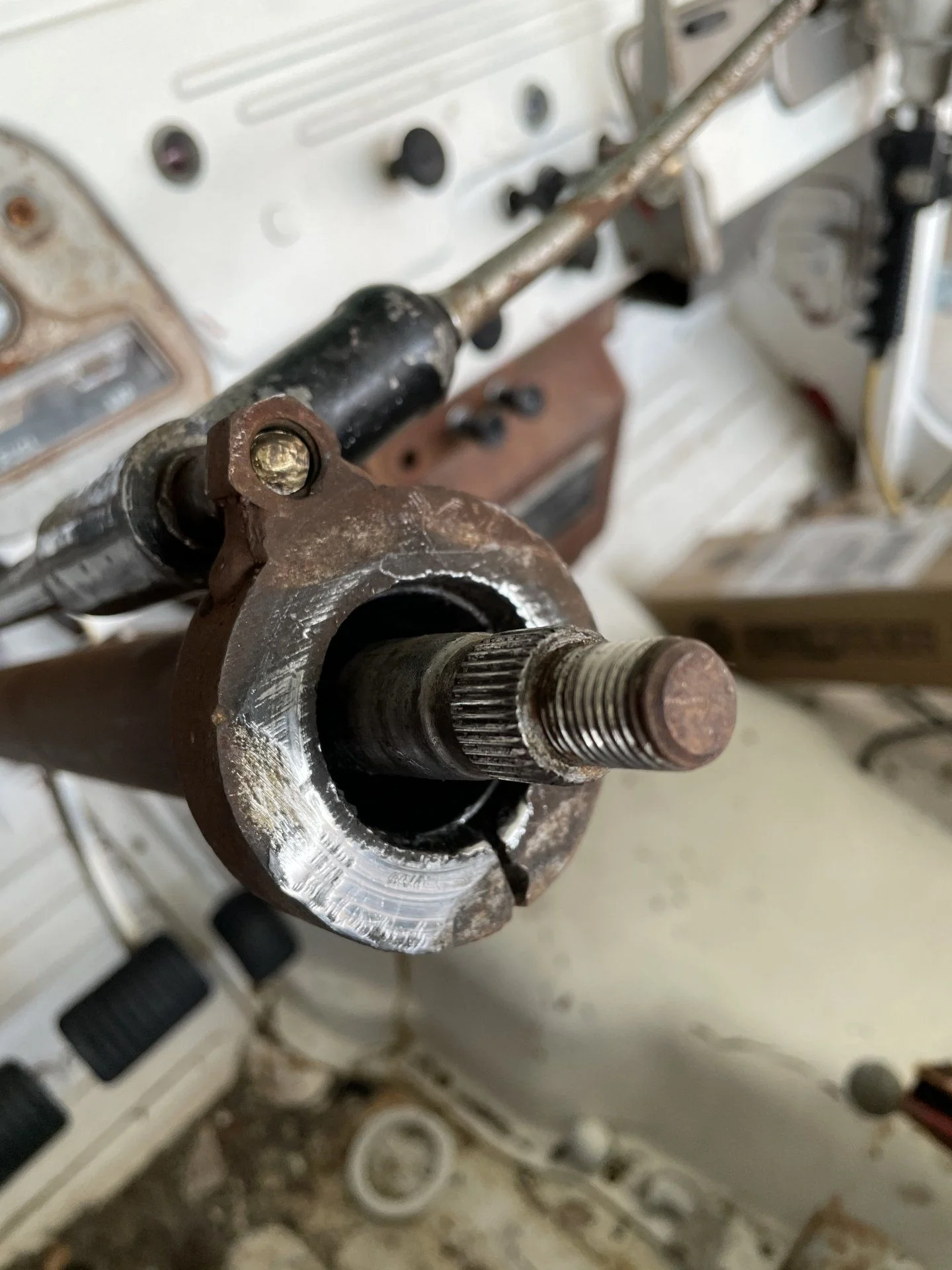

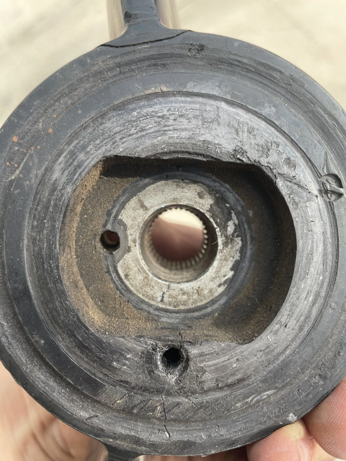

As part of that first big parts purchase I scored a new (to me) turn signal collar and switch as well as the threaded pin for the shifter from @hyhpe. Unfortunately, some asshat decided to weld on their own collar and destroy the pins on the back of the steering wheel. Sucks because the wheel is in great shape otherwise. I’m not sure if those pins are easily replaceable or if I’m screwed. Any suggestions here would also be much appreciated. Additionally I’m going to have to find a clever way to rerun the horn wire down the column.

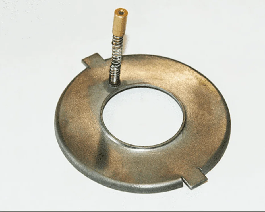

Pin in the middle should push out, its spring loaded and should be connected to the horn seat.

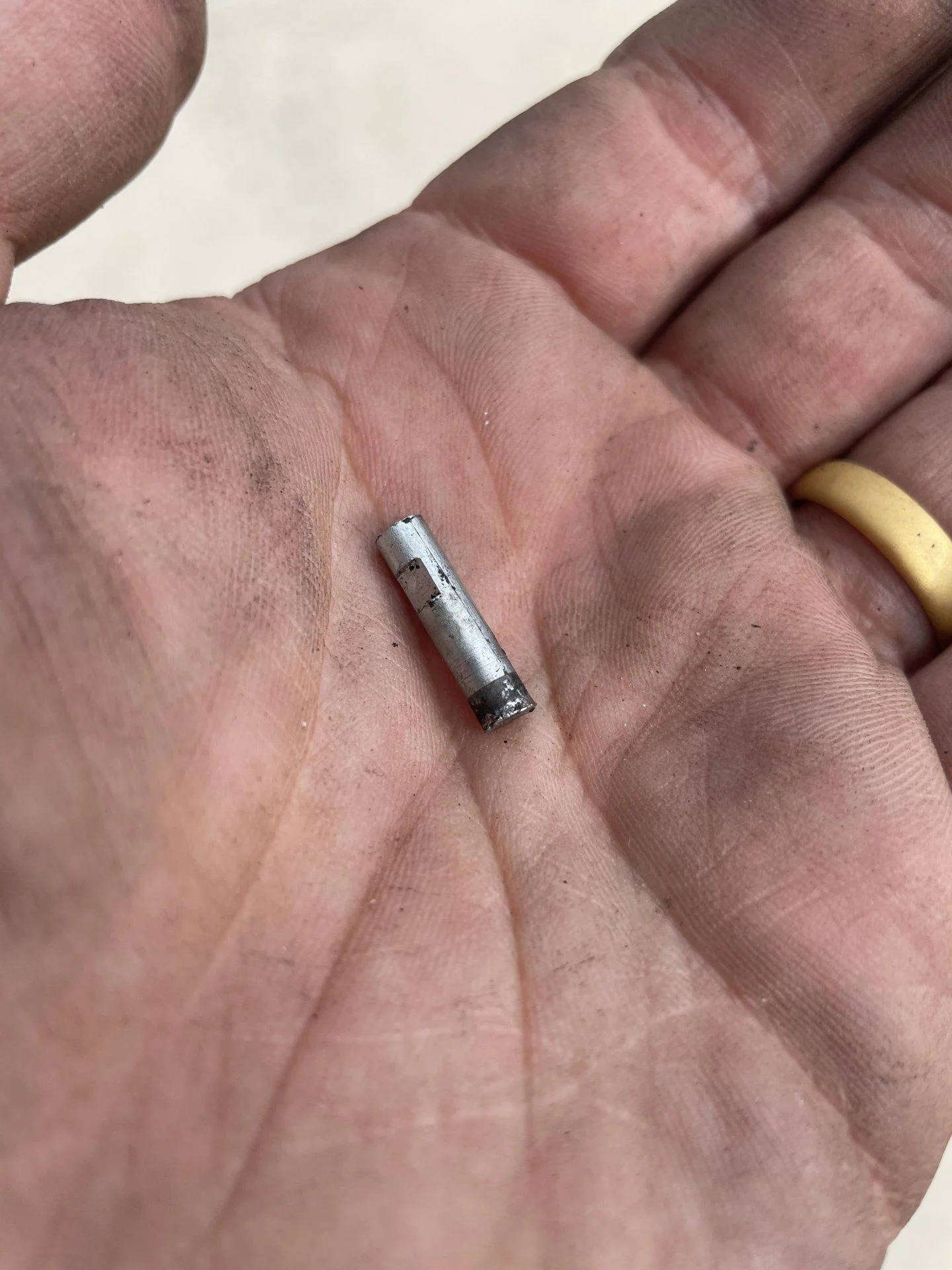

Cancel pin could be drilled out and a new pin glued or taped in.
Use baling wire or stiff electrical wire and run it up the column from the exit hole for the horn wire, then you can attach horn wire to baling wire and pull horn wire down, can also be done in reverse method, go from top and try to find wire at exit point.
Awesome. Thanks @tahoe40/45! I’ll give all of that a shot and report back.

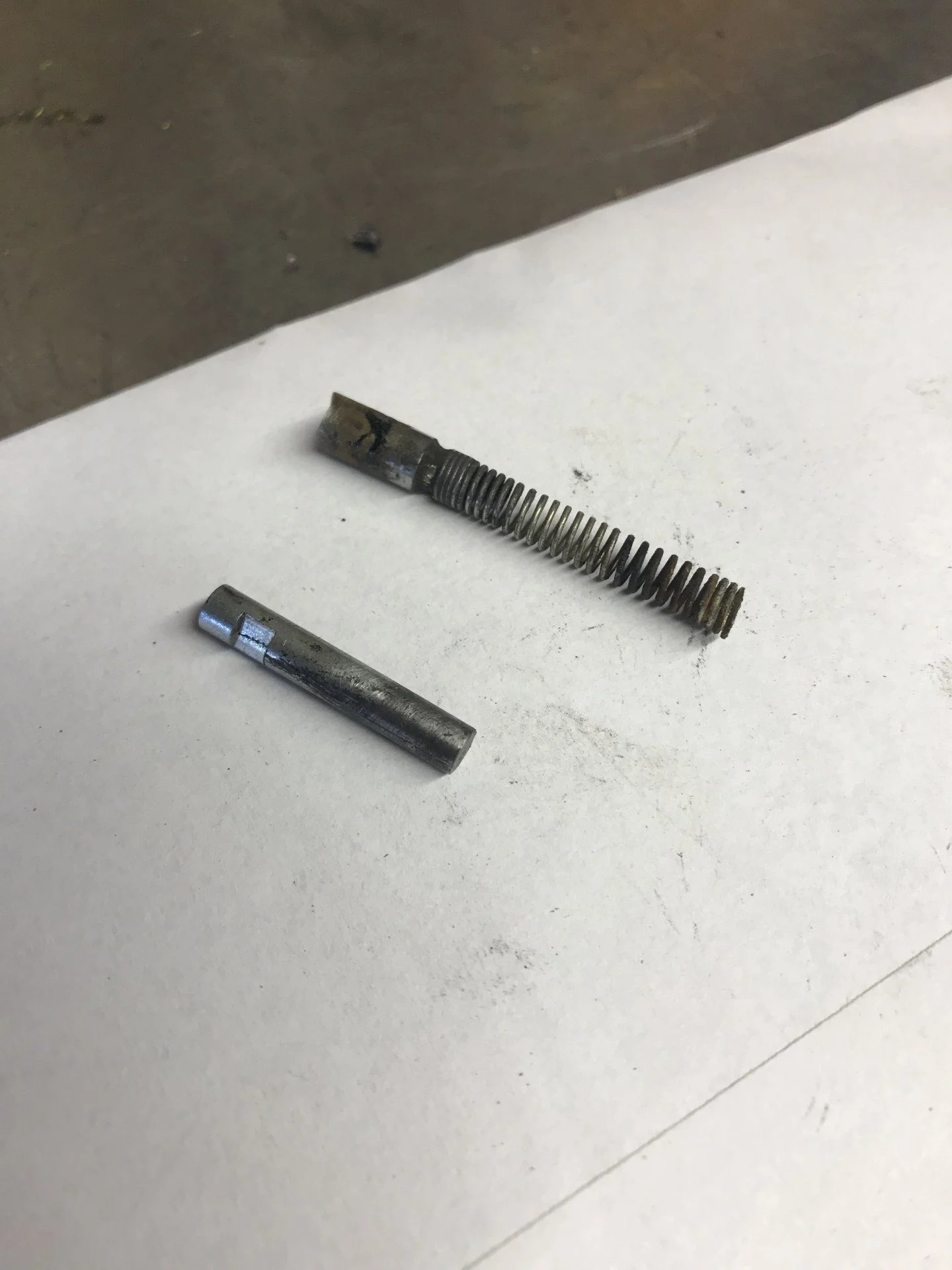

Looks like the horn seat is long gone and all that’s left is the nub of the pin.
I was also able to dig and pull of the turn signal cancel pin. I suppose I could go ahead and find a replacement pin. Would need to figure out how long it needs to be though.
Y’all are just awesome. I love this forum and this community.
Thanks @whitey45 for your generosity! I am continuously blown away by this group.
It seems I don’t have the contact seat itself still. Does anyone have any advice on a path forward other than trying to locate one?
