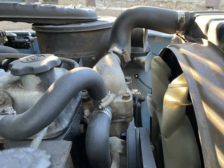

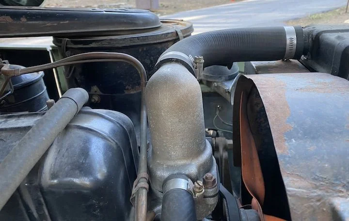

Both versions should work, the only big difference will be height of upper housing and the top hose to radiator.
Get a new water pump or yours rebuilt once you get the cooling system cleaned. Not worth hoping old water pump will work correctly.
So to clarify, the top and bottom thermostat housing will bolt up to the early (135) F motor? The only difference is the radiator hose between it and the radiator?
Look what I found today!
Here is what im talking about. Newer style top housing is shorter. Ignore the hose above the bypass hose. You will want a 58 to 67 top and bottom ( tall) or a 68 to 74 top and bottom.
View attachment 2652300View attachment 2652301
Thanks Tahoe. That makes sense. I believe I have the later radiator hoses actually. Thanks again to @Goforth.
So now I need to find the housings. I’m assuming the thermostat and associated gaskets will work with either housing, correct?
Unless of course it’s easier or cheaper to try to find an early, tall housing top.

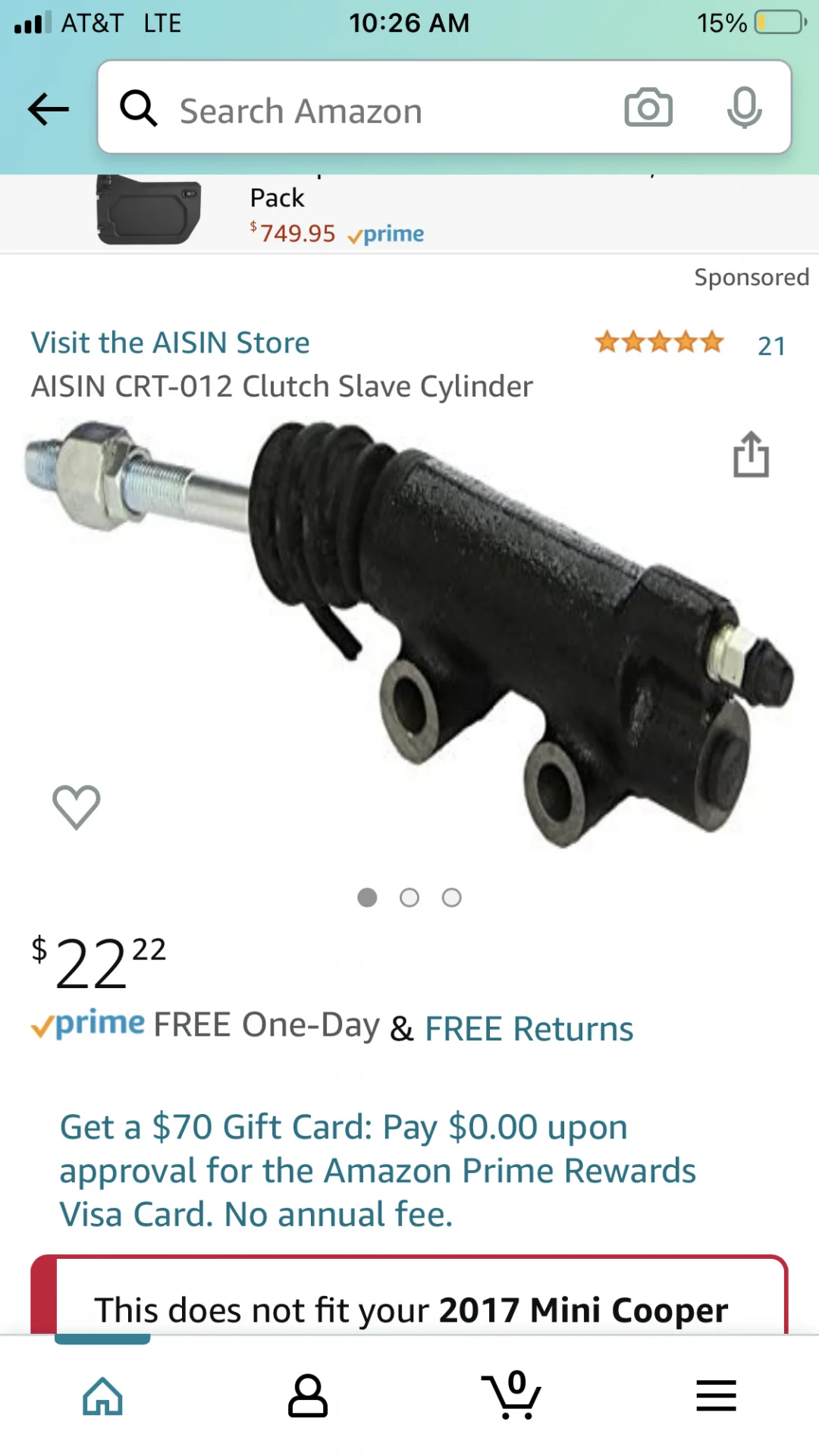

So, while I was rebuilding the clutch and brake master cylinders I decided to rebuild the clutch slave cylinder. Unfortunately, it was a no-go due to the piston being seized in the cylinder. Any suggestions on freeing that SOB?
I don’t have immediate access to shop air and I’ve already tried pushing it out with hydraulic pressure, no dice.
Not sure why I didn’t think of heat.
You aren’t wrong. If I can’t get it after another college try, I’ll buy a new one.
Have you bled your clutch after the Master Cyl. rebuild yet? If not, don't throw away any of the parts until you're sure it's working properly. When I did my '66, I had a helluva time getting the pedal to come back up. Turns out that the spring behind the piston, while appearing correct, didn't have the correct spring rate. I reinstalled the original spring and everything was copacetic.
