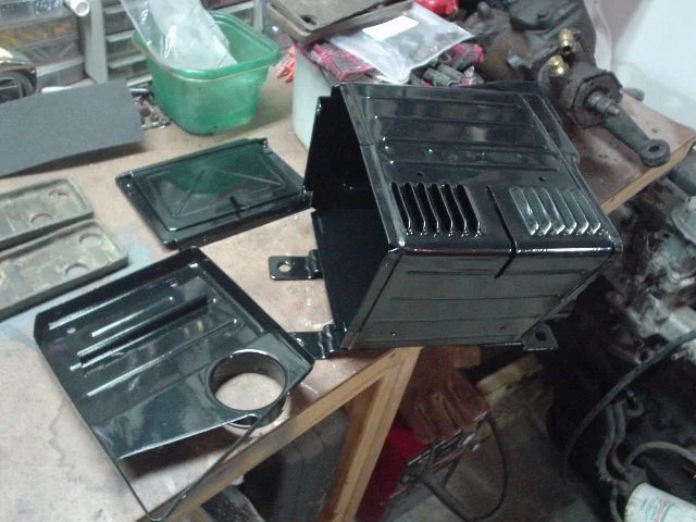

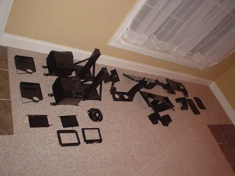

I media blasted all the parts in my cabinet using 80 grit aluminum oxide and the came clean fast. I then boxed the heater up and brought it, (along with a second heater and some other parts) to sk8salamon in Chattanooga who works at a louver design plant where they also do some powder coating. He got all the stuff powder coated for me for a song and trade for some blasting here is how that came out:
Here is one of the heaters:

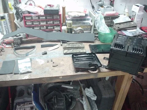

Next was to start assembly using the kit. I laid all the parts out on my over crouded work bench and was happy to find that all the screws were eactly as advertised:

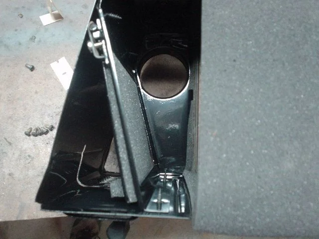

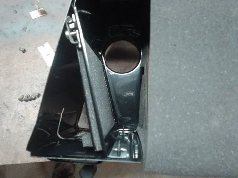

Here is another pic of the box itself. I reccomend puting down a clean soft clothe on you work surface when working with your new powder coated parts :crybaby: (actually the damage was minimal)

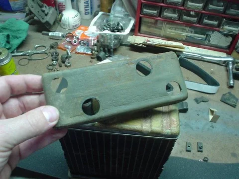

Now since the OEM padding was still very soft and pliable, I decided to keep it in the box and I placed it back on the ends of the heater core.
I noticed when I took the heater apart that the soft foam had som charcoal foam pading on is still so I figured that this set up would work fine.

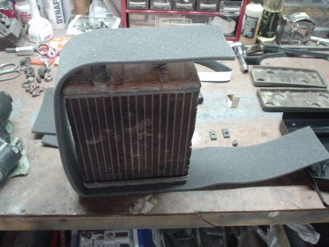

Next I wrapped the core with the foam supplied in the kit and cut it to length and sliced some holes in it for the inlet and outlet tubes:
Notice the foam was not on the core yet. It did go on, however.

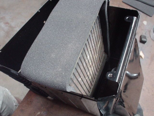

Next I slid the heater core with the foam on it in place. It was a tight fit;p

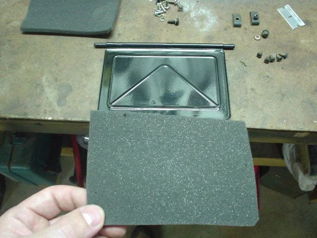

Next I glued the dor pad to the door using 3M 77 spray adhesive.

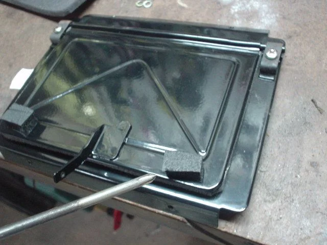

And I stuck the small pads on the other side of the door (these prevent rattling when the door is open) and screwed the door to the frame.

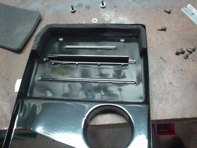

Next I put the door and frame inside the box and screwed them in place (always using Shane's new screws).

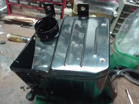

I put the control knob on and it was ready for install into the truck:
Cut the holes for the lines and spray 3M contact on bith the foam strip and the 4 sides of the core. Once tacky assembly takes place. Trim the edges of the fin sides flush and then slide into the box. Don't force it as it will slowly glide in.
