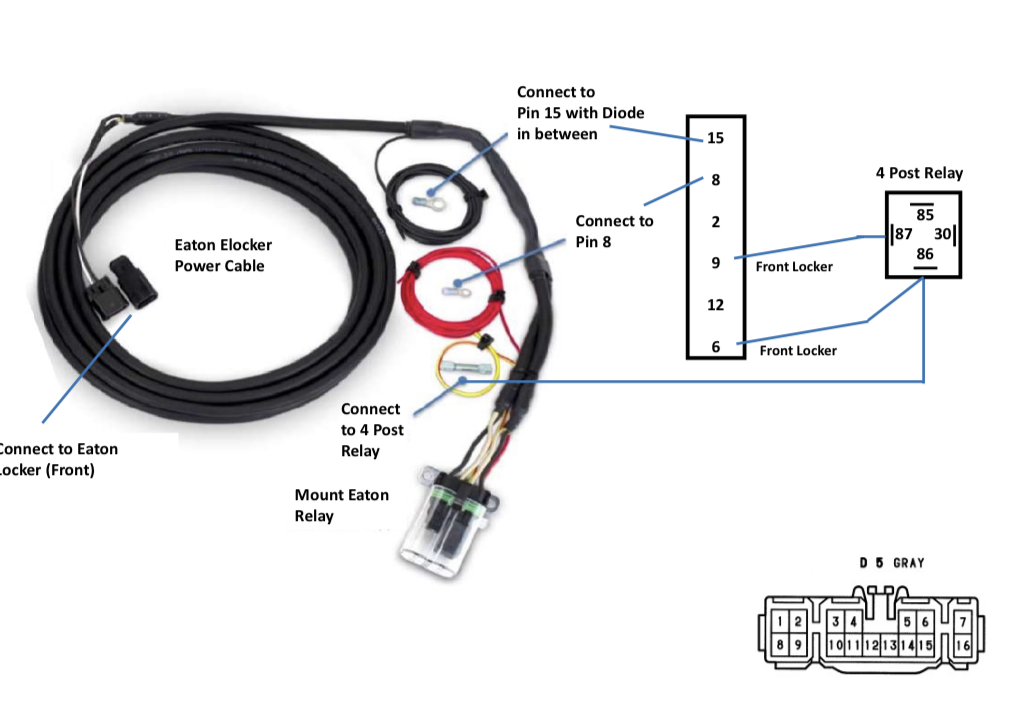

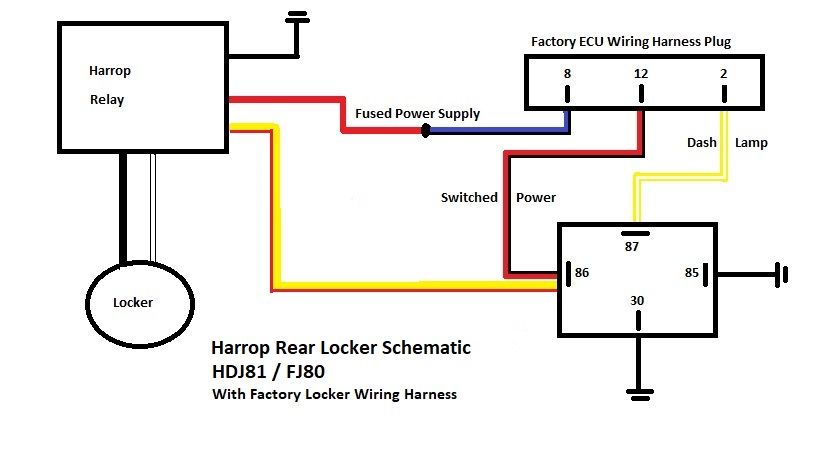

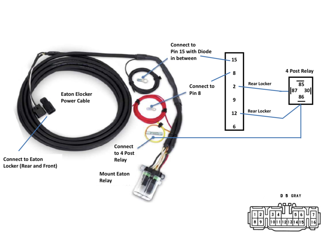

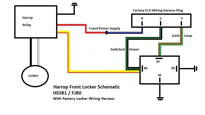

Last but not least I made up these wiring schematics using the actual wire colours
REAR:
FRONT:
Hi, I've tried to get this going but I don't have the wiring diagram for the harrop relay. Do you have a detailed diagram of what wires go where on the harrop relay for the rear locker? I've found all the other wires but can't get the switch to work as I'm missing that key part. Thanks heaps
This is what I understand for the Eaton wiring. But you specifically mention Harrop which may be different wiring if yours is truly a Harrop (older). Harness for front and rear are the same.
I believe you just mount that…no connections made at that end.

So after 5 pages of utter confusion, it appears that no 5 pin harness is needed just the Eaton harness, the factory magic button and lockers. Is that the conclusion I should come to? Zuk just build my rear 3rd. Getting ready to send him my front. Both have Eaton’s.
