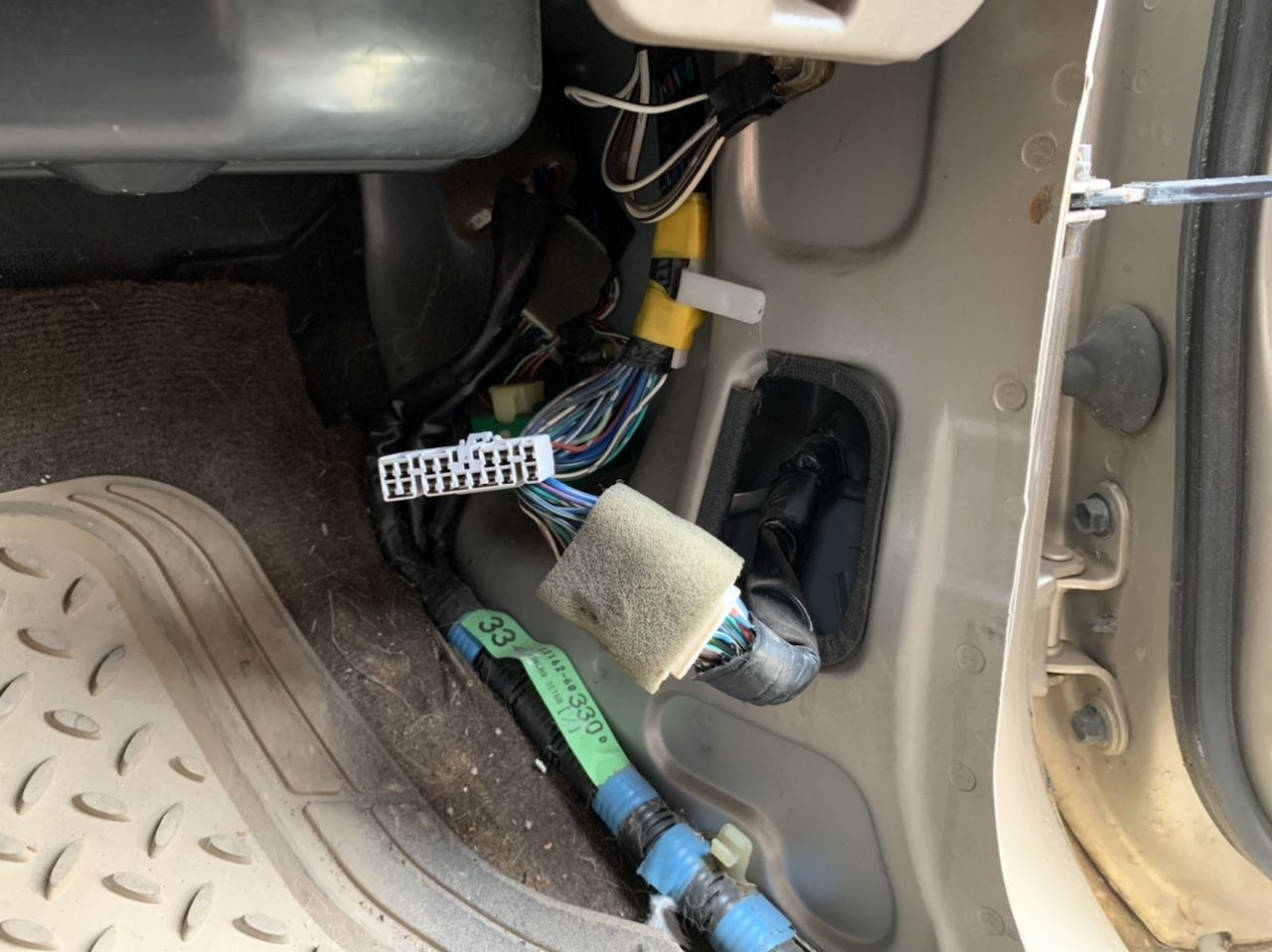

It's in the kick panel on the passenger side, in the cabin. I just did this on my '97 LX a week ago.
Would you look at that....PASSENGER side. And OP says so plain and clear in his first post.
I’m glad that I could add to the body of knowledge here at least that there is no locker ECU pigtail on the DRIVER side:bang:
There ya go! It's kind of a pain to get the female pins out, but plug those OEM repair wires in first into the plug to make sure you have the correct wires prior to pulling them out of the plug. My wire colors/numbers didn't match up quite exactly as the OP posted. Then I fit the female into the male end and soldered them together and finished it off with shrink wrap over the completed joint.
