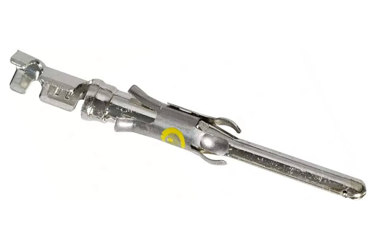

I’m trying to get my lockers to work with the factory switch. According to the Toyota wiring handbook all the pins in the 16 pin connector are female. If I’m going to plug into the either after depinning or going into the connector, I need the male pins.
The repair wire includes the male pin already crimped

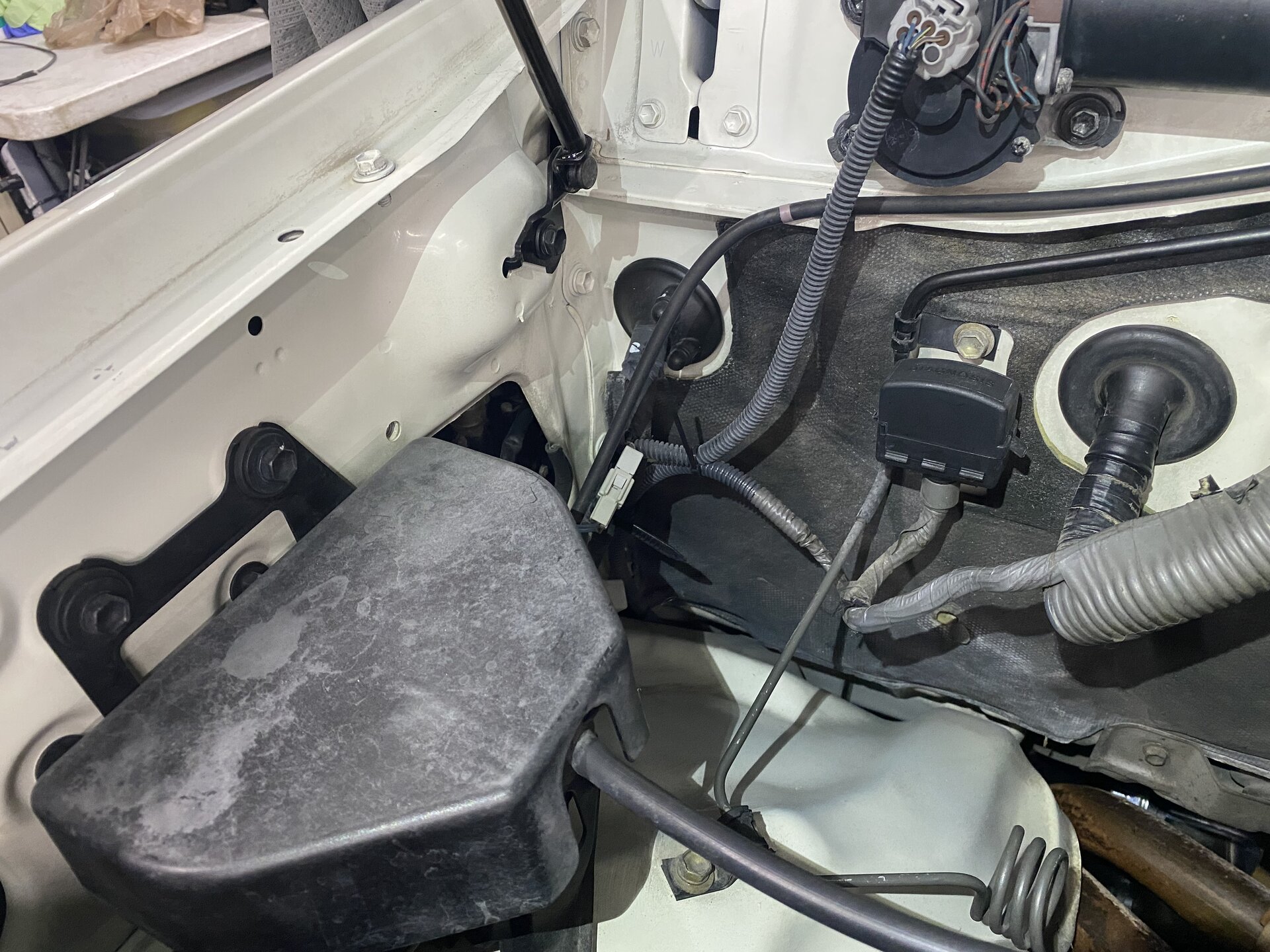

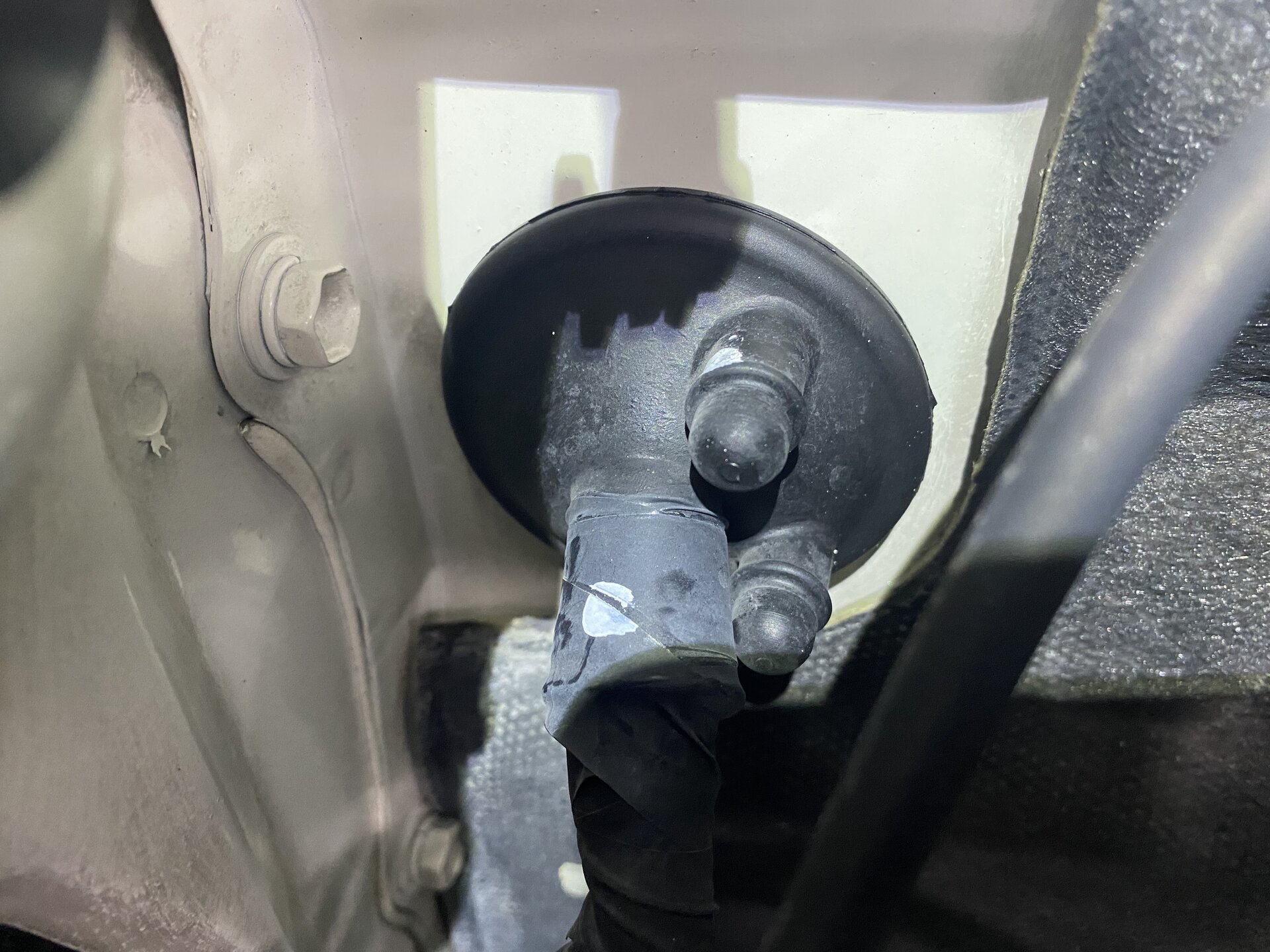

Does someone have pictures how the factory Eaton harness is routed into your cabin? Are you bringing it in through the firewall grommet or some other spot?
There is a big grommet on the pass side with two “nipples”, cut them with some scissors at the little groove. Fits the eaton wires perfectly

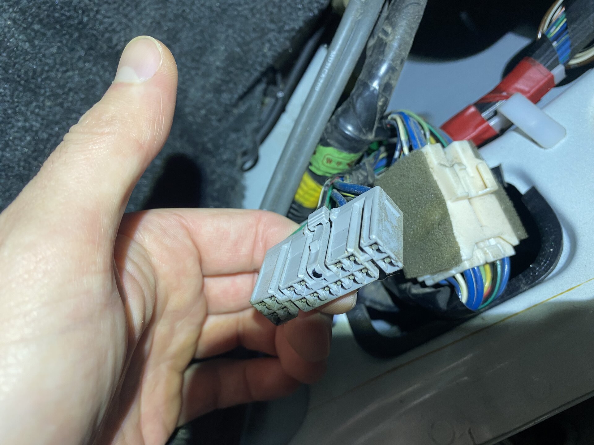

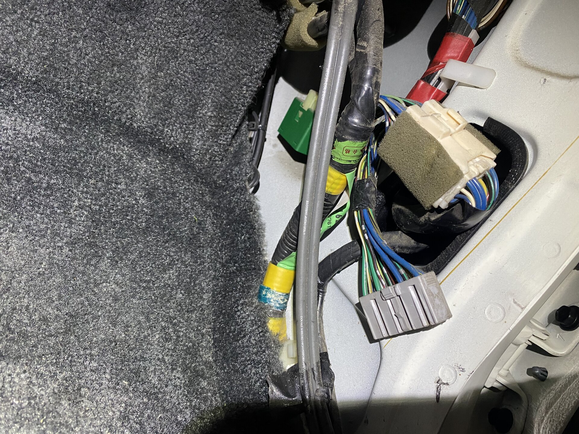

Also does anyone have any additional pics of everything mounted for both lockers? I know the thread starter only installed a rear locker. Was curious of placement of all 4 relays etc when doing F&R lockers. And how tricky is it to de-pin that grey OEM plug? Any special tools needed?

Be sure to pry up the retainer and then push the pin retainer tab down. It's a bit finicky, if you are pushing/pulling anything super hard you're doing it wrong. Hardest part is working in that little area.
Give yourself more wire than you need.
